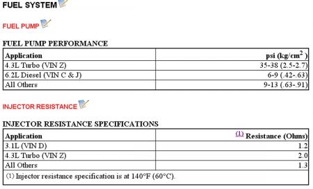

What should the fuel pump pressure be on a 1991 chevy blazer 4.3 engin 4 wheele drive
