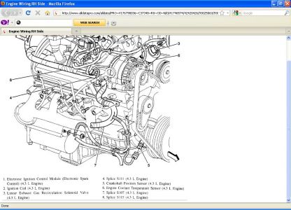

Engine Cooling problem
1996 Chevy Blazer 6 cyl Four Wheel Drive Automatic
where is the engine coolent temperture sensor located on a 1996 Chevy Blazer
