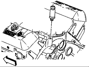

Thank you for your last help now I need to know where is the fuel pump pressure switch is located at because it's still actting up if the fuel pump gose's out dose it stop all at once im disabled an this is the only way I can find some help is there a place I can if it is fuel pump to get a cheap one

The pressure switch for the fuel pump is the oil pressure switch, it's at the back of the engine on top. If your fuel pump goes out your car will just quit like an electrical problem.
