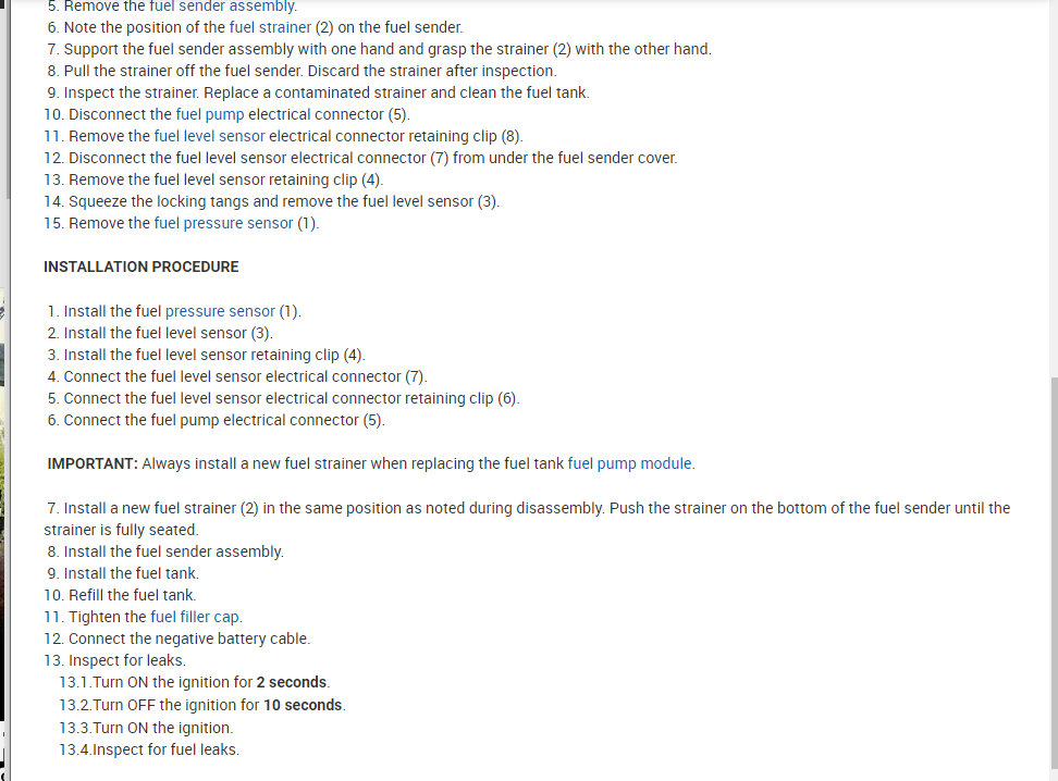

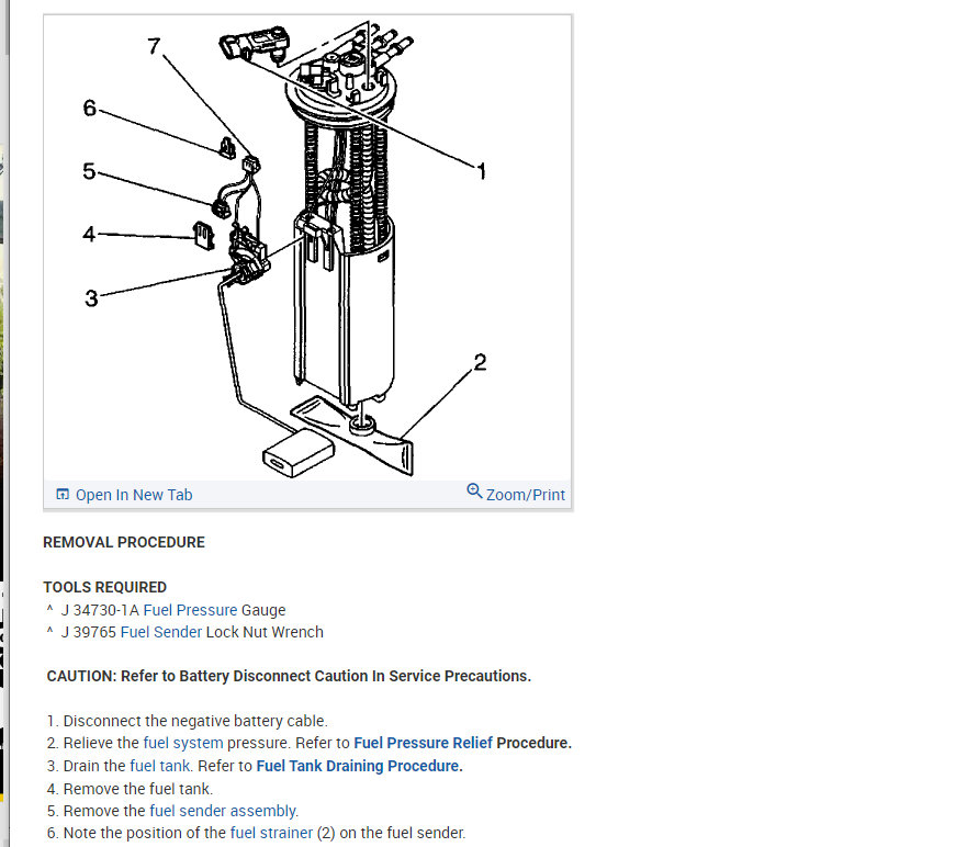

Where is the fuel pump located
Saturday, May 30th, 2009 AT 10:05 PM
MECHANIC
18,907 POSTS
The pump is located in the tank and here is a guide that will help with replacing the pump:
https://www.2carpros.com/articles/how-to-replace-an-electric-fuel-pump
https://www.youtube.com/watch?v=Lhd0vd8pdBU
Below you will find the process from the manual on how to perform this. Please let us know if you have other questions. Thanks
