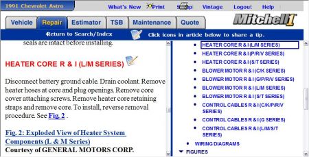

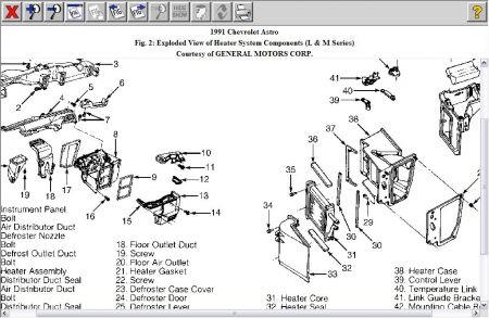

How do I replace my heater core in a 1991 chevy astro with air. 4.3 engine, 320,000 mi.
Sunday, November 4th, 2007 AT 12:28 PM
MECHANIC
75,992 POSTS
Astro van L/M series
-2
Sunday, November 4th, 2007 AT 3:14 PM
