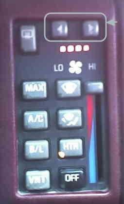

I have the car listed above 3.1 with a heater/AC problem. Fans work great, the hot/cold lever seems to change the blowing air from cool to warm, and the air output is split between the defrost and floorboard. It doesn't matter which switch I depress (AC, defrost, vent, floor, etc), the air flow doesn't change. Seemingly half through the floorboard and half through the defrost ducts. Even the fans speeds work fine. A couple of knowledgeable guys have told me they think the problem is in the 'blend back door actuator' but I haven't been able to find any instructions anywhere on how best to change this component and I had to wonder too, if there isn't some way to just run the AC compressor directly to the battery through a fused switch versus tearing into my dash when I'm not entirely sure what I'm looking for. Anyone have any experience changing one of these components?

The AC programer controls that door. Remove the glove box liner you will see the linkage hooked to a arm that is the programer.

After reading through your question again. Your problem is a vacuum leak somewhere usually under the hood. You will need to check for any cracked vacuum hoses or leaks. I used to use a can of brake cleaner to spray on the vacuum hoses down. When you spray on the leaking hose or component the engine idle will pick up RPM's. Then you will and just need to repair the leak and the AC will come out the vents properly.

Thanks, I'll check for a vacuum leak today. I haven't checked to see if pressing the AC switch actually turns on the AC compressor when the engine is running and am guessing that if it were a vacuum leak, that wouldn't stop the compressor from running when the AC button is pressed. Thoughts on that?
