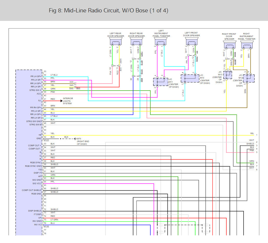

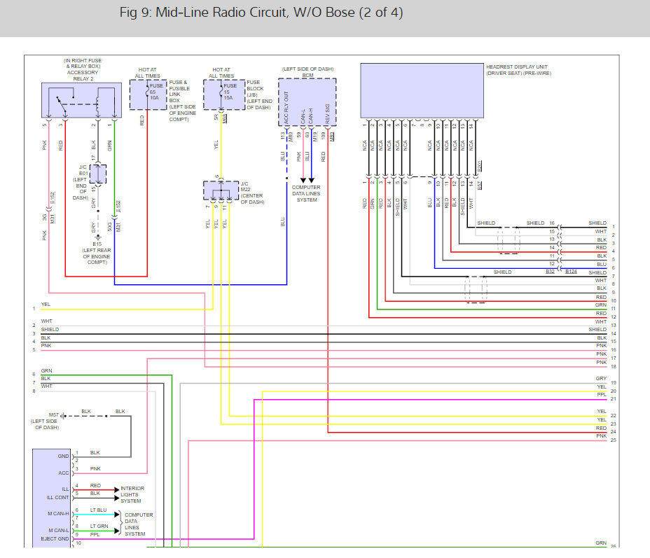

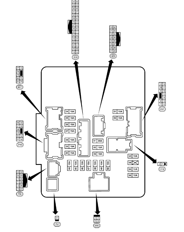

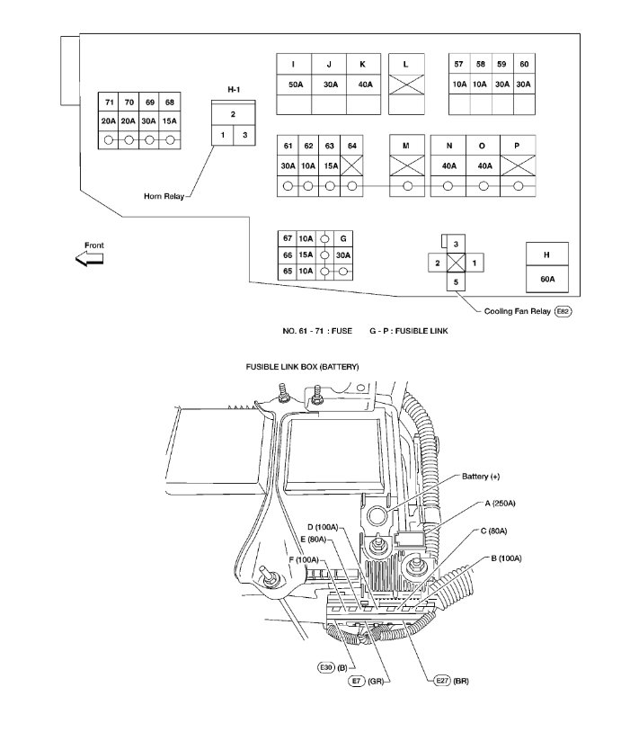

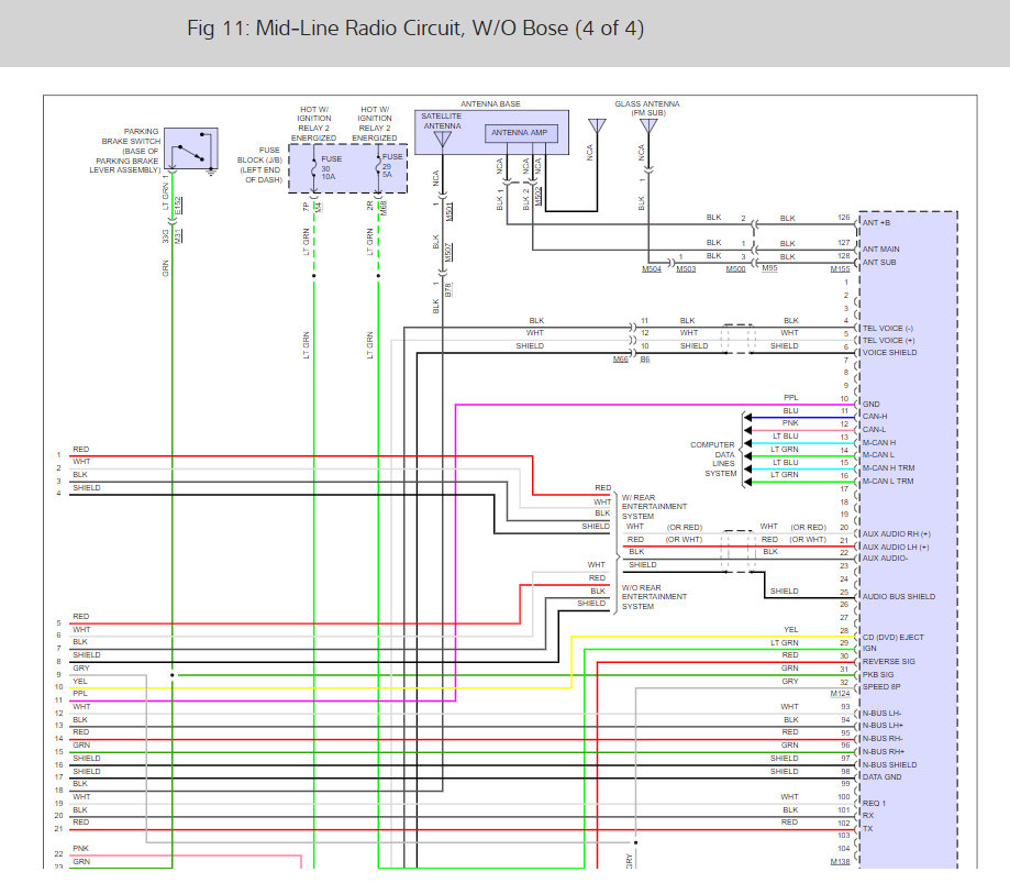

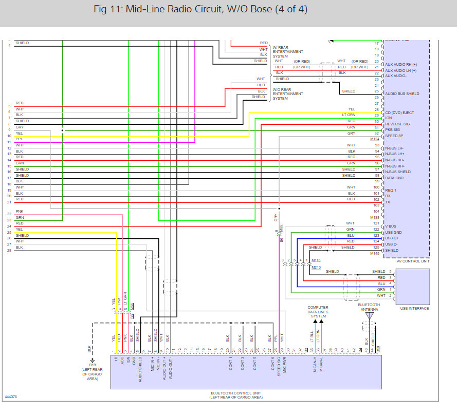

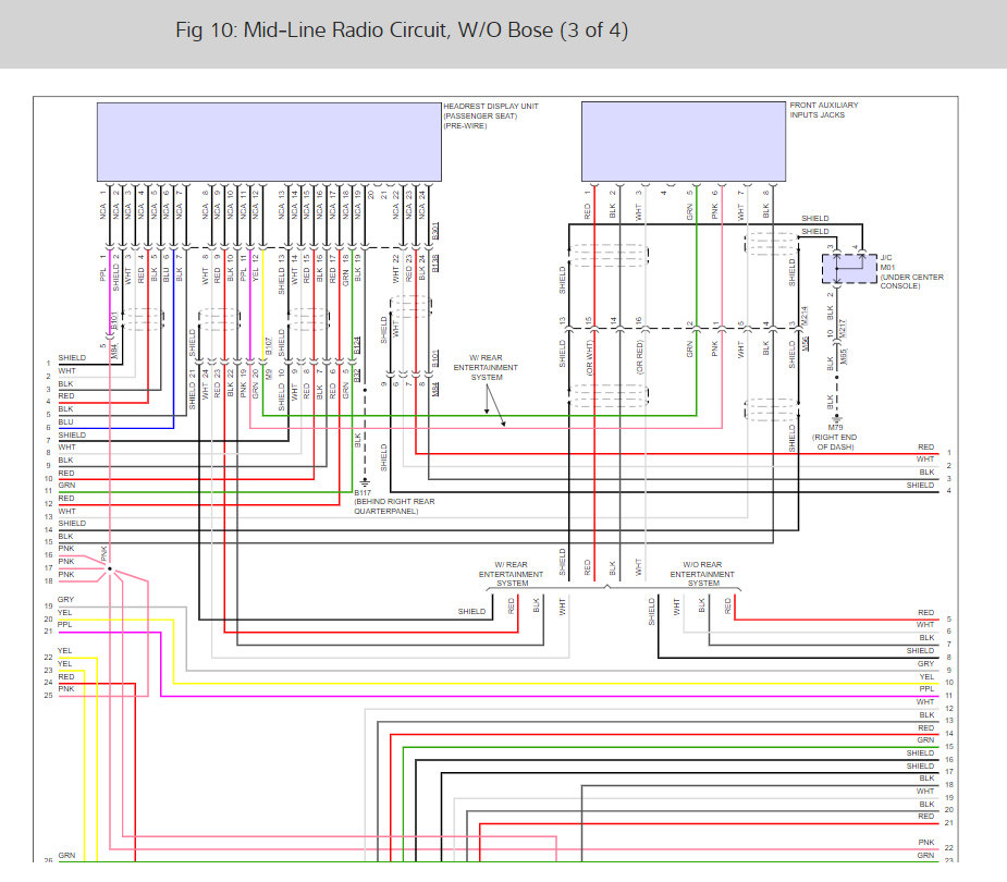

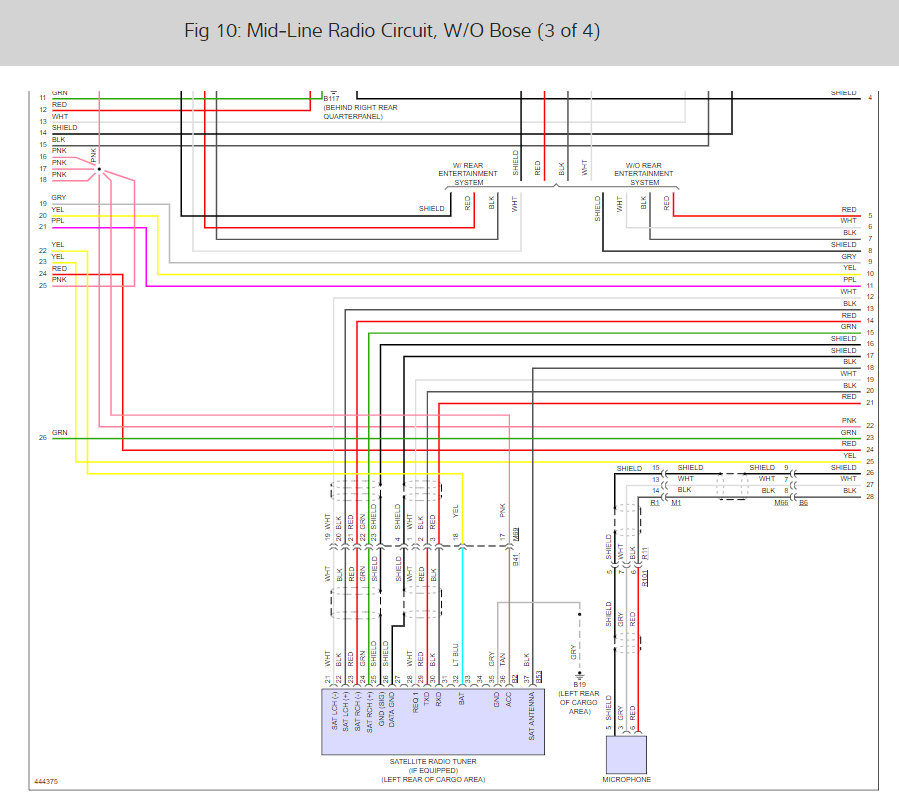

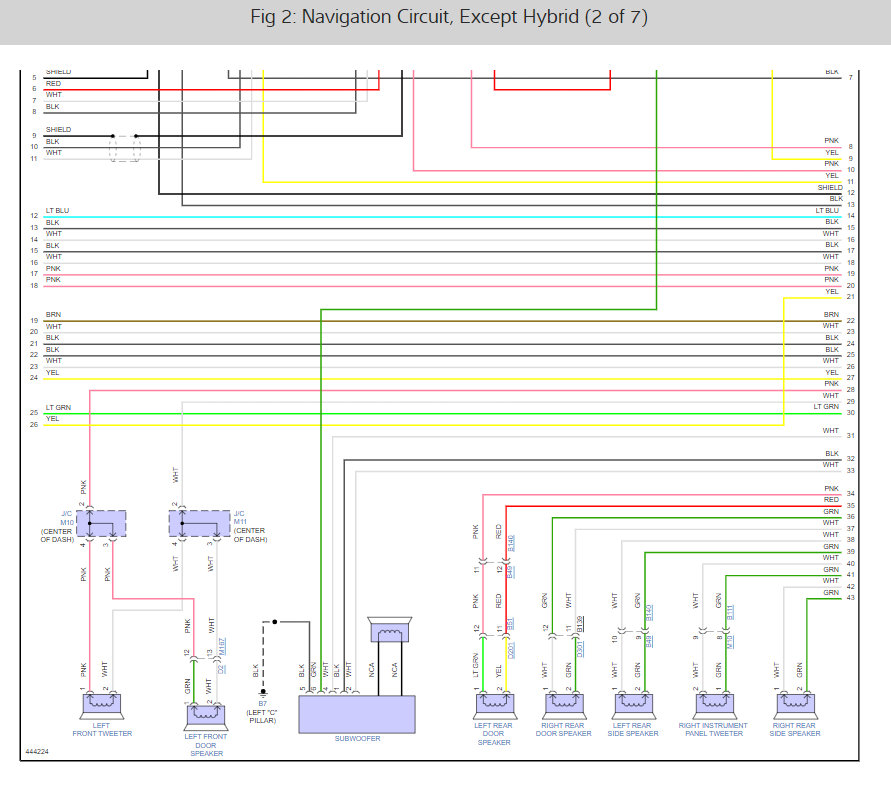

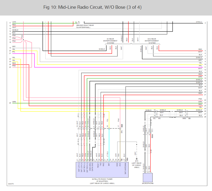

It sounds like you have a problem with the CAN (computer area network) which needs to be scanned. here is a video of the job being done. It also can be one of four fuses can be out (15, 65, 30 and 29) in the interior fuse panel. Can I ask if the steering wheel controls do anything?
CAN scan video:
https://youtu.be/InIlnsjOVFA

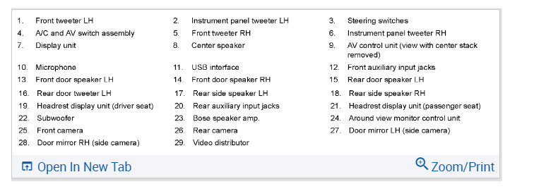

Here is a guide to help us check for power at the fuses and the fuse locations as well. Also, I have included the radio and media display wiring diagrams so you can see how the system works.
This guide will walk you through the steps the diagrams for your car are below:

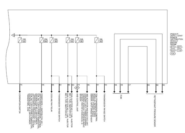

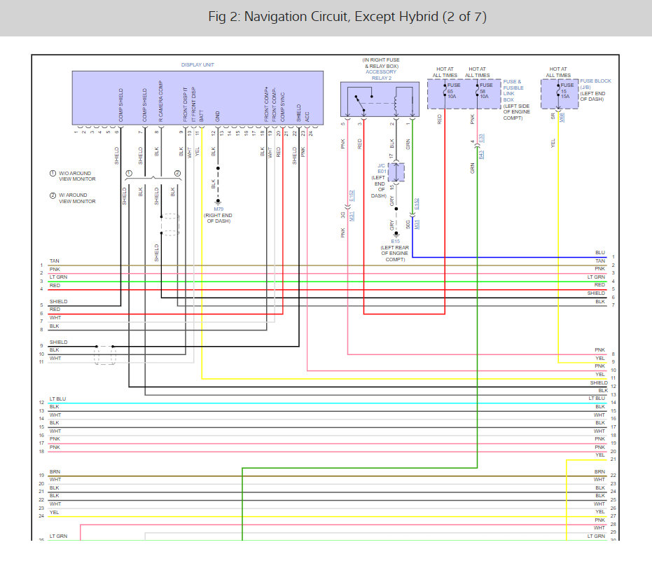

If the power and grounds are all okay it sounds like the display itself has gone bad. I would try to find a used one to save some money. Here are diagrams below to help get the problem fixed. Check out the diagrams (below). Please let us know what you find. We are interested to see what it is.

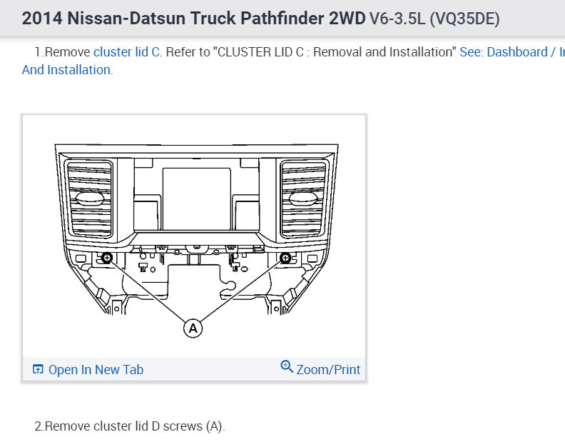

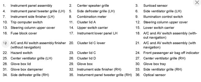

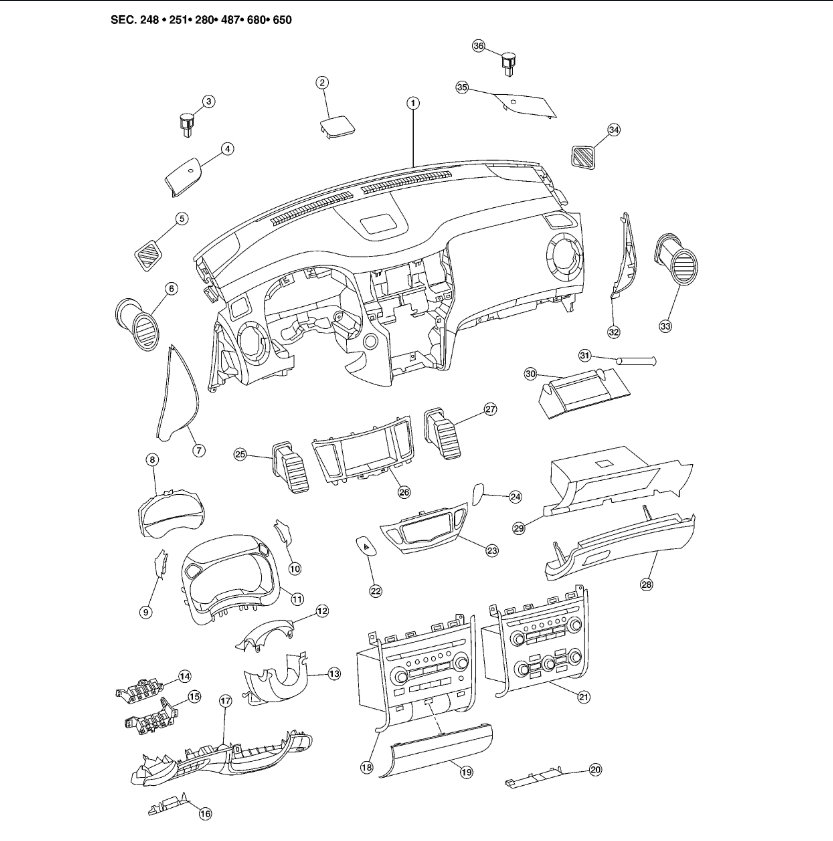

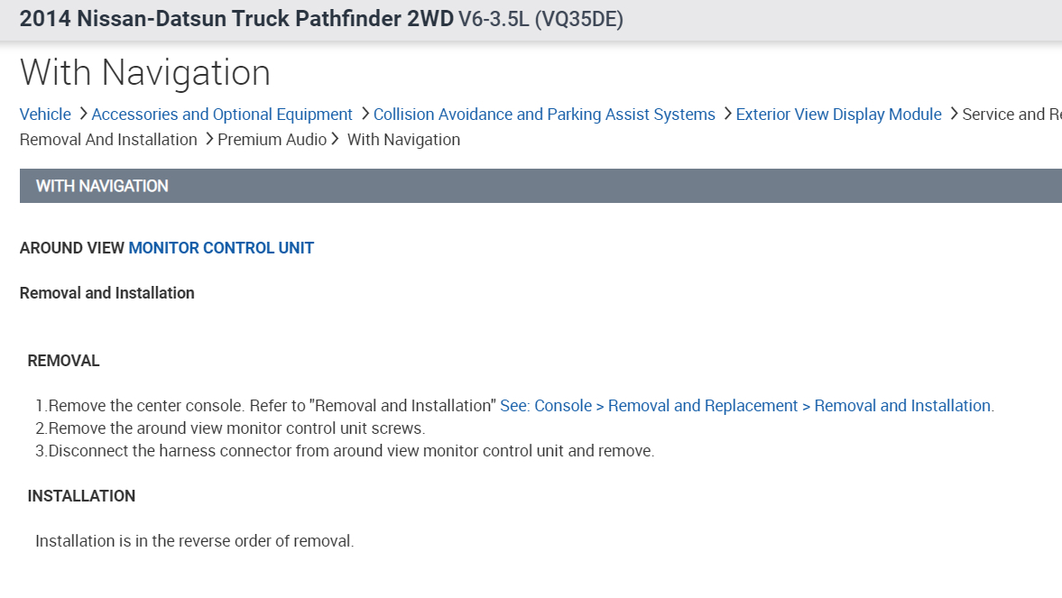

A/C AND AV SWITCH ASSEMBLY
Removal and Installation
REMOVAL
1. Remove cluster lid C lower. Refer to "CLUSTER LID C LOWER : Removal and Installation" See: Dashboard / Instrument Panel > Removal and Replacement > Removal And Installation.
2. Remove the A/C and AV switch assembly lower screws.
3. Release upper pawls and remove A/C and AV switch assembly.
INSTALLATION
Installation is in the reverse order of removal.

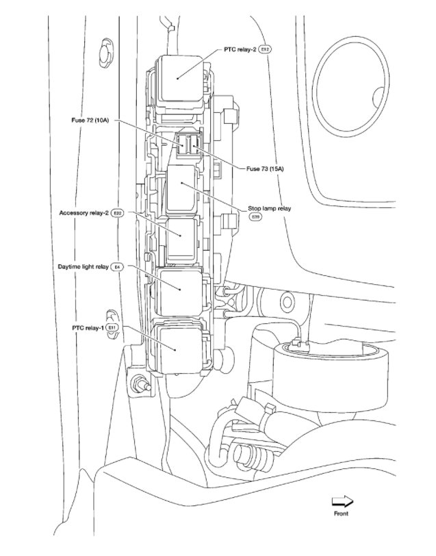

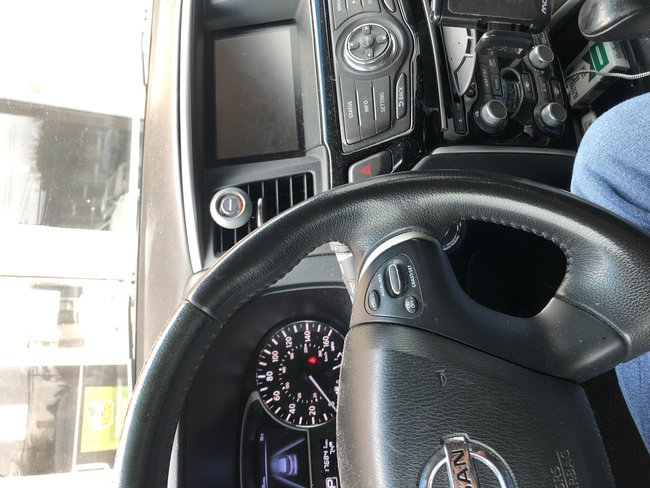

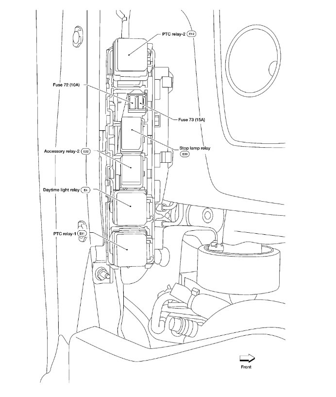

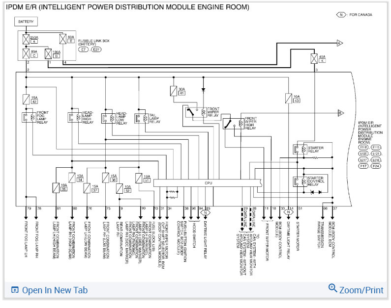

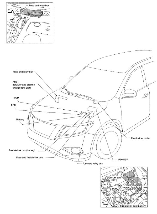

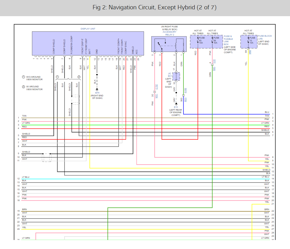

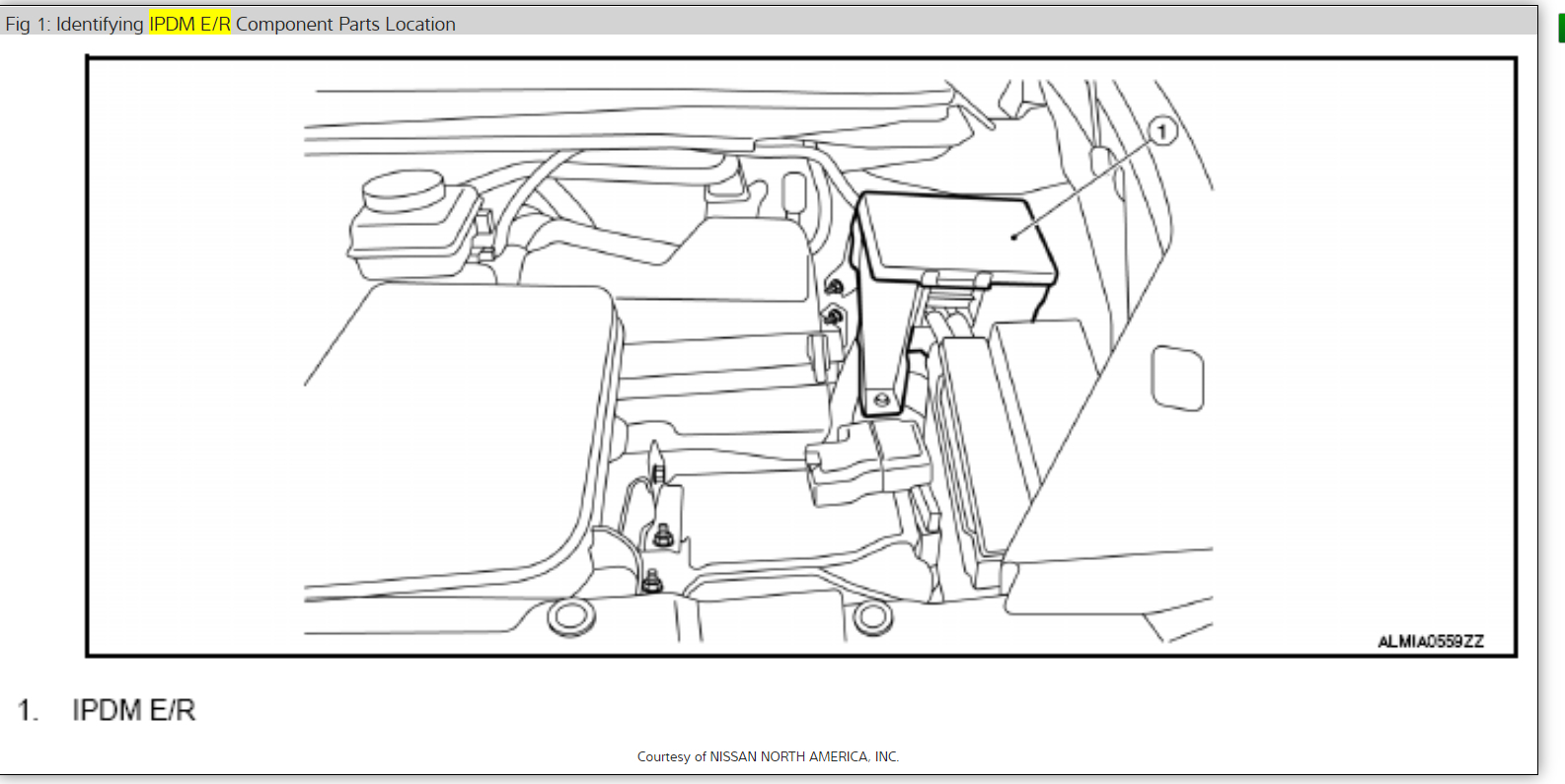

I have a similar problem with my 2014 Nissan Pathfinder. Whenever I start my car, the display would sometimes turn on or not. When it turns on it stays on. When it doesn’t turn on it stays off and I would have to turn off my engine and restart to see if it would turn on. Basically whenever I turn on my engine, it’s a hit or miss on whether my display would turn on. This is really annoying because if I turn on my ac and leave it on when I turn off my engine. Then next time I turn on my engine and if the display doesn’t turn on, my ac is stuck as on and I have no controls for radio, display, ac, ext.
When the display is on it works fine.
Any help is appreciated.
I attached a photo showing my engine is running but display didn’t turn on.
It seems like it’s very randomly whether my display would turn on or not whenever I start my engine.
+2
Thursday, March 17th, 2022 AT 12:59 PM
KEN L
  • MASTER CERTIFIED MECHANIC
  • 55,535 POSTS

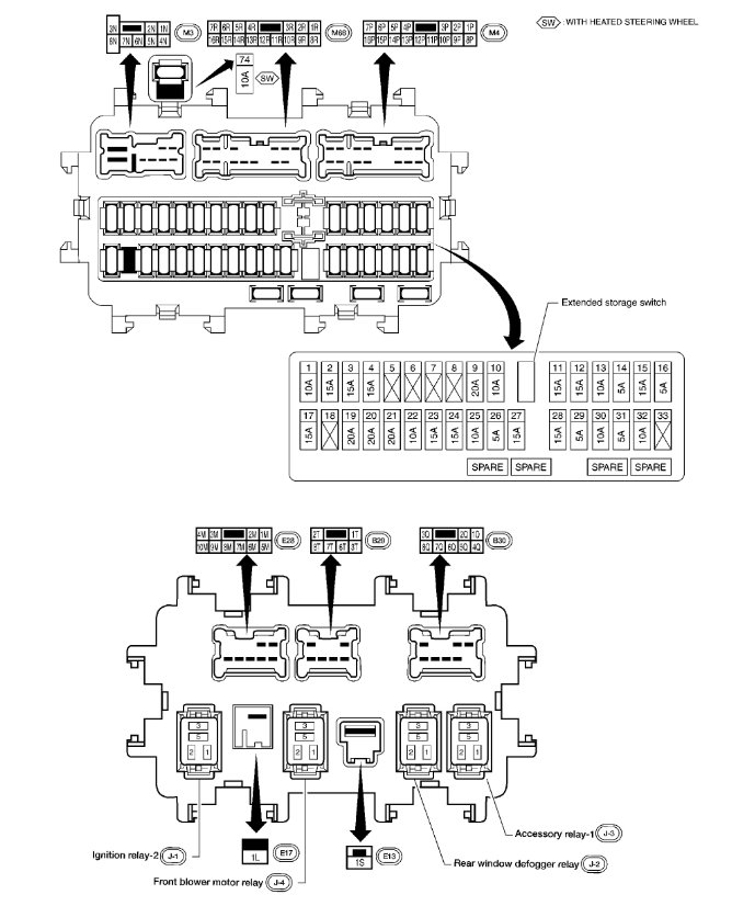

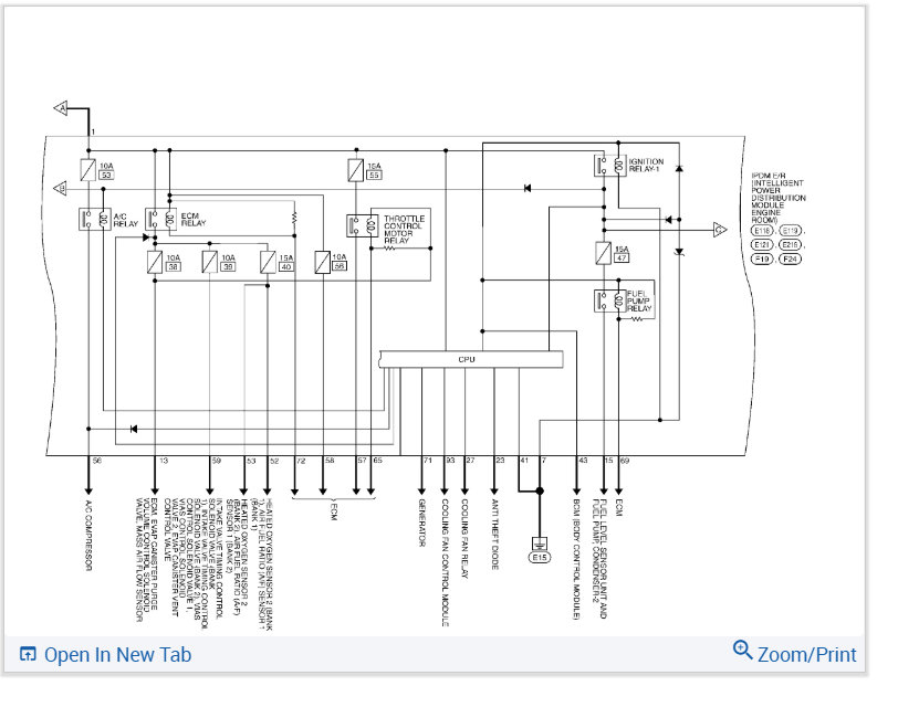

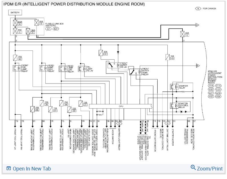

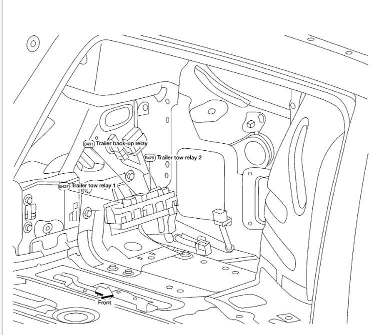

Yep, this happens when the accessory relay is going out inside the right-side relay-fuse panel. Here is a wiring diagram of the display so you can see how it works with the relay location as well. Check out the diagrams (below). Let us know what happens and please upload pictures or videos of the problem.

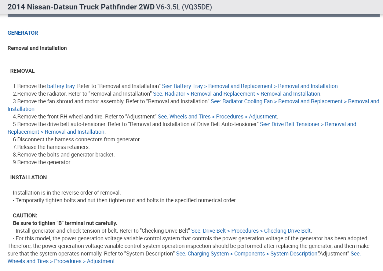

Could this also be related to a bad alternator? Reason I asked is my alternator just shut off with no prior warnings.

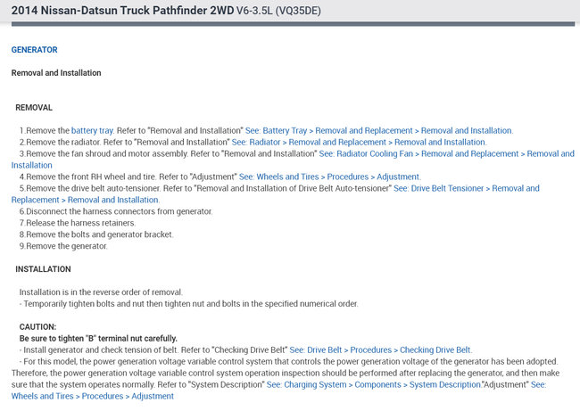

It could if the battery is running low. Here is a guide to test it and diagrams below to show how to change the alternator out:
Monday, March 28th, 2022 AT 9:14 AM

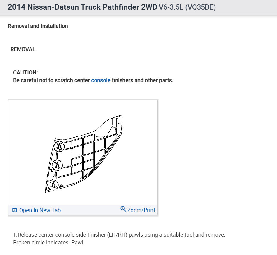

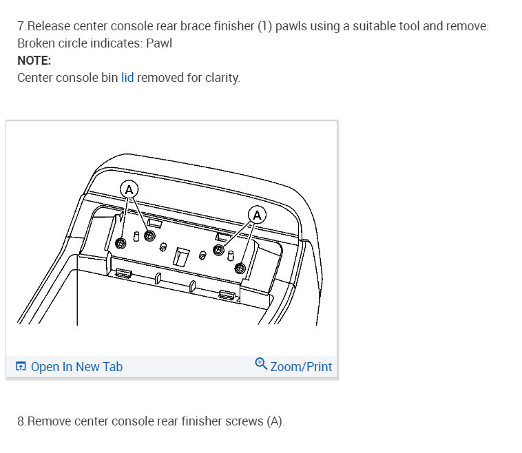

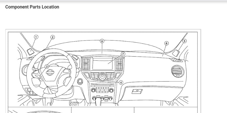

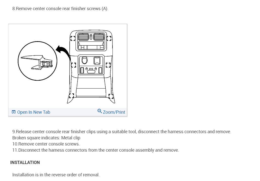

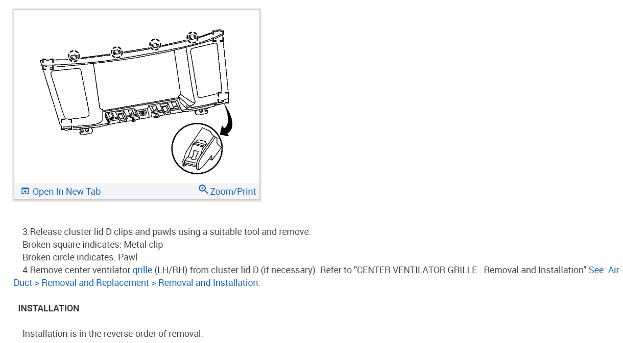

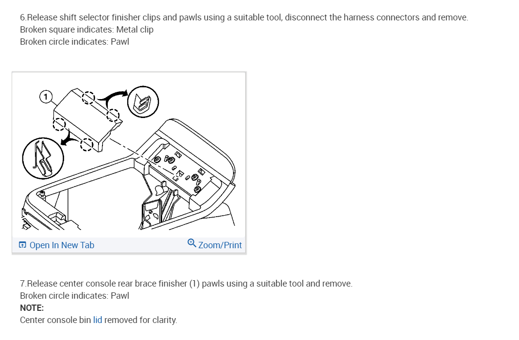

I am having this same issue. The screen is dark, but everything works (including the actual touch screen itself - it responds to touch, but it's black so you can't tell what you are touching). I was planning to buy a used one and replace it myself, but I read somewhere that it has to be custom configured to the specific vehicle by the dealer. Does anyone know if that is really the case?
Friday, October 21st, 2022 AT 3:25 AM
KEN L
  • 55,535 POSTS

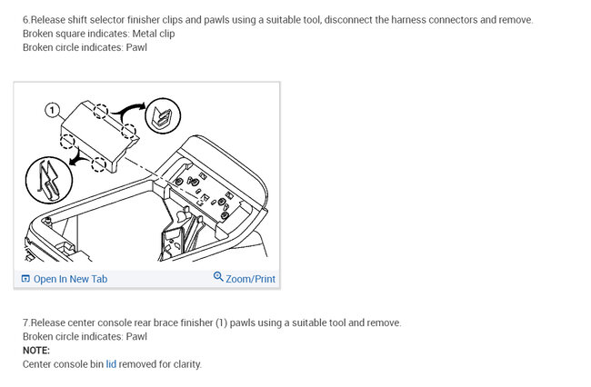

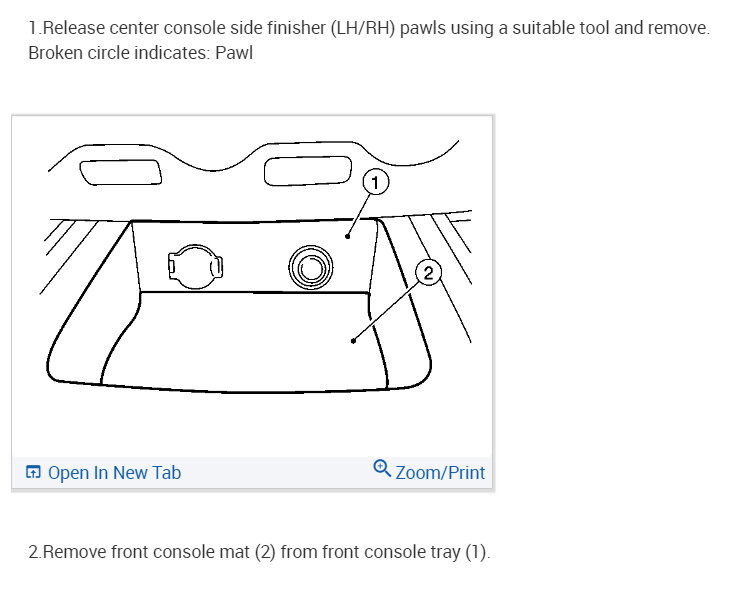

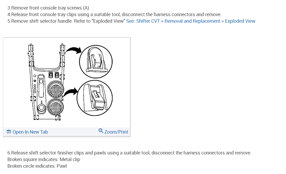

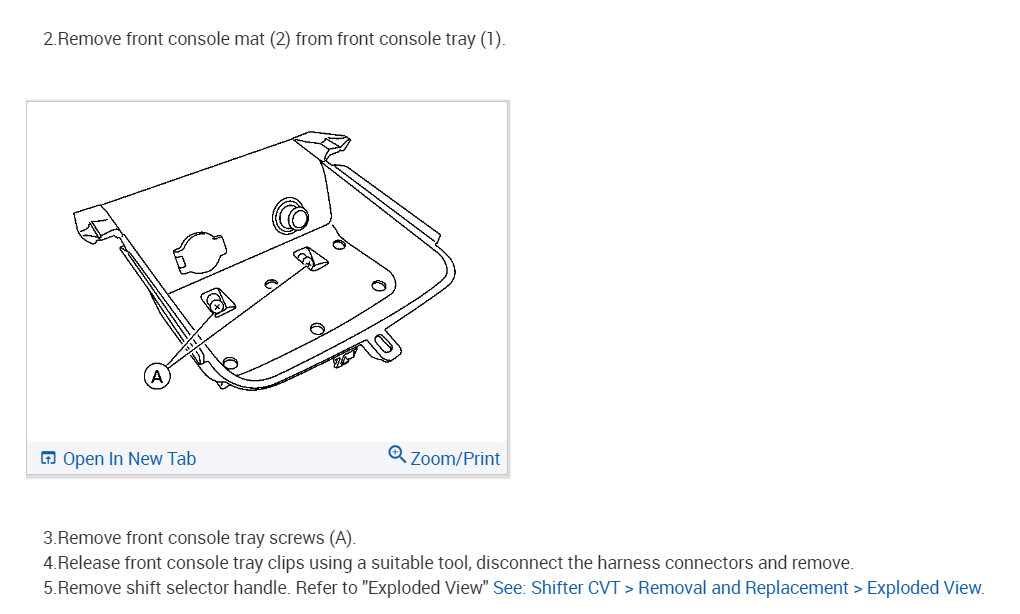

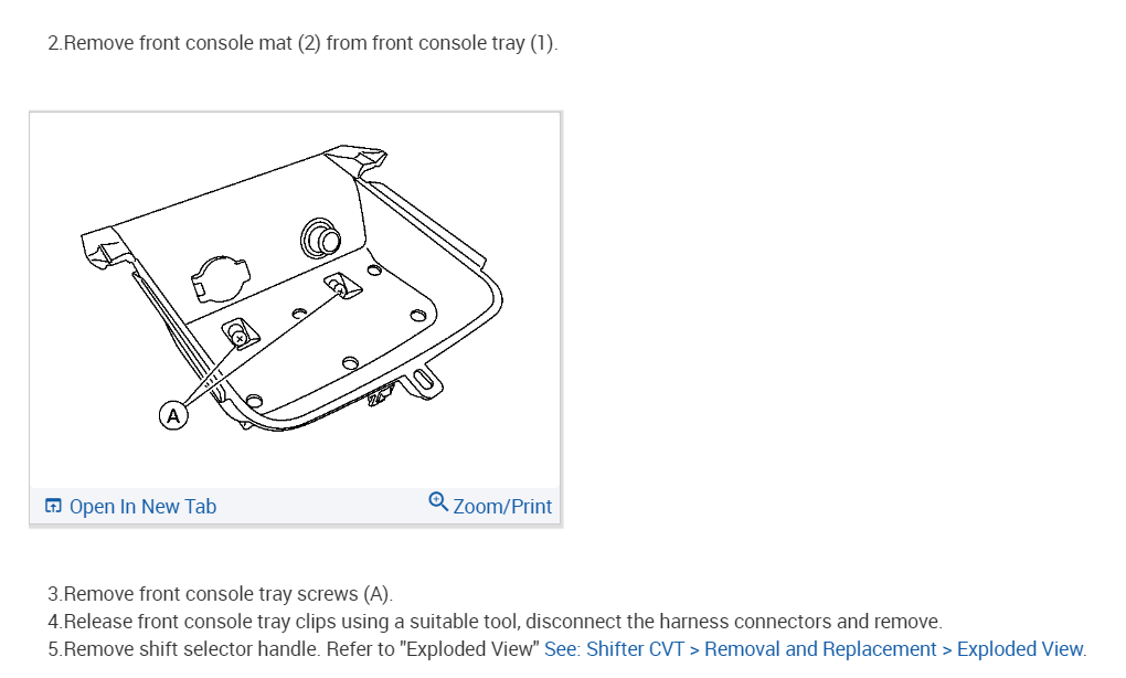

The display unit is plug and play, here are the instructions on how to replace the unit in the images below. Check out the images (below). Please let us know if you need anything else to get the problem fixed.

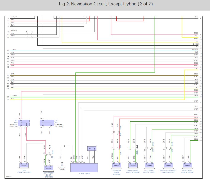

Any fixes? 2018 Pathfinder did something similar black screen no radio either. Weird part is the backup cam shows on the screen still just lost the prediction lines.

This can be one of two things either the display has lost that ability, or the rear camera is not recognizing the lines, I would get a CAN scanner to run the body codes to see what's up. It is easy to do. You can get a CAN scanner (Controller Area Network) from Amazon for about $36.00.

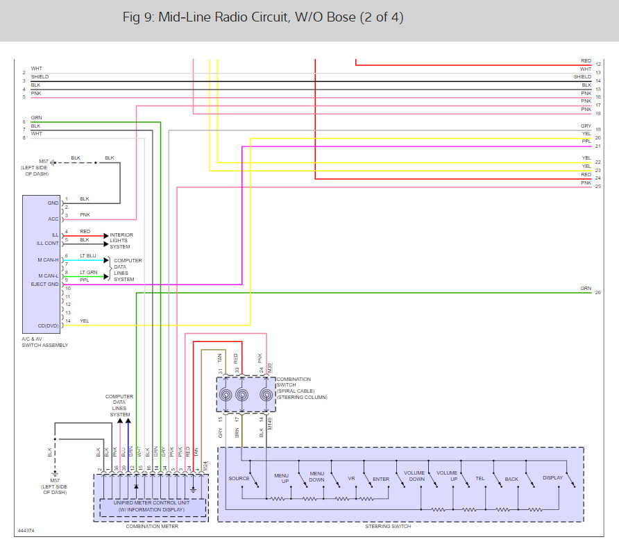

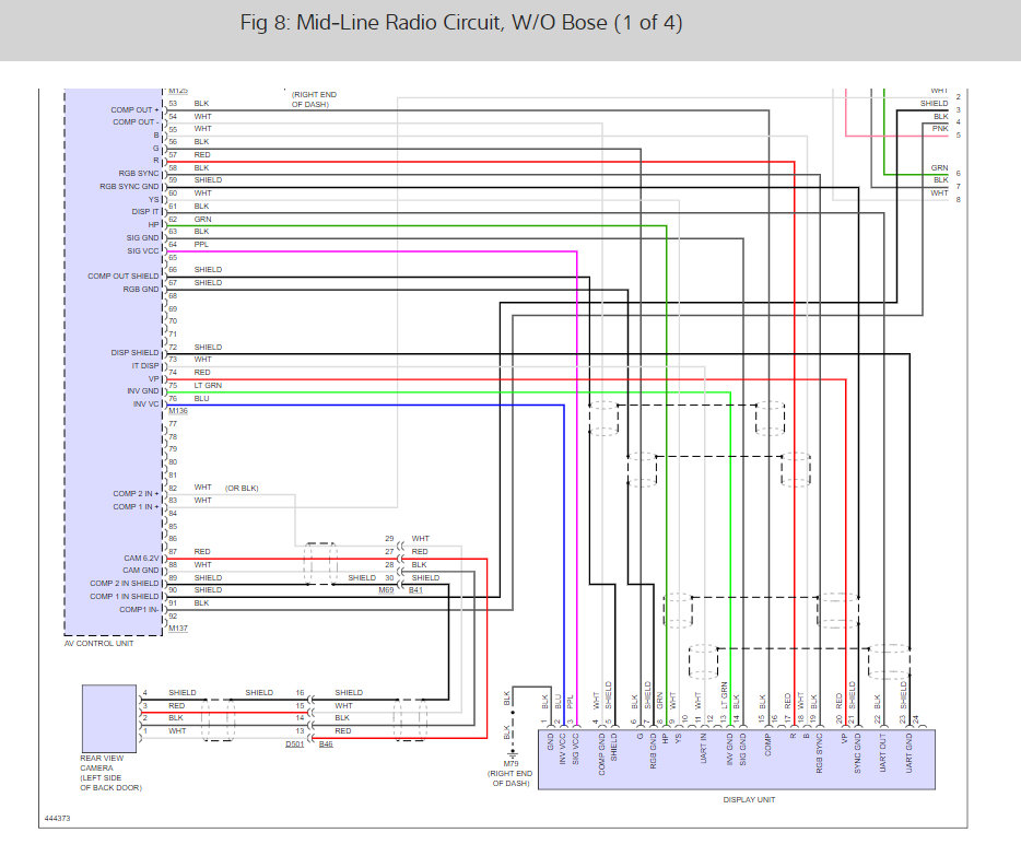

Yes, it can because the system is interrogated. I would get a CAN scanner to be sure though. Check out the wiring diagrams in the post above to see how the system works. Let me know what happens please.
