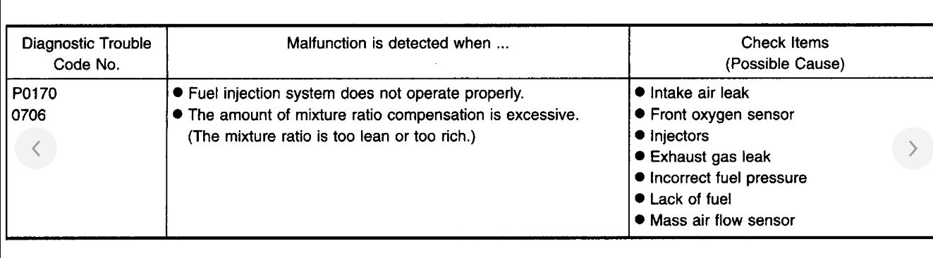

Check engine light and codes P0400 and P0171

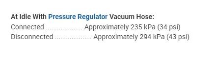

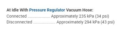

The pressure is good.
What is the long term trim at idle?
+1
Wednesday, February 12th, 2020 AT 3:46 PM
RICHARD HOLLOWAY
  • 26 POSTS
Lngtrmft 9.6
Maf g/s 2.85 - 3.15
Idle bouncing between 790-830 rpm
71 degrees F
74 percent humidity
Elevation 840ft

P0170 came back long term trim at idle still reading 0.0 at 2,000 rpm's. It's reading 9.4 Freeze frame shows it happened at idle fuel system OL-Fault, 797 rpm, long term trim 0 short term trim 25.
Friday, February 14th, 2020 AT 2:50 PM
It is running to lean now.
Friday, February 14th, 2020 AT 2:58 PM
RICHARD HOLLOWAY
  • 26 POSTS
Okay, injectors are good. I checked those when I replaced the seals. I know there isn't a vacuum leak anymore. We know the fuel pressure is good. So that leaves exhaust gas leak, front 02 sensor, or MAF sensor.

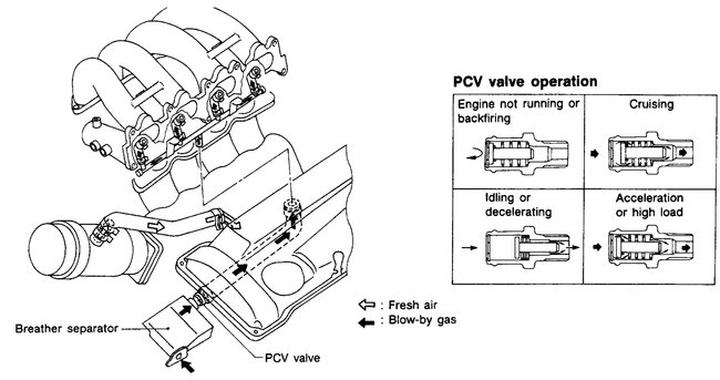

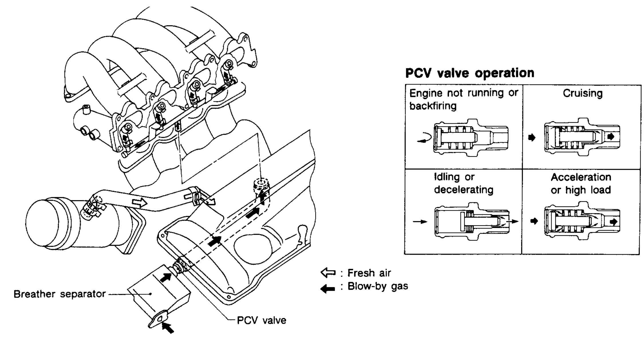

Friday, February 14th, 2020 AT 3:03 PM
JOETECHPRO
  • 705 POSTS
Hey RICHARD HOLLOWAY,
If unplugging the MAF causes the engine to run better it is highly likely you have a faulty MAF.
You have ruled out an air leak.
As a precaution I would first replace the PCV valve.
Also check the condition of the PCV hose.
If it is cracked or collapsing replace the hose.
I have attached the photo showing the location in the picture below.
I failed PCV valve can cause MAF sensor reading issues and it is a cheaper replacement part before replacing the MAF. I would replace the PCV valve and retest and then I think your next step would be to replace the MAF.
Regards, Joe
