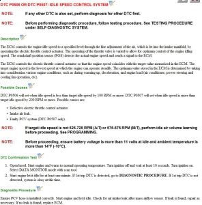

So here is the deal. I have a 2002 Altima 2.5, 150K, that had excessive oil consumption, low compression in two cylinders and basically ran like C***. I just dropped in a 2006 engine, 14k miles where the only issue was that it's California emission. I replaced both Cats, and all 3 O2 sensors. I just picked it up today and after running it for a 1/2 hour, the check engine light came on. My fear is that I have a California emission engine with Federal Emission cats. Does anyone have any thoughts on this? In talking to the people where I purchased the engine they told me I should be fine with this setup since my ECU was based on the federal emissions. So what is different between a California emission engine and a federal one, if anything. Just dropped $2500 on this entire repair and feel like I am back to square one.

Hi solexa,
Thank you for the donation.
Did you retrieve the trouble code for the MIL showing?
If the harness and ECU was not replaced, there should be no difference and the MIL could be for something out of adjustment or not correctly installed.
Get the trouble code so that we can understand the problem better. Try Autozone, they provide free scanning if you do not have a scanner.
I need the exact DTC, not just the description.
Feb 13, 2019 at 7:15 PM (Merged)
SOLEXA
Ok, Here is what I found out. Code is PO507
Idle speed control system RPM higher than expected.
Probable cause.
1. Large Vacuum leak
2. Engine mechanical condition
3. Electric throttle control actuator fault.
The engine is a 06 with 14k miles so I would hope it's not #2. Your thoughts?

KHLOW2008
  • CERTIFIED EXPERT
  • 41,814 POSTS
Hi there, I believe the more likely problem would be vacumn leakages. Here is a description and diagnostic procedures.
