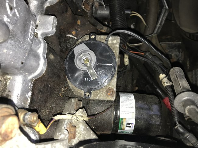

Found TDC for cylinder 1, and it’s in time with the rotary button. Button was pointing towards that spark plug. Timing belt was fine.

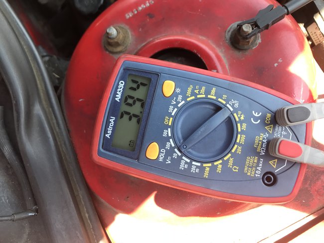

I'm still bothered by the low voltage to the ignition coil. Check if there is a condenser connected to it. In this application it would just be for radio noise suppression, but if it is "leaky", meaning not quite shorted, it could draw the voltage down.
Another way to track this would be to use a small jumper wire to connect the two larger-diameter wires in the ASD relay's socket, then measure the voltage at various places in the circuit. You don't need to have the ignition switch on for this, and bypassing the relay just powers up the circuit like normal, but without the engine running.
Start right at the battery's posts. If it's good and fully-charged, you'll find close 12.6 volts. Now move the meter's probes from the posts to the cable clamps on them. You must find the same voltage. If it's lower, one of those connections is loose or corroded.
Next, move the negative meter probe from the battery cable to a paint-free point on the engine. The voltage still should be the same. Move the positive meter lead to the ASD relay's wires. By this time you might see the voltage drop a little, but ideally it should still be the same as when you started at the battery.
Finally. Move the positive meter lead to the positive terminal on the ignition coil. If you're seeing the same 9 volts you found originally, three volts is being dropped somewhere. Finding where is done this way by taking these voltage readings all along the circuit.
If you still have a good 12+ volts at the ignition coil, but it goes down to 9 volts when the jumper is removed from the relay socket and you're cranking the engine, the only thing left is the contacts in the ASD relay. If those are arced or corroded, you should get a nice strong spark if you put that jumper wire back on, and replacing the relay should solve that.

Did the voltage test you described. I put a jumper in between the ASD wires, and the ASD was getting 12.1 volts, just like the battery, and the battery terminals. With the jumper wire, the ignition coil got 10.9 volts. Should I crank the care with the jumper wire in and see if it starts? I still need to test for bad fuel.

The voltages at the ASD relay and at the ignition coil have to be the same. I suspect you're measuring at the coil while you're cranking the engine. A lower voltage then would make sense because the starter is going to draw the battery's voltage down a volt or two.
10.9 volts at the ignition coil should be enough to develop a strong enough spark.

That 10.9 wasn’t while cranking, that was just with the key in the “on” position.
Well now with the key in the “on” position, and bypassing the ASD relay or not, the coil is now getting max 3 volts.

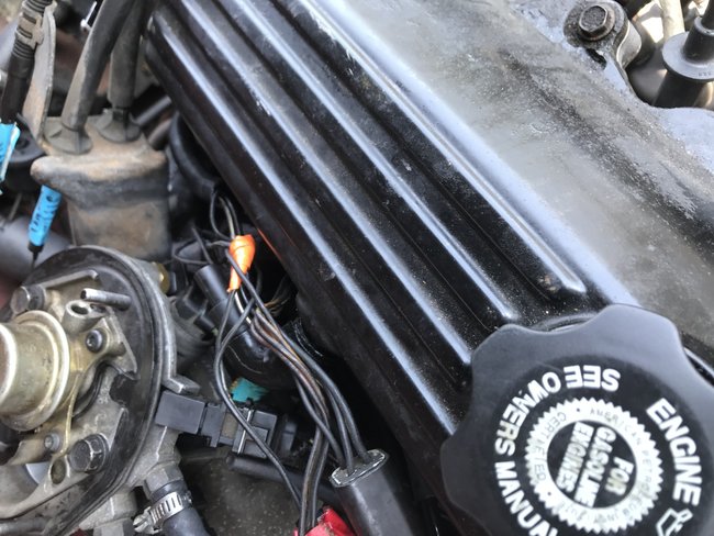

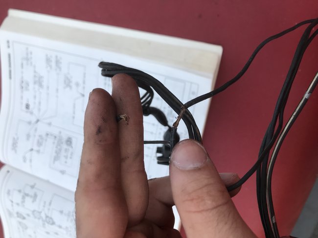

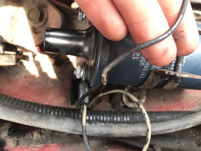

Last summer, I had a wiring harness part of the O2 sensor snap, and I just wrapped the copper around the copper it was connected to and put some electrical tape on. I just tried to repair it 30 minutes ago, and added some dielectric grease to the connection. Could this explain the voltage drop? Nothing else has changed since I took my 10.9 V reading. Do I need to saucer the connection?

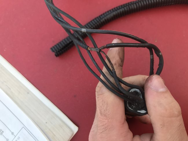

I don’t know why my grammar is so poor typing, and I meant to say solder not saucer. Some of my photos also didn’t go through.
The taped connection is the orange tape. The O2 sensor has a splice that goes off from the ignition coil. My second photo here is what the connection looked like broken last year.
Sunday, May 19th, 2019 AT 10:23 AM
CARADIODOC
  • 34,463 POSTS
Yes, the wires must be soldered, otherwise there will be resistance in the joints, and that will cause a drop in voltage. Also, only use heat-shrink tubing with hot-melt glue inside to cover the splices. Electrical tape will unravel into a gooey mess over time.

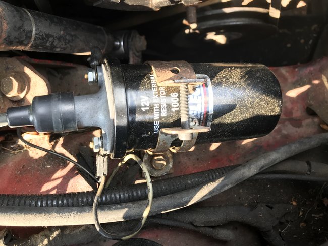

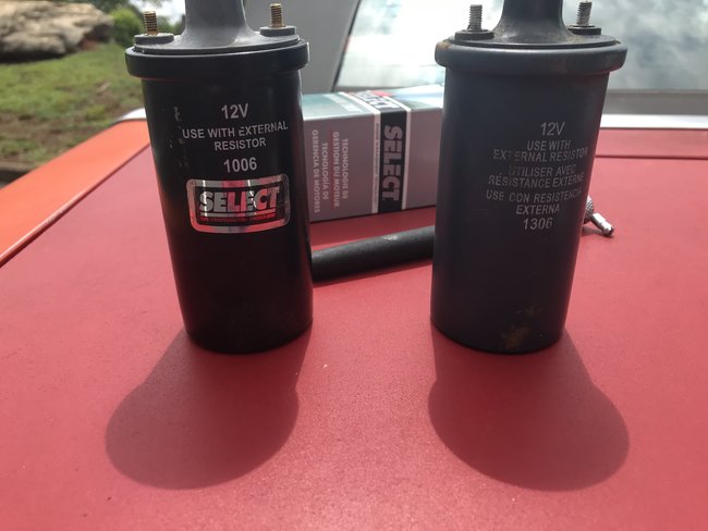

I’ve replaced everything in the ignition system at least once (ignition coil, spark plug wires, spark plugs, distributor cap, rotary button, Hall effect sensor), and the car still won’t start. The coil is getting slightly low voltage, but I agree with you, I don’t think that’s it because when I put a jumper wire from the battery to the ignition coil, it still won’t start.

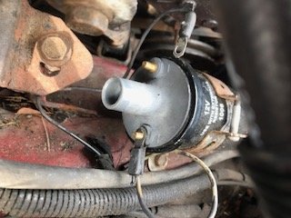

All of my ignition coils say on it “12V Use with External Resistor”. Where is this resistor? Even the original coil I had with oil in it says to use an external resistor. I know we briefly talked about this before.

No external resistor is used in this system. When one is used, it is to limit current flow and reduce voltage to the coil to the voltage it is designed to operate on. Since system voltage is dropped even further when the battery is loaded down by the starter motor, that resistor would lower the voltage to the coil too much, so it needs to be bypassed during cranking so the spark will be strong enough to ignite the fuel. There is no provision in this system to bypass a resistor during cranking.

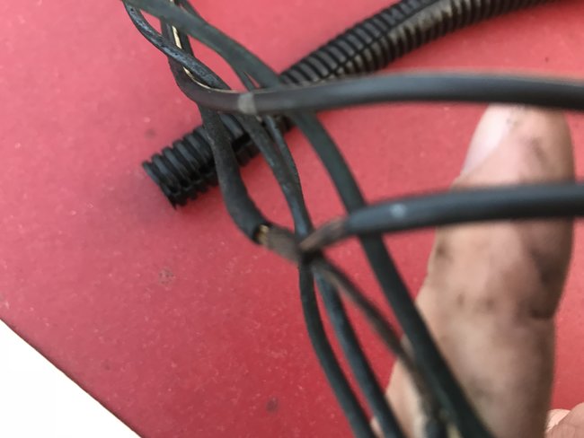

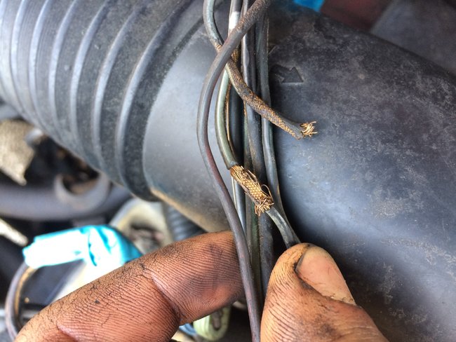

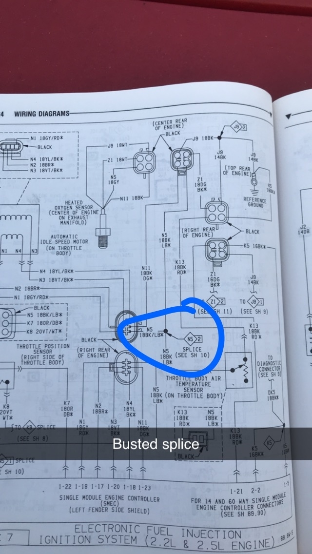

I just noticed something while rereading the previous replies. In the photo from three replies ago where you referred to a broken oxygen sensor wire, it looks like that has a braided copper shield around the other wires. If that is what was used, that braided wire and the other wires are different and can't be soldered together. The braided wire is a shield to keep out stray magnetic interference and it is always connected to ground.
One of those other O2 sensor wires is a dark green / black for the internal heater. That's the same 12-volt circuit coming from the ASD relay that goes to the ignition coil. If that dark green / black got soldered to the ground wire, or has a stray strand of wire that is touching the ground wire, that would explain the real low voltage feeding the ignition coil. A dead short should burn open a fuse link wire by the left strut tower, but if that short isn't a perfect short, there can be enough resistance in pitted ASD relay contacts and other connector terminals to limit current low enough so that link doesn't burn open. Instead of the expected 0 volts, you might get a few volts at the coil during cranking.

Open it up and look at the wires more closely to see if there are four of them inside a braided shielding wire. Those can be rather difficult to repair. You'll need to peel the braid back far enough to expose enough wire to be spliced and soldered. Each wire has to be spliced individually, and sealed with moisture-proof heat-shrink tubing. Pull the braided shield over those wires as best you can, but don't panic if a few inches aren't covered.
I don't remember there actually being a braided shield, so if there is not, just splice the four wires the same way, then for good measure, it would be nice to seal the entire repair with a larger piece of heat-shrink tubing.
Before you splice these wires, leave them disconnected, then see what happens to the voltage at the ignition coil during cranking. If those wires were shorted before, the engine should start now. It will run without the oxygen sensor connected, but expect to see the Check Engine light turn on. You can erase the fault code later by disconnecting the battery's negative cable for a few seconds.

This is the busted splice. I can’t tell if the wires are behind a braided shielding wire. It doesn’t look like it. What do you think?

I don't recall ever seeing a braided shield but It kind of looked like that in your earlier photo. There isn't one in these photos. The only thing to watch for related to a crank / no-start problem is that none of these wires are shorted together or to ground.
