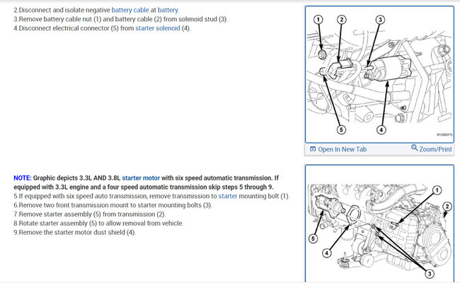

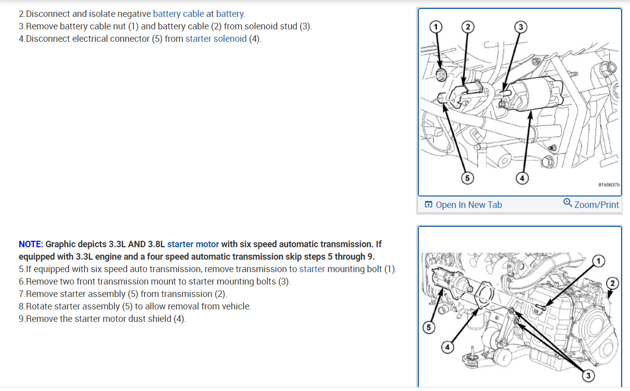

When I put the key in and turn all the lights on the dash come on but when I turn the key it makes a high pitched whirring sound.
Saturday, June 26th, 2021 AT 3:02 AM
MECHANIC
52,796 POSTS
Good morning,

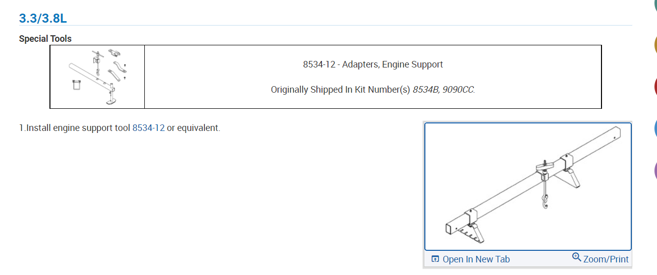

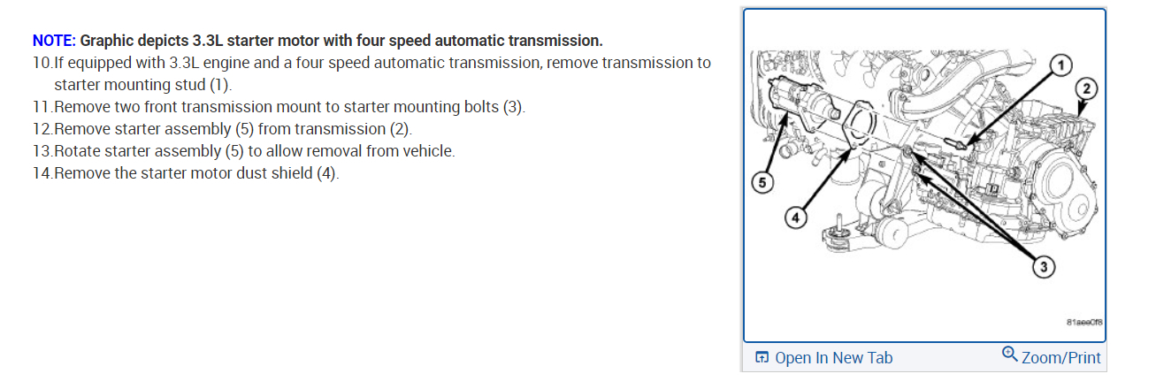

This sounds like the starter motor may be the issue not engaging the engine flywheel.
https://www.2carpros.com/articles/how-a-starter-and-solenoid-works
Can you upload a video of the noise so I can hear it?
I attached the procedure below for the replacement of the starter if that is the issue.
