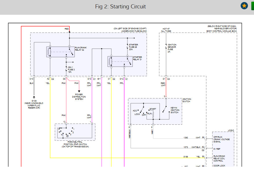

Everytime I try to start my car I turn the key but it makes no sound at all. The lights work on the inside and outside of the car. The windows and locks work. I was thinking the starter but I really don't know.

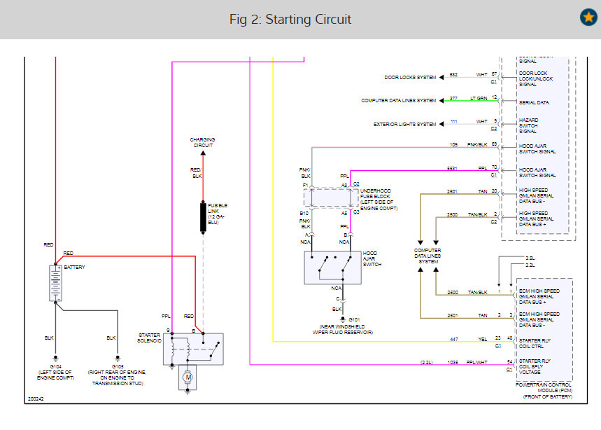

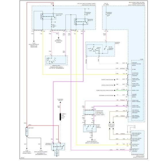

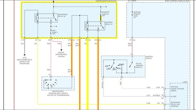

I will attach a wiring diagram for you to view as well.

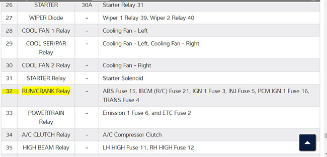

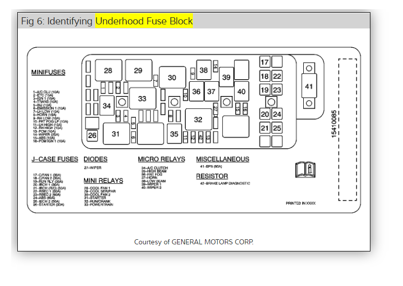

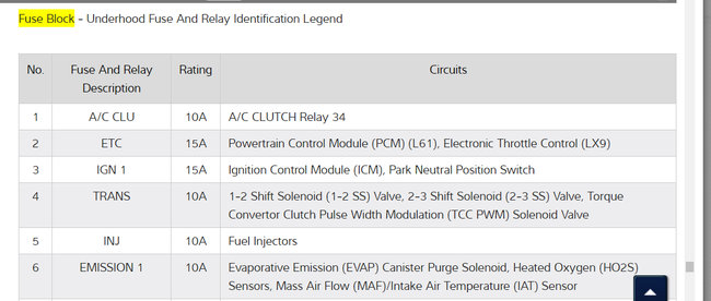

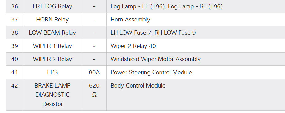

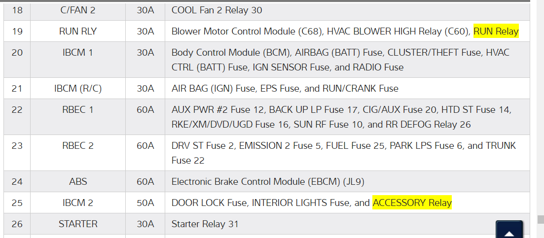

Okay, this could be a problem with the Run/Crank Relay which is located in the Under Hood Fuse Block. I have included a wiring diagram of your vehicle's starting circuit in the diagrams down below as well as a diagram and callout for the Under Hood Fuse Block. You can either swap the relay for a known good one or take a voltage reading with a helper cranking the ignition key at pin #86 of the Run/Crank Relay. I have also included a diagram of a 4 Pin relay for you in the diagrams down below as well. Either way please get back to us with the results and we can go from there.
