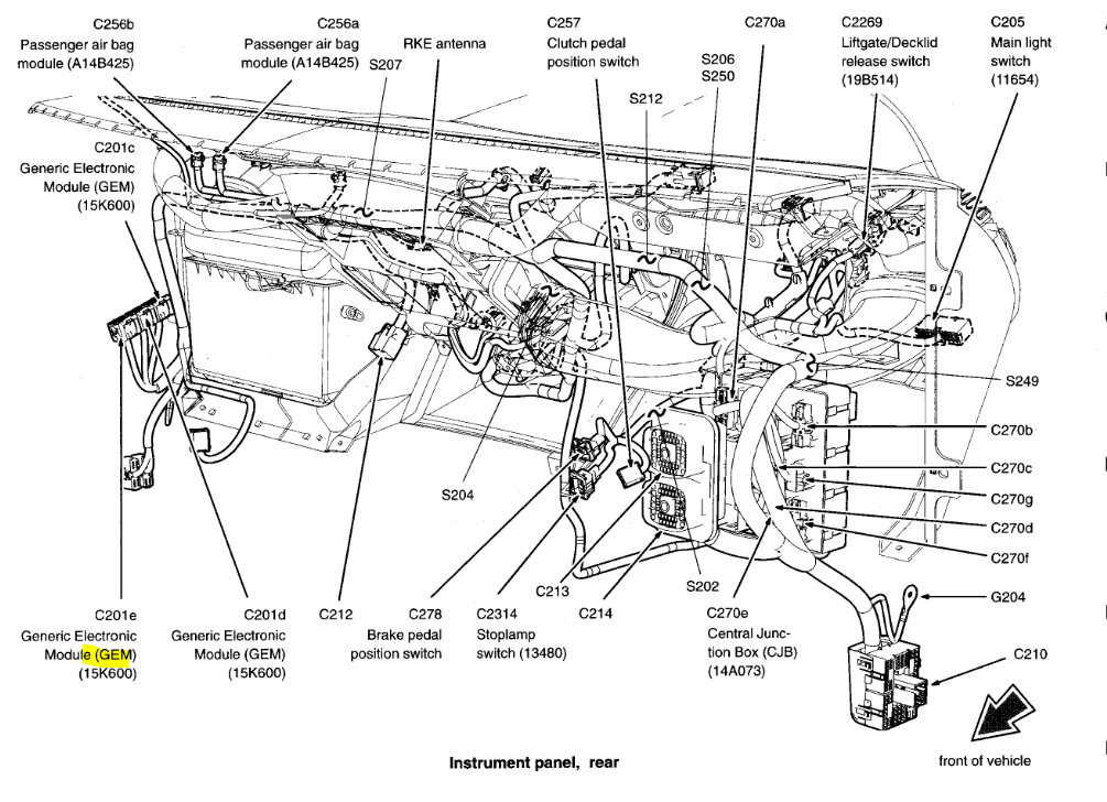

It is possible that you could have a faulty anti theft module.
You might want to use a scanner (capable of retrieving immobilizer codes) to get the fault codes and see what they are.
On this vehicle the anti theft is part of the General Electronic module (GEM).

SQM
  • 6,383 POSTS
It's on the passenger side behind the instrument panel. See diagram below.

SQM
  • 6,383 POSTS
The immobilizer is part of the GEM module. Anti-theft if one of the many functions of the GEM module.
