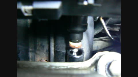

Ok Ken. Here is the video.
As we suspected all the injectors are open when the key is turned to the on, engine off, position and gushing out fuel. A note about the injectors.... all the injector pintle caps either came off and went into the engine cylinders or got stuck in the inlet manifold which is why you can see the bare metal of the injector ends. Which means more work for me to find out where they went. This should not have happened and I will be contacting the seller of the injector refurbishment kit. Also, I missed showing number 4 but that too was spraying out fuel.
I suppose the good news is that the spray of all the injectors looks very good and consistent across the board! So apart from the pintle caps coming off they look as good as new!! ;)

O man, we called that one, if you have an injector that is shorted it can cause the injector driver inside the ECU to go full on like it is. Try to unplug all injectors and plug them in one at a time to see which one it is that causes the full on condition, Also you can test the injector winding by following this guide.
https://www.2carpros.com/articles/how-to-test-a-fuel-injector
If they check out then I would say the ECU is bad.

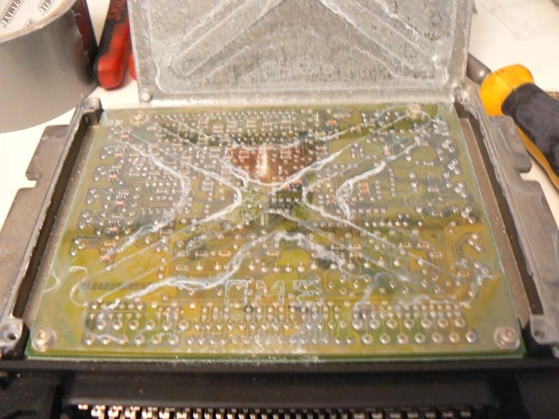

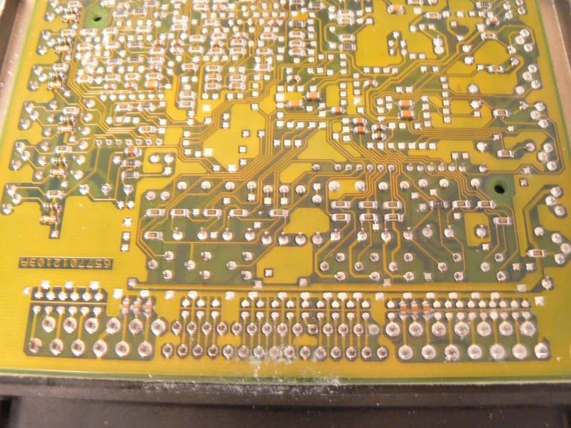

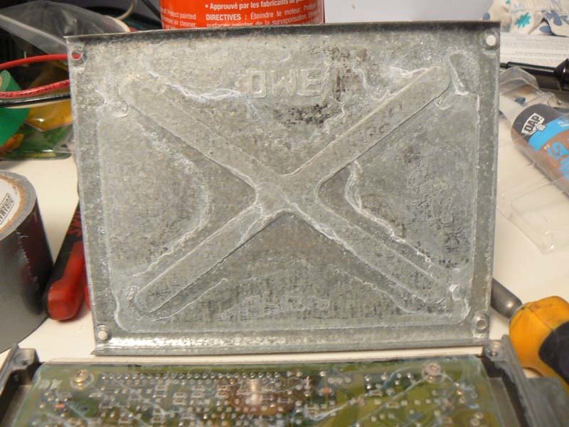

I tested each injector individually and each one by itself opened when the key was turned to the on, engine off, position, spurting more fuel out - just like before. I didn't bother testing the injectors electrically. I removed the ECU/DME and just prior to packing it up to ship to be repaired in Illinois I opened the unit up. I found some water damage on the bottom of the unit as can be seen in the pics below.
The first image is the inside of the bottom casing. The second image is the staining that has occurred on the plastic that sits between the casing and the circuit board. The third image shows the water damage to the circuit board which can be seen at the bottom of the image where there is white stuff on it.
There was probably a short of some sort and has blown one of the transistors in this area. The other side of this circuit board is where a lot of the chips are situated for this unit.
All this fits with the information I came across about what happens to this model of BMW when it rains very heavily. When rainfall is exceptionally heavy water gets into the computer compartment due to the drainage system (the lip) around the hood area not being high enough with the result that too much water flow can overwhelm the drainage system and enter the engine compartment, usually making its way to the computer compartment first. This is a known fault/problem by BMW. I will have to ring them up and find out if there is something they can do about it as I read that there is a kit that they can install.
And remember I mentioned way back in my first post that this problem occurred after a very heavy rainfall. By the time I came across this info and looked inside the computer compartment the water had evaporated (it did happen after all at the beginning of summer back in May)!
