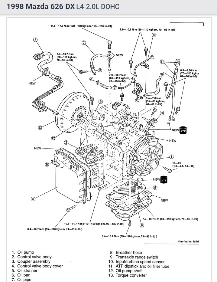

I can start my car put it in drive and it will drive just fine for a few minutes then the car will stop going. The engine revs when I give it gas but it feels like the car is not engaging in drive. Sometimes it drives sometimes it does not. I shift through the gears and I do not feel it engaging in any of them for the most part.

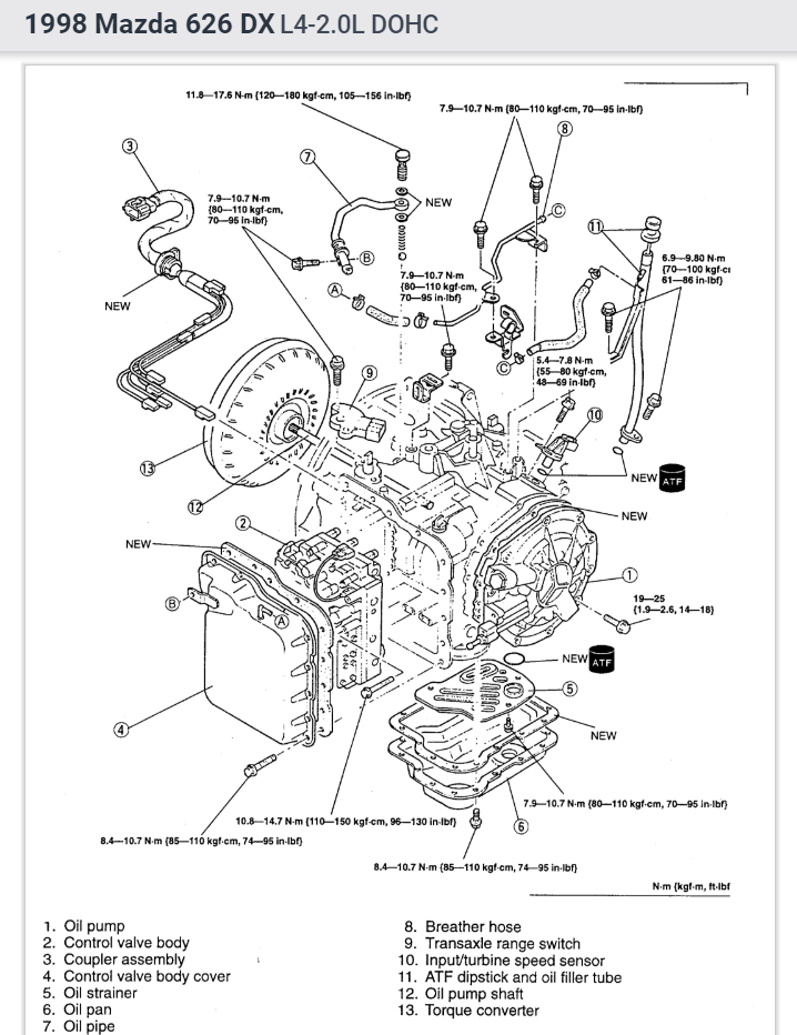

This sounds like the transmission fluid level is low. Have you checked it? Here is a guide that show how to do it at the end of the guide with a diagram below to show how to on your car:
