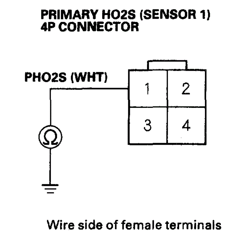

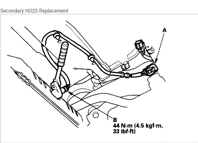

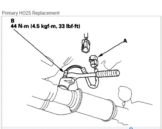

Yes, the sensor can cause a hard start when hot. Also, the idea that it is extremely lean may indicate a vacuum related issue. Have you checked for engine vacuum leaks? Here is a link that shows how that is done:

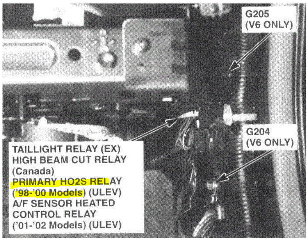

I attached two pics below showing the location of the primary sensor (pic 1) and the secondary (pic 2). Note: The primary HO2S is installed in the exhaust manifold.

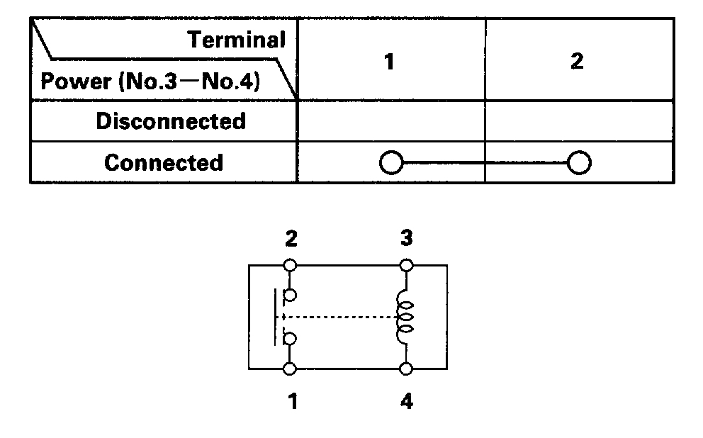

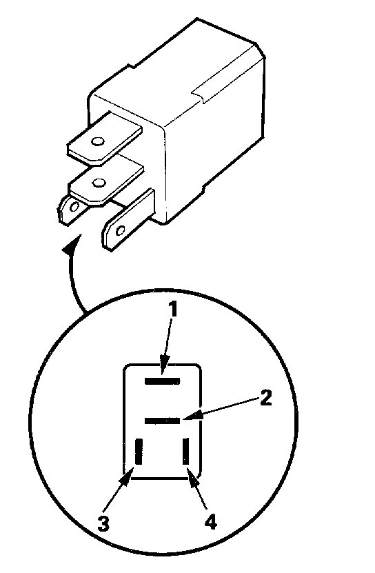

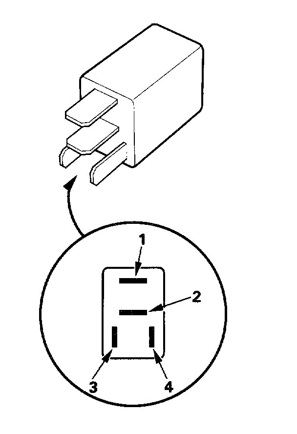

Also, there is a relay that operates the primary sensor. See pic 3 for location. Also, here are directions for checking it:
__________________________________
POWER RELAY TEST
Normally-open type A:
pic 4
Check for continuity between the terminals.
- There should be continuity between the No.1 and No.2 terminals when power and ground are connected to the No.3 and No.4 terminals.
- There should be no continuity between the No.1 and No.2 terminals when power is disconnected.
Type 1
pic 5
Type 2
pic 6
Heated Oxygen Sensor Relay (California)
Let me know if this helps.

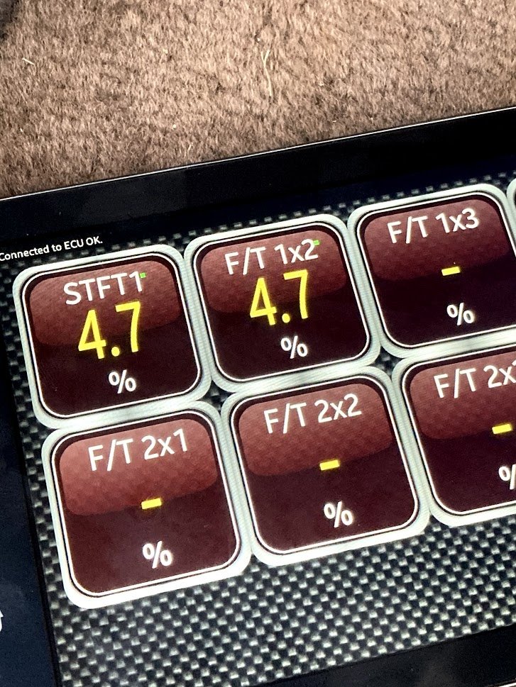

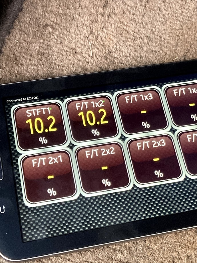

Hey I'm back! I had to find my scanner, but I got those fuel trims.
So my scanner isn't the greatest, and it's on the cheap side, so I sent two different numbers, one that was at normal idle around 800 rpm, and the higher fuel trim percentage a couple seconds after revving to around 1400 rpm as it was returning to 800 rpm. This was a cold start, so I'm not sure what happens on the hot start failures, but here's what I have. These numbers were also coming from Bank 1 sensors 1 and 2, if that's relevant. I also was no longer getting a fault code for P0131 anymore, so I do not know what's up with that, but there really was no other codes other than previously logged fault codes from a previous hot start (which I cleared).
Saturday, August 8th, 2020 AT 4:17 PM
  • 110,194 POSTS
So the codes are gone and the light is off? Has the problem resolved itself?
As far as the trims, in a perfect world, it would be at 0 at idle. The idea that it is a positive 10.2, that indicates the computer is adding fuel to eliminate a lean mixture. Have you checked for engine vacuum leaks? Also, have you checked fuel pressure?
Saturday, August 8th, 2020 AT 9:48 PM
TEESURRATT
  • 17 POSTS
So those fuel trims fluctuated constantly, at normal idle I saw from around 0.8 to 6.6, but usually hanging around 2-3%. With the revving, it would start with the 10-12% percent and then come back down to fluctuating above and below the 2-3% mark. With the fault codes, I guess the problem fixed itself? I’ll just have to see as I keep driving it. I’ll have to check for vacuum leaks and fuel pressure tomorrow, I’ll get back to you.
