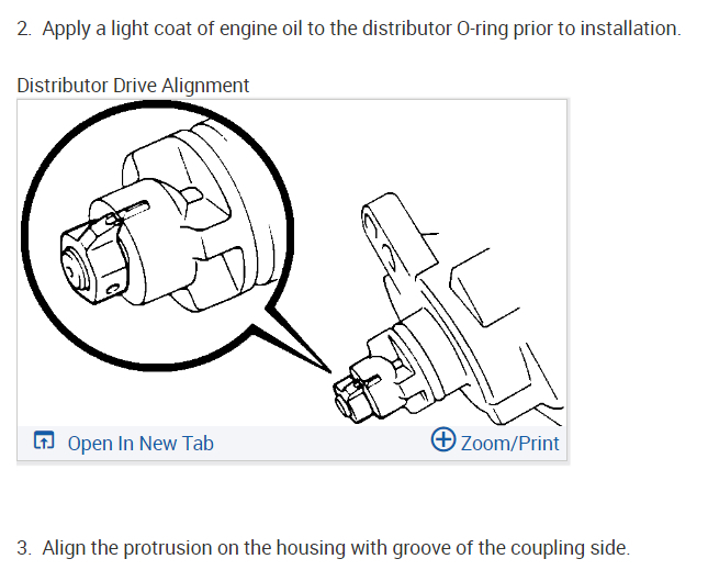

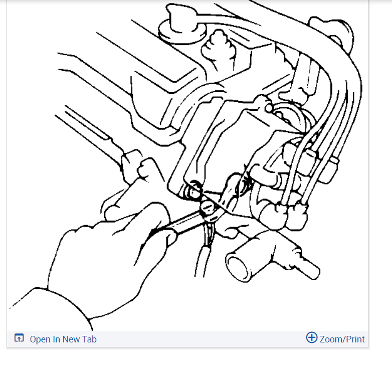

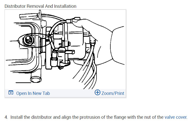

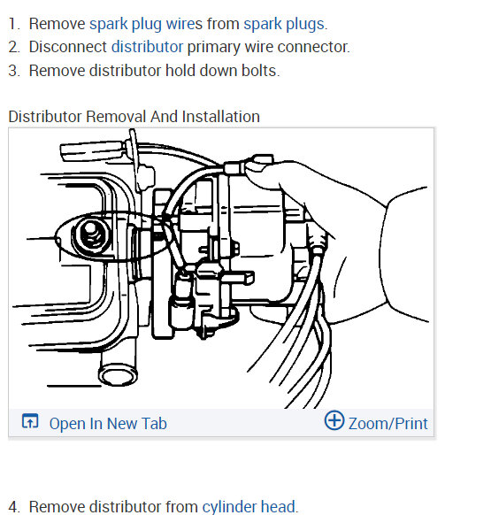

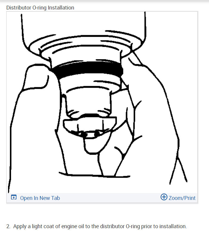

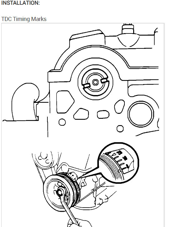

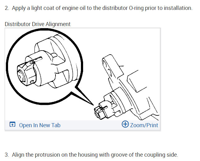

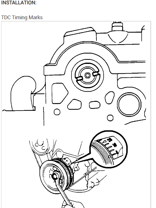

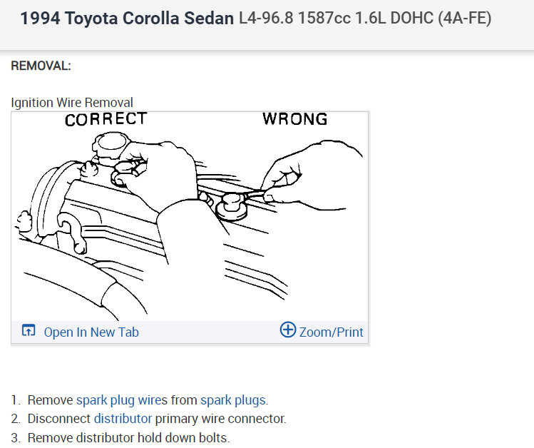

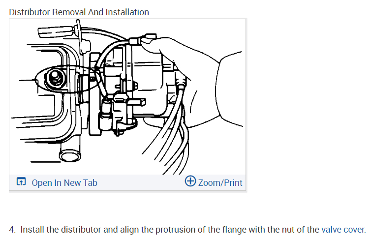

FYI a bad crankshaft position sensor which is inside the ignition distributor can make the injectors not pulse which will stop the fuel from getting to the spark plugs. Here is the location so you can swap it out, also you should run the codes to see if any are stored, this guide will help you.
https://www.2carpros.com/articles/toyota-trouble-code-definitions-and-code-gathering-method-1990-1995
