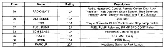

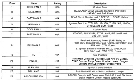

Car was running fine I turn off the ignition went to start the car it will not start but will turnover.

If you still do not hear the pump come on, then you need to check the fuses. There is a fuse box diagram attached below. The fuse box to look at is the one that's under the hood. In particular, look at the fuses for "fuel pump", "ECM/TCM," "PWR Train," and "ENG Ign."
