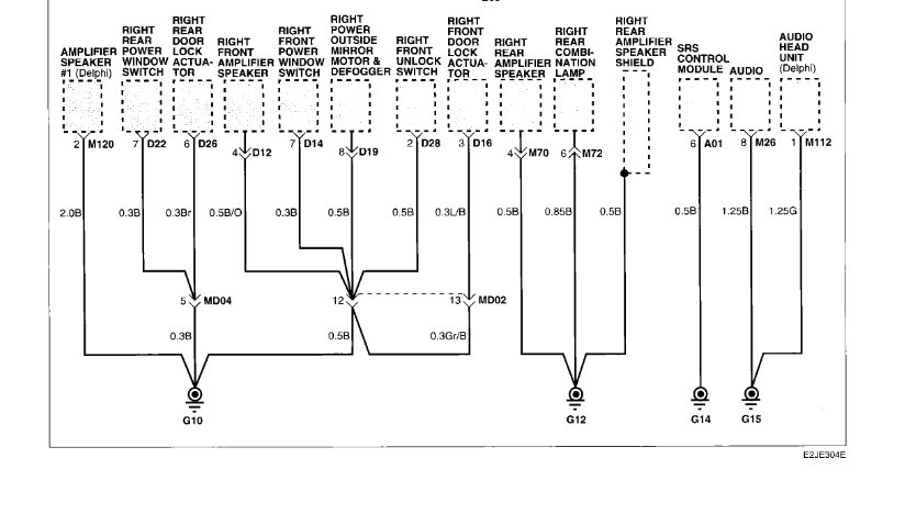

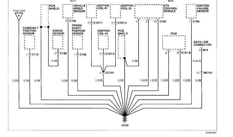

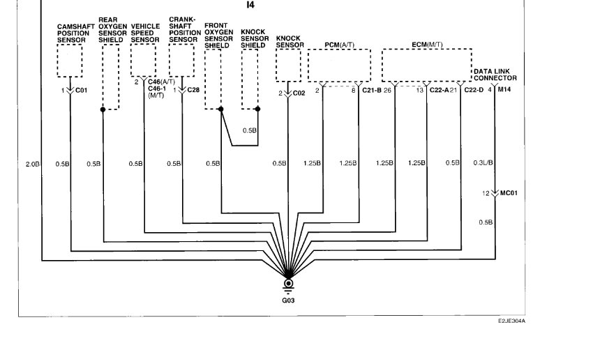

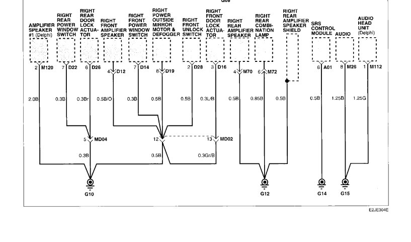

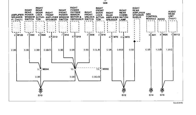

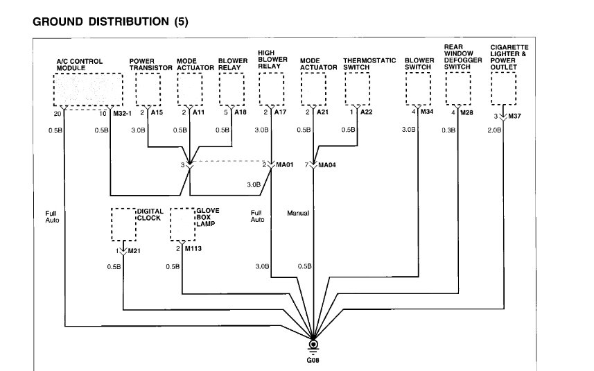

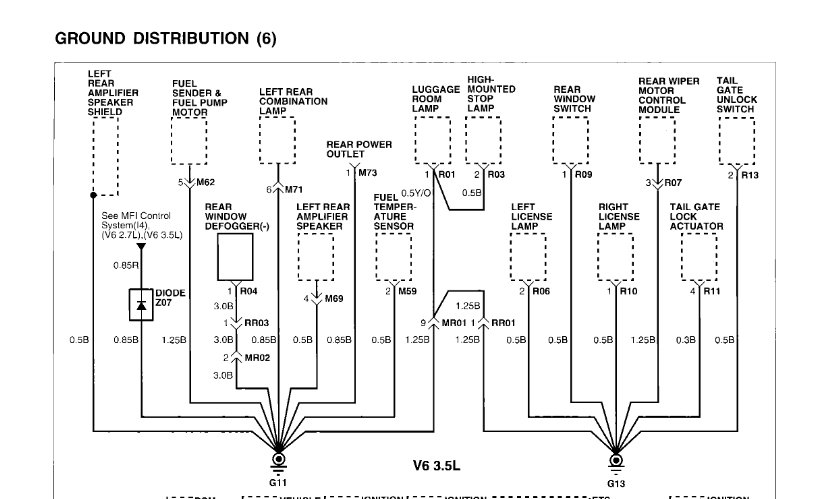

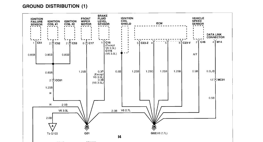

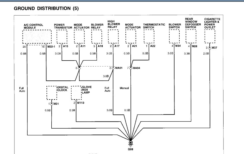

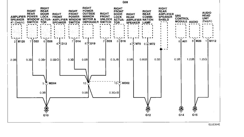

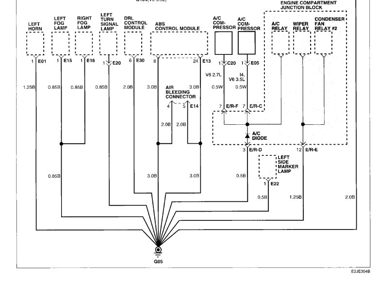

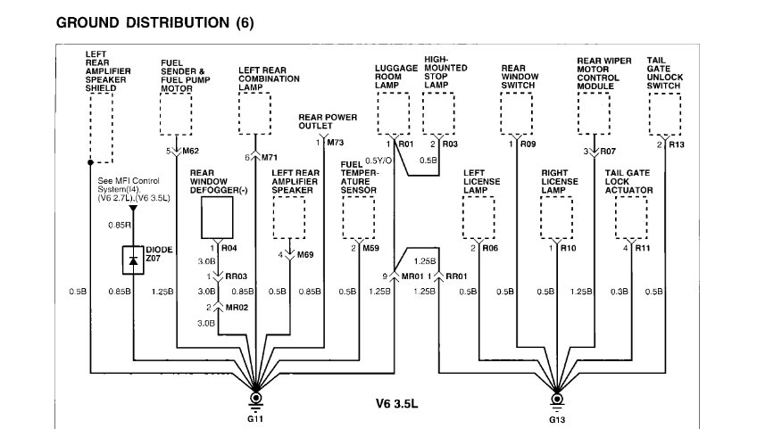

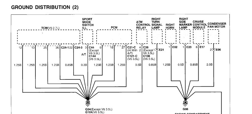

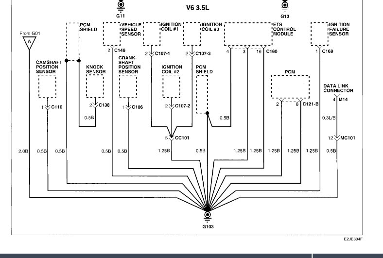

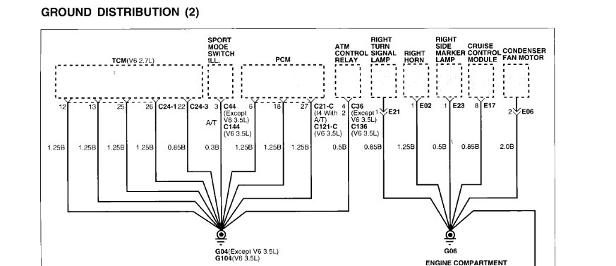

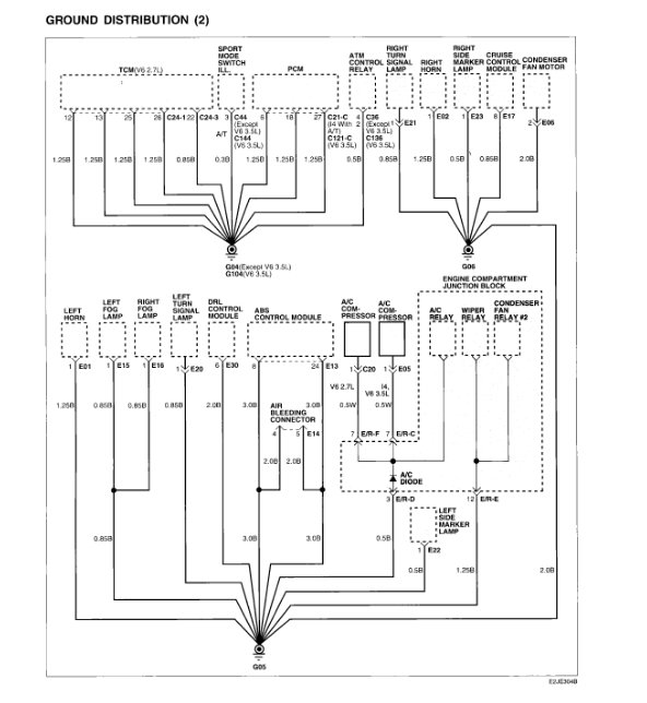

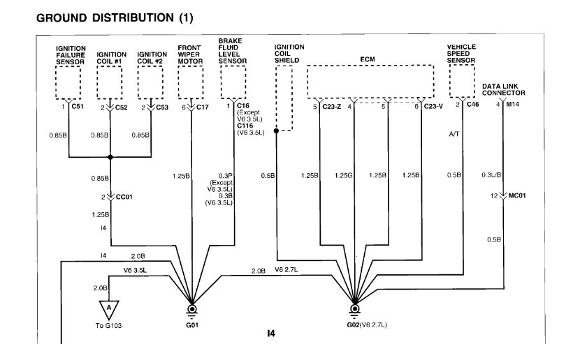

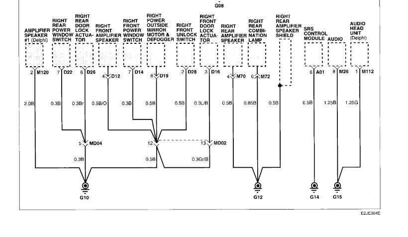

Hello again,

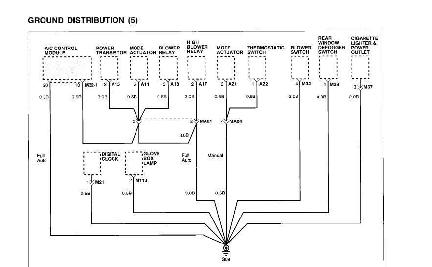

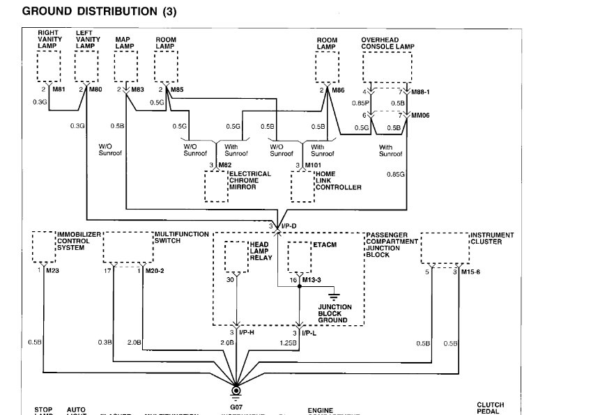

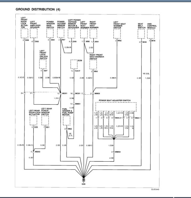

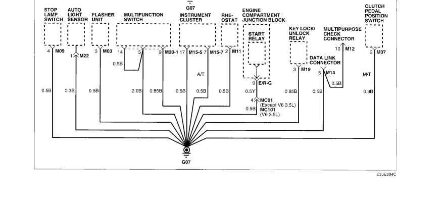

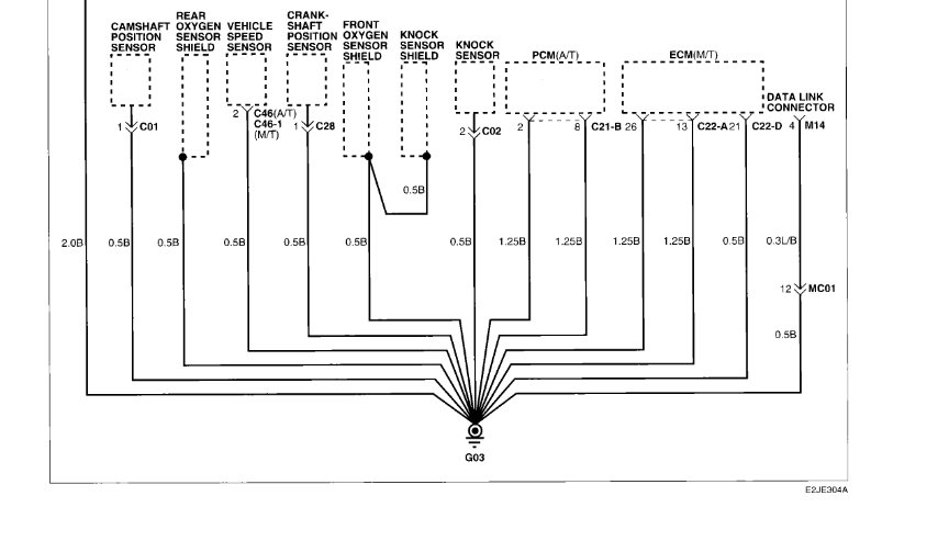

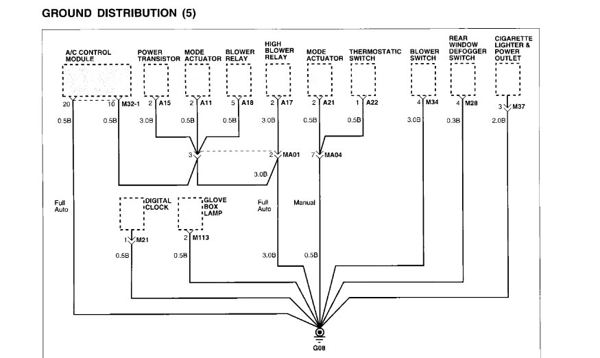

Have you checked the Grounds that I sent earlier? They are all of the ground locations for your entire vehicle. In the diagrams down below I have also included the ground distribution wiring diagrams for you that show where all the vehicle components are grounded to. Please get back to us with what you are able to find out.
Thanks,
Alex
2CarPros
Wednesday, October 16th, 2019 AT 9:06 AM
PETAR LJ
  • 32 POSTS
Hi there again Alex, so far the earths were cleaned up only the main engine o earths to go. Now the idle still goes crazy but I found that when you pull on the purge valve pipe the idle goes up and down high rpm's. I can’t get a look at the purge valve behind the inlet manifold would the be a leak there somewhere, and do you have a wiring diagram of the cruse control system? I got power up bet still not working. Thank you
