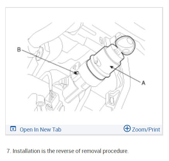

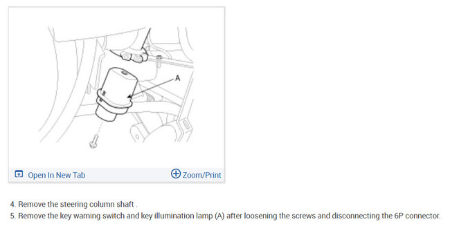

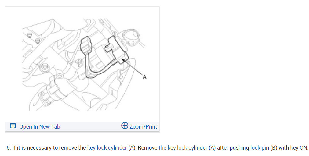

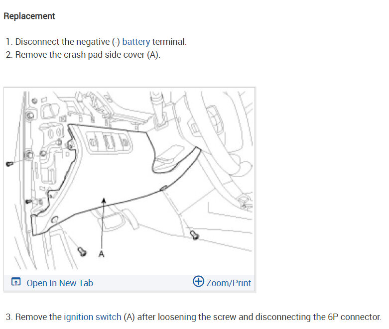

Yes, it could I thought you said you replaces that. I would replace the "switch" apart of the ignition switch. Let us know what happens. Here is how to change the switch out, also if this is not the problem I have seen the junction box on the passenger's side go out and can cause strange issues like this one. Check out the images (below). Please let us know what happens.
