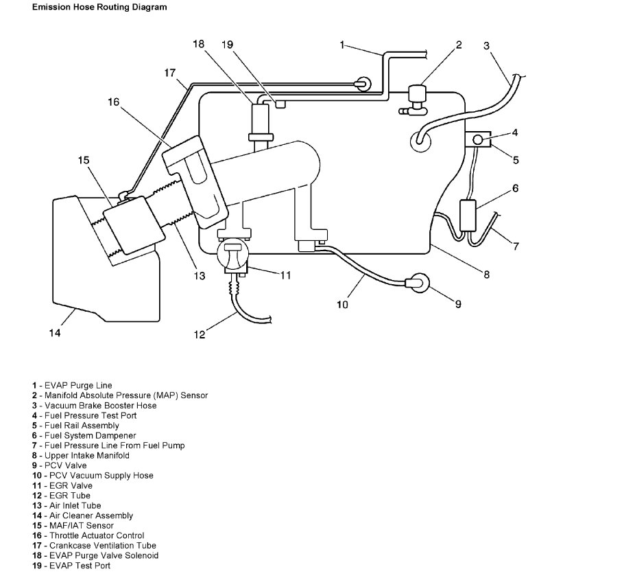

Do you guys have an enlargement of a vacuum hose diagram for this car it could be a vacuum hose I don't know I don't know where they all are. Or are there any more components that have to do with the air and gas mixture that I haven't changed? When I'm driving more than 10 mph it runs like a brand-new car, this is unbelievable. It also runs good when it's in park or in neutral only when I have my foot on the brake at a stoplight, I get the issue.

Did you find anything when using the vacuum leak guide? Here is a vacuum line diagram. Also, let's run the codes to see what comes up.

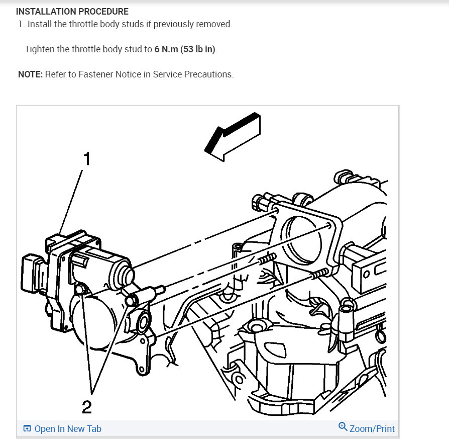

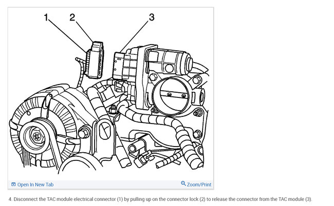

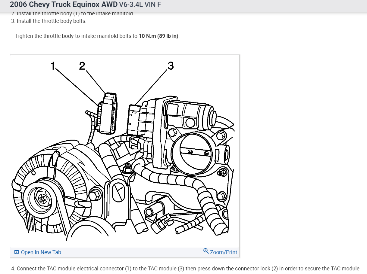

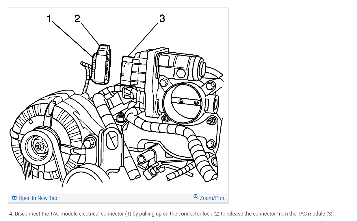

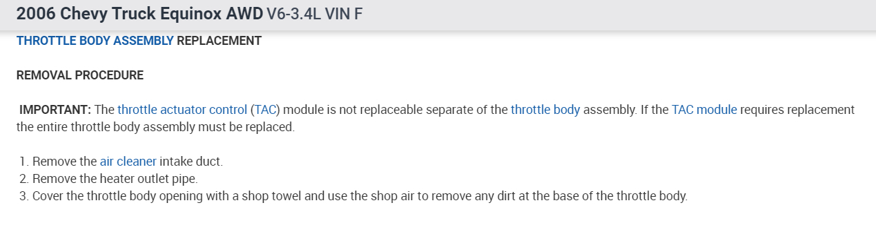

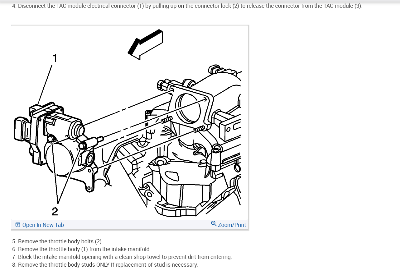

Yep, the throttle body can be bad and the TPS is internal and not serviceable. Here is the location of the throttle body. But it can be the throttle pedal sensor problem as well, have you run the codes? Check out the images (below). Please let us know what happens.

Hey, my friend, I ordered the throttle body. I'm going to put it on and reset it. With a video I seen online I hope it's correct is there anything special I need to do after I put the throttle body on I know it said disconnect the negative post and install the throttle body then then connect battery and turn the key on for a two seconds then off then on for 10 more seconds something like that I have it is that correct. I may have to Google the instructions again on resetting it. I know it was something like that, it should be here tomorrow.

The instructions are in the images above, so I think you are good there. Let me know what happens.
