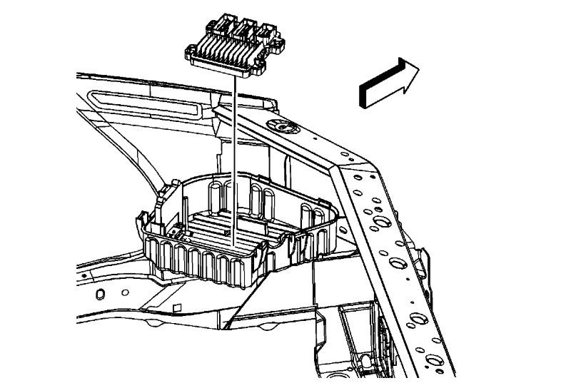

Car stalled and now won’t start. Getting engine power reduced on dash, codes p0606 and p1682. Can you help?

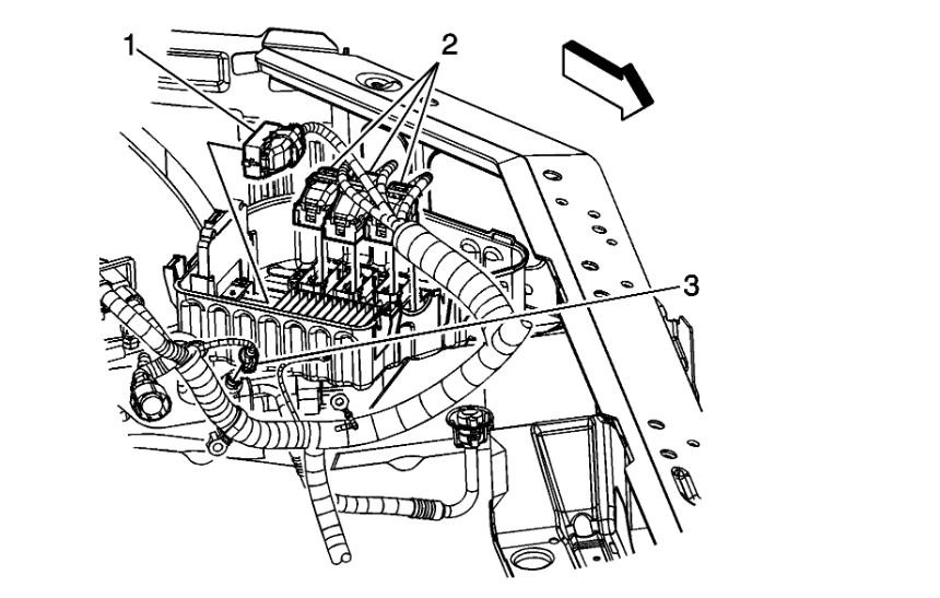

The 606 is the key. The engine control module or the ECM has failed internally and needs to be replaced. I would not even address the other code unitl the ECM is replaced and programmed.
1. Using a scan tool, retrieve the percentage of remaining engine oil. Record the remaining engine oil life, if required.
2. Disconnect the negative battery cable.
3. Remove the left front inner fender brace.
4. Remove the air cleaner assembly.
5. Disconnect the ECM electrical connectors (2).
ImageOpen In New TabZoom/Print
6. Remove the ECM from the air cleaner lower housing.
Installation Procedure
