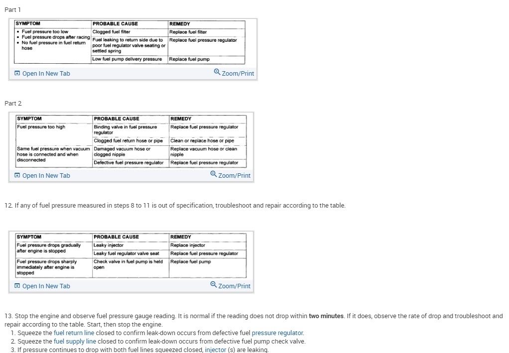

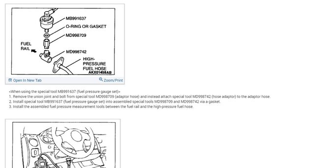

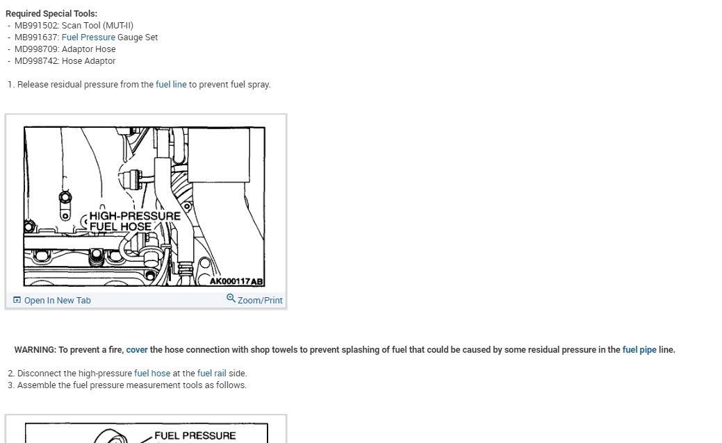

Car starts and will run fine for approximately 30 minutes. It then sputters and stalls. If I let the car cool down, it will start and repeat the above.

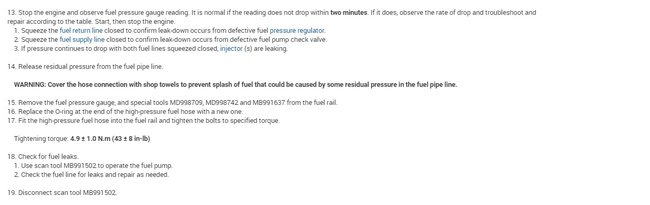

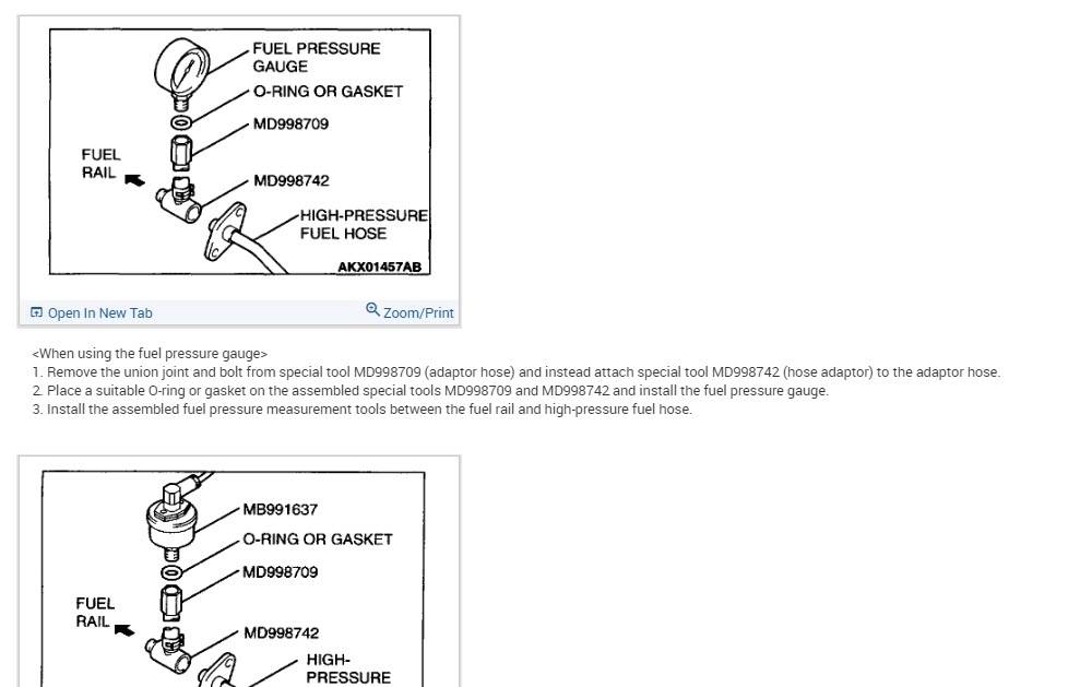

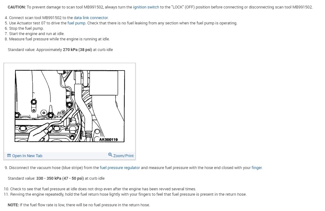

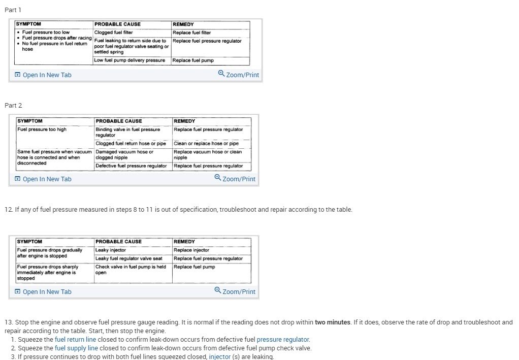

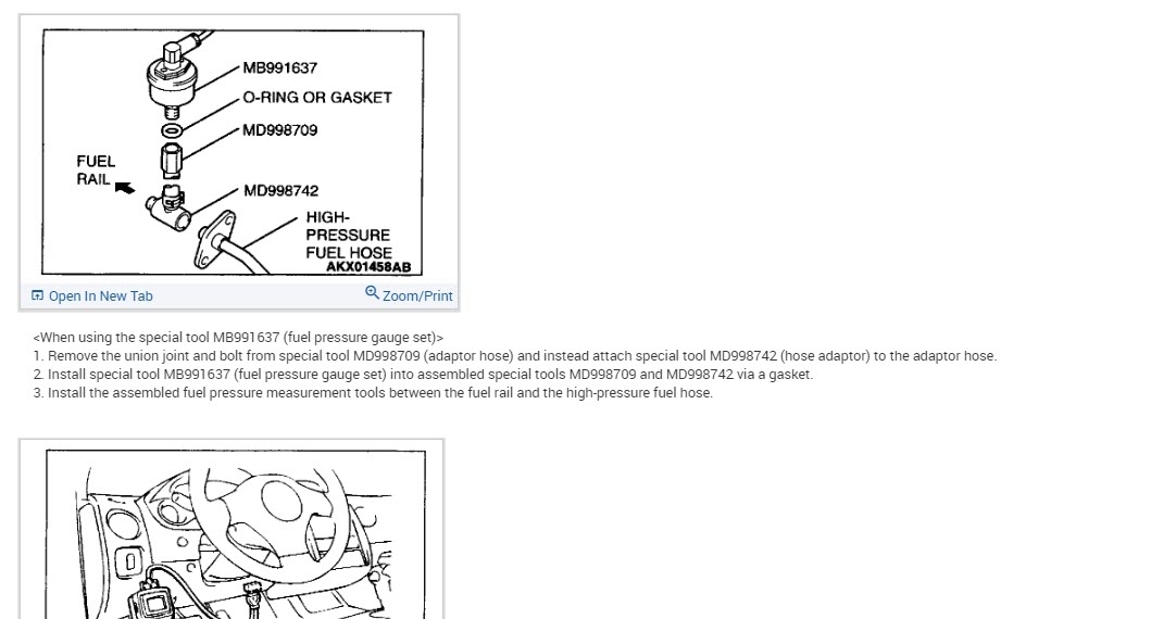

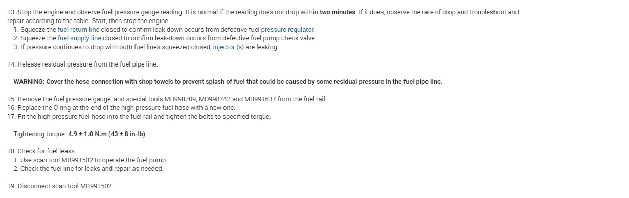

I would start by verifying fuel pressure (if you haven't already anyways). I have attached the procedure for your car if you have not done this yet.
