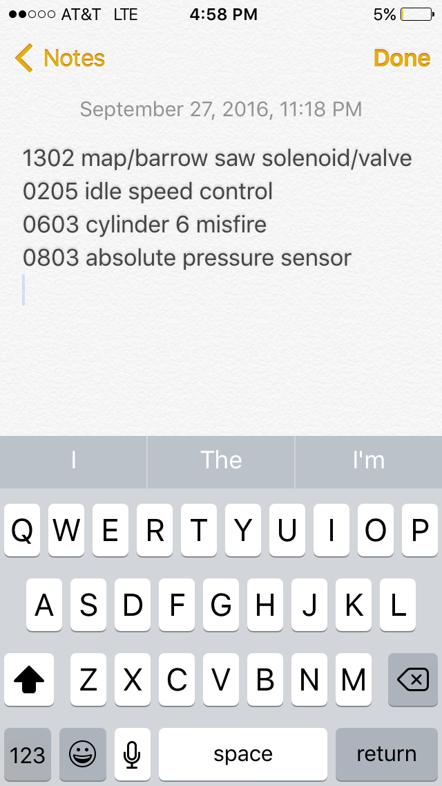

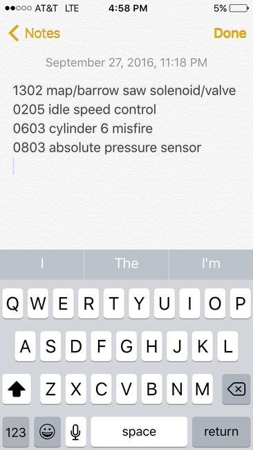

Alright I got some 4 codes from the manual cel check: 1302, 0205, 0603, 0803. Battery turns out fine after load test and for the life of me I can't get the engine to stall while idling only stalls once it's been driven for a good while. Did find an oil leak in the front valve cover gasket that drips on a heat shield only when running so I guess that's the heavy smoking right there but I'm a little lost when I tried to look up these codes

They were the codes the cel blinked when I turned the screw on the ECU. From what I read it said the long blinks were the first two digits and the short blinks were the last two. I guess they are Nissan codes? When I tried looking them up I was confused. Only one I recognized was cylinder 6 misfire. One said absolute pressure sensor and one said map/barro saw solenoid/valve. I didn't think my car had those sensors but instead has a MAF sensor. The other code said idle speed control which I can only guess is the TPS or the IACV? I took these notes when on a Nissan forum but not sure if they are correct

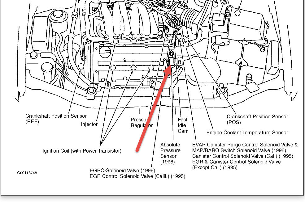

Ok I relooked in a different area and found them. One may be a vacuum leak to the ap sensor or low voltage going to it. The 303 is an O2 sensor on rh bank, but if manifold is cracked will give same reading so check for that.603 is #6 cyl misfire andwith those it's best to have a pro diagnose it so you don't spend a ton of money trying to fix it. You can check plug wire resistance and compression but I wouldn't go any further as it may be one of the sensors screwing up causing it. For idle air check to see if it' gets power and ihas a good conection you might try cleaning it with choke cleaner along with throttle plate on both sides may cure it.1302 is pmap sensor so check for a bad sensor or a vacuum leak as that can cause a misfire as well. The ap sensor can also cause this code to pop up as well. See pic for ap sensor.

Alright I tested the AP sensor with a vacuum pump and multimeter and it checks out fine. I also tested the MAP/BARRO switch for function, power, and ground. They both check out. The vacuum hose that connects both together looked fine but I had a few feet of hose lying around so I went ahead and replaced the hose and when I started the car the CEL isn't on anymore. I let it idle for a good 15 mins and it didn't come back on. I didn't disconnect the battery or reset the codes so does that mean they are truly cleared or should I drive it for awhile to see if it comes back on?
