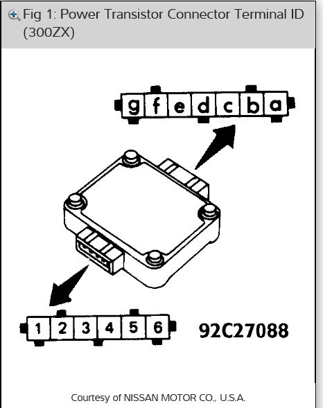

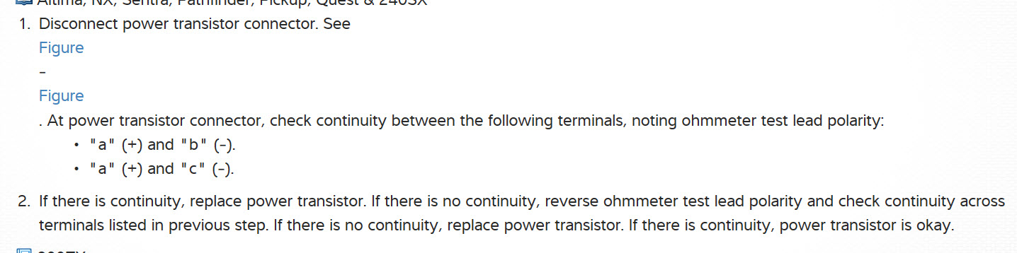

Well I'm back. I had the car running great until it got warmed up. The Tach started jumping up and down and then stalled. Waited till it cooled down and started right back up. Someone told me it sounded like the crank sensor but I don't know if it's on the top of the trans or on the bottom or if this could be my problem. Thanks for your time
Thursday, April 13th, 2017 AT 3:41 PM
GERALD WISE
  • 9 POSTS
OK The car seemed to run fine until it warms up. Then the tach will jump up and down and then stops. What do you feel could be causing this problem.
Saturday, April 15th, 2017 AT 9:10 PM
GERALD WISE
  • 9 POSTS
I meant to say the engine stops
Saturday, April 15th, 2017 AT 9:11 PM
HMAC300
  • 48,601 POSTS
Disconnect the tach wire and see if I t makes a difference then run test described in pic. Also when asking another question please repost not as a reply
