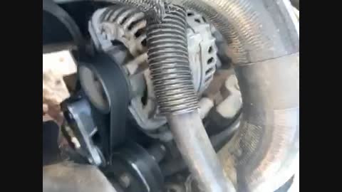

Has a little bit of trouble, and one of the pulleys is squeaking.
Tuesday, December 3rd, 2019 AT 1:49 PM
Sounds like the idler pulley. Remove the belt and spin it by hand.
What is the voltage at the battery with the engine running?

Is the idler pulley going to be the one on the right side of the alternator pulley, above the tensioner?
If so, we had just replaced it the other day.
Tuesday, December 3rd, 2019 AT 3:36 PM
Yes, it looked like the tensioner was replaced but not the idler pulley.
If it was, remove the belt and spin each component one at a time to find the source of the noise.

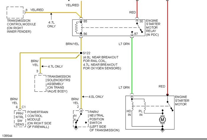

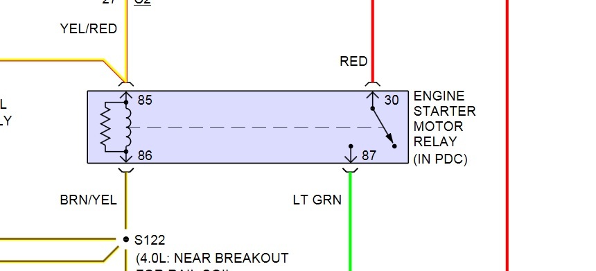

Just to add, no 6.0 so looked at 4.0L engine. Note the relay, terminal 30 is hot all the time and is fuse protected. When the relay is energized that line with the arrowhead moves to terminal 87 and voltage goes to starter. Also, red wire at starter, hot all the time
The coil side of relay to the left, also needs voltage and ground. I'm not sure about that clkicking noise either relay or starter itself.

With intermittent issues, you have to test when the problem is ongoing. Below is a wiring diagram for your starter circuit. If you have any questions about the diagram, holler. Any testing make sure the tranny is in park or neutral and the e-brake is set.
