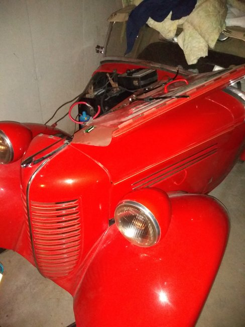

I'm trying to get my car running,
It's a 1938 American Bantam.
The issue is there are no timing marks.
You cannot use timing marks.
Timing, distributor points are at issue.
Please help,
Kenny

Kenny, this is going to be a tough one. However, lets give it a try. Since you mentioned timing marks, are you trying to install the distributor or need help adjusting the points?
If it is related to the points, I need to know engine size (how many cylinder) to determine what is called dwell. That is the amount of time the points stay open. Also, if you are working with replacing the distributor, let me know.
Any pictures you have will be helpful so I can see what you are working on. Also, please keep in mind, I have absolutely no technical information on this vehicle, so let's hope the basics get the job done. When you respond, please be as specific as you can regarding what needs done.
I will watch for your reply. By the way, this is a far cry from a Smartcar. LOL

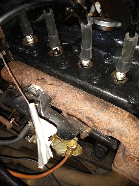

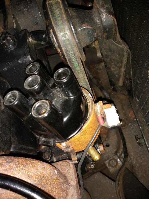

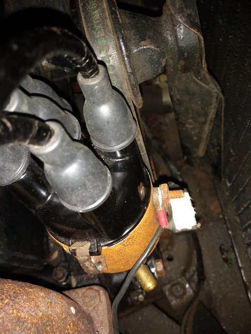

here are the pictures, I a not replacing the distributor, the car was running about a year ago.
Just trying to get it to run again. There are no timing marks, no way to put a vacuum gauge on it etc. If you need other views of the engine to make it easier to help me get the car running.
Please let me know.
Thank you, Kenny

The first thing, you need to get the plug wires to the correct cylinder. Is anything casted on the cylinder head? A standard firing order for a 4 cyl is a 1342. Do you see that anywhere?

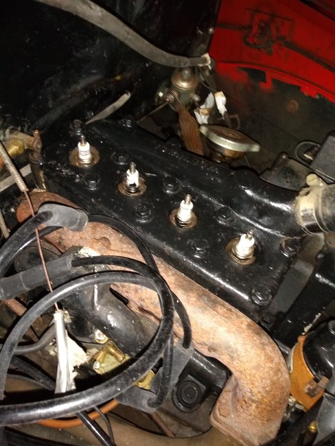

Yes, 1342 is what I have used in the past, looking at the distributor cap.
Number 1 plug is the closest one to the front of the car.
Looking at the head of the car, number one is the first plug facing the front radiator of the car.
Is this correct? See photos>

I would say yes. The closest to the front should be cylinder 1. Now, make sure the number 1 cylinder piston is at top dead center and the rotor button under the distributor cap points at the number 1 spark plug wire. Also, confirm the rotation direction of the rotor to make sure you have the wires in the correct firing order.

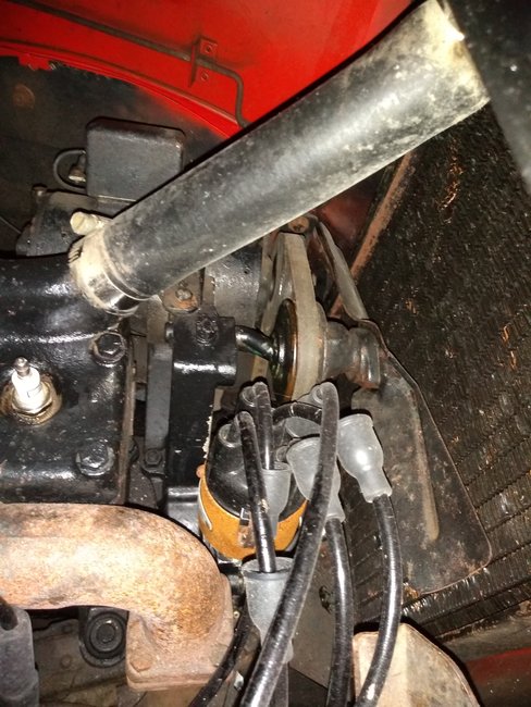

Hi I turned the engine over just to
get the rotor to match up with cap,
number one plug.
please see pictures
thank you,
Kenny
Oct 18, 2019 at 11:21 AM

Now that you have aligned the rotor button with number one on the cap, is the number 1 cylinder still at top dead center (TDC)? If it is, give it a try and let me know the results.

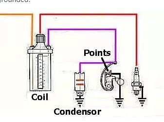

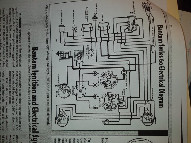

Hi, per my previous email, I am getting the low voltage from the wire to the distributor. I am not getting the high voltage from
the coil, no voltage from the plug wires.
Perhaps the below diagram will be helpful.
Thanks for your help.

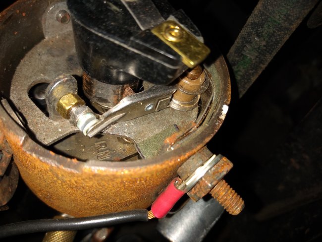

Now, I looked again at the pictures. The Is the nylon washer on the left or right of the connection? If on the right, is there any way for it to make contact? On older vehicles, often times the left side of where it bolts to the distributor is a plastic insulator. If you have the nylon washer on the right, it may not be making any connection,
It's just a thought. It's really hard for me to tell in the pic.

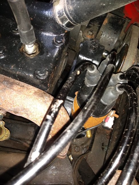

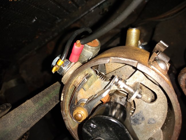

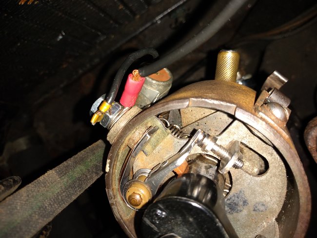

I am sending you some photos, please take a closer look at the way the points, condenser and hot wire are connected to the distributor body.
Please advise.

Picture 1 looks fine. How far do you have the points opening? You have the condenser and points tied together. I assume the wire with the red connector goes to the coil negative. Here is what happens. When the points are closed, low voltage completes the coil circuit and sends a spark. When the points open, the condenser accepts the power. If the points are not opening it won't work, and if they are always open, the condenser will get all the power.

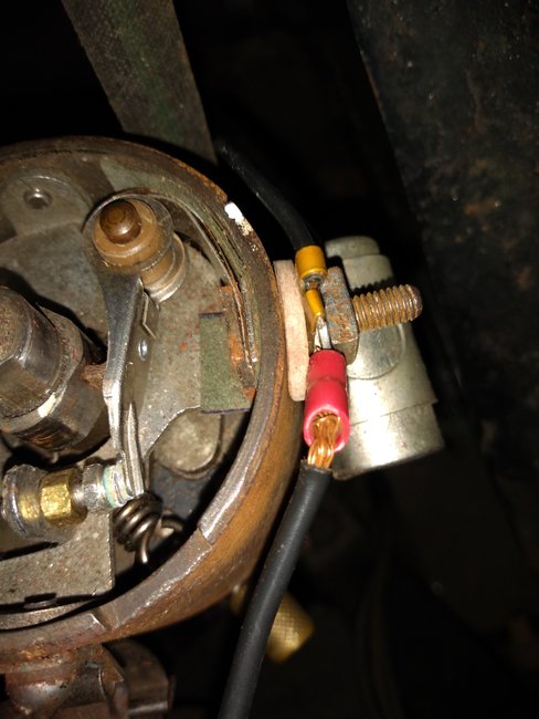

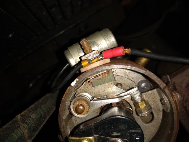

hi, The ground was on the metal of chassis.I believe its the way the points and condenser are grounded. Would you know if there is some type of gasket on the inside of the distributor, between the points and distributor wall? Also, on the outside of the distributor, how are washers, hot wire and condenser connected.
Please see photo.

I was able to track down a basic wiring schematic for points and condenser online. Note that the signal wire comes from the coil (-) where it is joined to both the points and condenser. The points are grounded through the distributor's base plate and the condenser is grounded on the distributor housing.
As far as the wiring, you can't have a spacer between the points and the base plate or you lose ground to the points.
Tell me something, by any chance does this vehicle have a component known as a ballast resister? On older vehicles (and I'm not sure about yours) a ballast resister was used to protect the points from receiving more power than was needed.
As far as the wiring on the distributor, it looks correct.

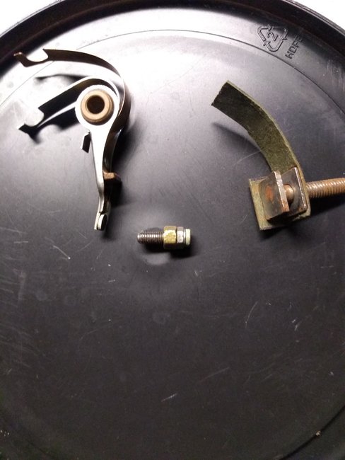

This car does not have a ballast resistor. I removed the points, they looked burnt. The question is there is a gasket on the inside where the point screw go through the distributor housing? There is also fiber washers on the outside of the distributor.
I believe the reason for electrical issues has to do with points, condenser, hot wire and fiber washers not being connected correctly.
Please see photos.

There should be something preventing them from grounding where the connection comes through. The only place that should have power is the bolt which goes straight to the points. That screw should not ground at any point. Ground for the points is through the distributor base plate.

Yes I agree, I pulled the points, getting new ones, will place fiber washers at all connecting points. Would you know if the condenser needs a fiber washer where it connects with a screw to the distributor body?

You need to make sure it isn't grounded to where it attaches with the points. So, if the wire to it is touching the side of the distributor, you need one.

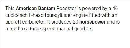

Hi, tell your brother the horse power in this engine is low, when it was running had difficulty making it up a hill.
Talking about Horsepower would, you know what the compression should be on this engine when doing a compression test?

I don't have the compression specs, but suspect around 100 psi. Take a look at the picture below. It has around 20hp. That is unbelievable.
