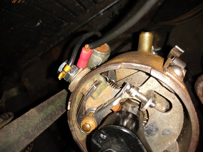

hi, The ground was on the metal of chassis.I believe its the way the points and condenser are grounded. Would you know if there is some type of gasket on the inside of the distributor, between the points and distributor wall? Also, on the outside of the distributor, how are washers, hot wire and condenser connected.
Please see photo.

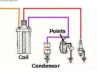

I was able to track down a basic wiring schematic for points and condenser online. Note that the signal wire comes from the coil (-) where it is joined to both the points and condenser. The points are grounded through the distributor's base plate and the condenser is grounded on the distributor housing.
As far as the wiring, you can't have a spacer between the points and the base plate or you lose ground to the points.
Tell me something, by any chance does this vehicle have a component known as a ballast resister? On older vehicles (and I'm not sure about yours) a ballast resister was used to protect the points from receiving more power than was needed.
As far as the wiring on the distributor, it looks correct.

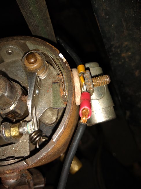

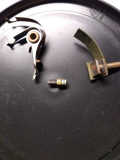

This car does not have a ballast resistor. I removed the points, they looked burnt. The question is there is a gasket on the inside where the point screw go through the distributor housing? There is also fiber washers on the outside of the distributor.
I believe the reason for electrical issues has to do with points, condenser, hot wire and fiber washers not being connected correctly.
Please see photos.

There should be something preventing them from grounding where the connection comes through. The only place that should have power is the bolt which goes straight to the points. That screw should not ground at any point. Ground for the points is through the distributor base plate.

Yes I agree, I pulled the points, getting new ones, will place fiber washers at all connecting points. Would you know if the condenser needs a fiber washer where it connects with a screw to the distributor body?

You need to make sure it isn't grounded to where it attaches with the points. So, if the wire to it is touching the side of the distributor, you need one.

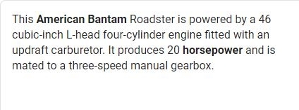

I don't have the compression specs, but suspect around 100 psi. Take a look at the picture below. It has around 20hp. That is unbelievable.

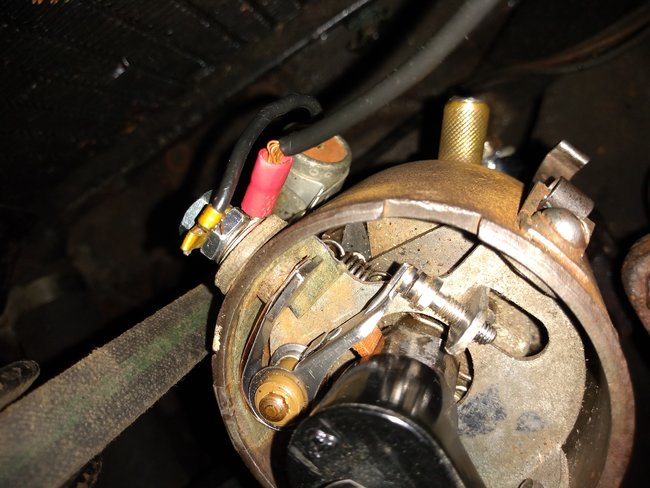

Hi, I am scratching my head. Now I am not getting any spark at all at the points. I may have placed too many fiber washers between contact points. Could you look at the photo that is attached that shows details of points, condenser and hot wire connections?
Please let me know your findings.

Joe, please read previous email. Also, I used a multi meter, grounded one multi meter wire and touched points when opened using the meter, got 8.25 volts. When points were closed there were zero volts. Also when opening and closing points I could hear a clicking sound within the coil.
