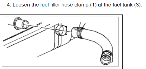

This sounds like a fuel pump is starting to fail causing the engine to stall here is a guide to confirm, please follow it and get back to me.

Thanks for the guide I checked the fuel pressure when the engine stalled and there was none then I checked for power at the pump wire and it had it what do I do now?

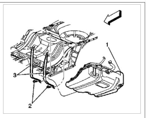

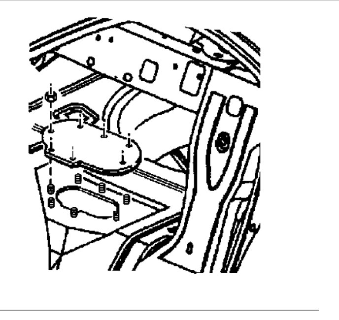

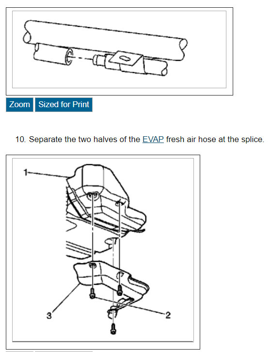

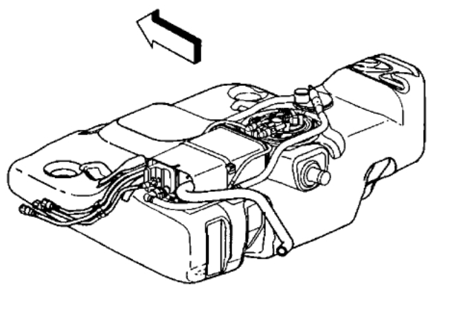

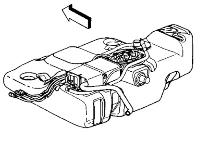

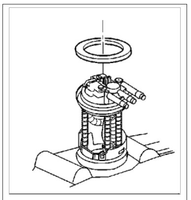

Yep, the pump has gone bad here is a guide to help you see what you are in for when doing the job.
https://www.2carpros.com/articles/how-to-replace-an-electric-fuel-pump
-1
Saturday, August 8th, 2020 AT 11:47 AM (Merged)
EDWARD F. VENN JR
Wow great job I pulled the pump and got a new one from Amazon and the car runs again, thanks for your help this site is great.
