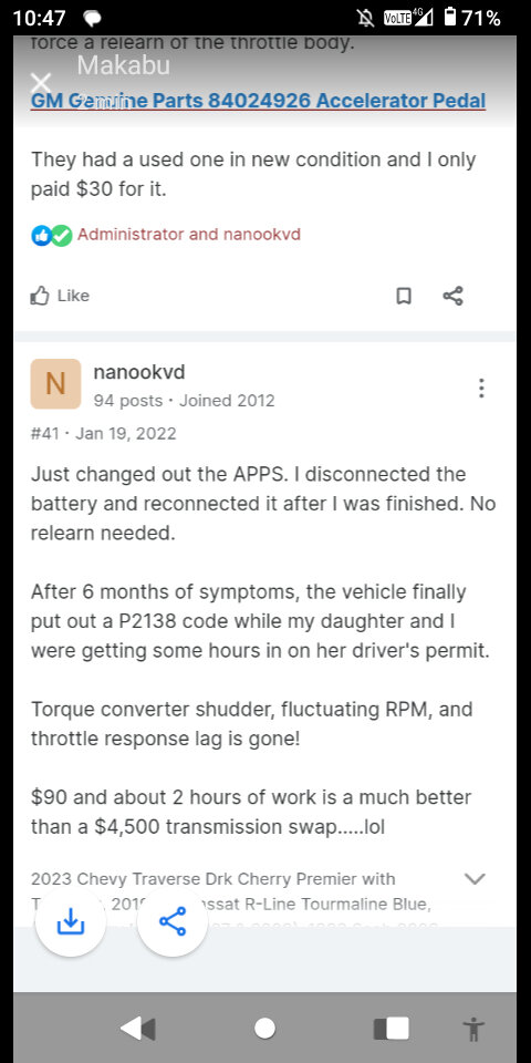

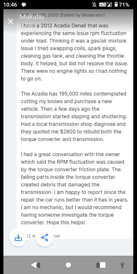

So, I've changed all the vacuum lines and everything. Do you think a new torque converter or wave plate could help with these issues?

If I'm reading the pics correctly, they appear to be for a different type of vehicle. Have you scanned your computer to see if there are diagnostic codes that will point us in the right direction? Is the transmission fluid both clean and full?

Those images a few posts back are of different vehicles but seems to be a common issue with GMC vehicles. Also, I think I forgot to mention I've read it could be the torque converter.
