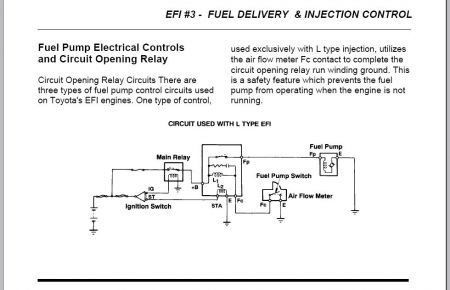

So Mechanic replaced IAC - mechanic mentions that Fuel Pump is shutting down once car heats up - but there is spark
I had the Fuel Pump replaced was under warranty as I had replaced again this past weekend - By another shop that was dishonest - they were trying to get me for diagnostic testing - Once I brought to my guy he claimed they did an abortion to the supporting are to fuel - that they didn't replace the whole assembly
Jun 18, 2020 at 2:57 AM (Merged)
  • 75,992 POSTS
Have the mass airflow meter check terminal Fc it grounds the circuit opening relay then it powers the fuel pump. also the EFI main relay.

  • 75,992 POSTS
Get the fuel pressure check-this will find problems with fuel filter,pressure regulator and fuel pump. Fuel system checks out-
Have the throttle and vehicle speed sensor/MAF tested
  • 75,992 POSTS
Weather is perfect under a coconut tree, just don't get hit with the nuts. About the situation-see below how the fuel pump gets its power source. The circuit starts at the EFI fuse/Main relay/Circuit Opening Relay/Air flow meter, then fuel pump one of this is causing the problem. If it was me I'll check the fuel pump connector 1st for power before I replace the pump. See below
https://images.2carpros.com/forum/automotive_pictures/12900_fuel_pump_1.jpg

So he has the car running for over an hour and it will not stall - so he can pin test it .Checking everything still nothing harnesses, connections, I don't know at this point
I gave him all of your suggestions
  • 75,992 POSTS
Inspect the air control valve take it out and clean it/throttle position sensor/EGR valve-and check the fuel pressure.
  • 75,992 POSTS
Tell him to direct power to the pump from the battery . positive to blue/black and negative to white/black on the fuel pump connector. Comeback and tell me what happened.
SPLANCH
  • 6 POSTS
Yesterday he checked all connections to fuel pump like you said - Had the car in the garage running for 3 Hours - no stalling - Car was blocked in as roof was being replaced - He is not sure if car didn't stall as it wasn't being driven or that it was in a warm garage
I would think if car ran that long in " Park " maybe it was a loose connection - How can you see if Fule pump was truly replaced ?
