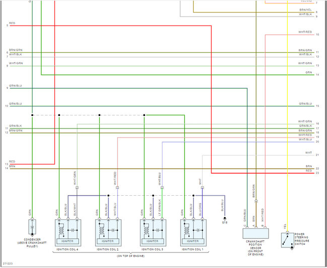

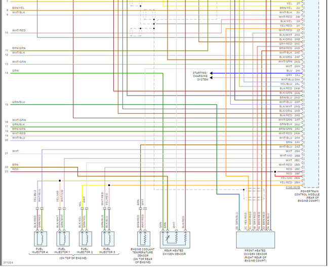

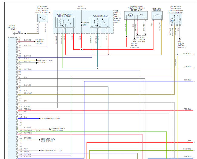

My car won’t start but cranks, the issue started after it has been stalling for while driving or at idle and codes of lost communication e.G. (U0073, U0101, U0121, U0155), and the car will start immediately if I restart it. I cleared the codes and drove for some time, it will happen again and I will start again, now it won’t start at all but cranks and won't display any codes.
Some Checks already performed are:
1. Fuel pressure
2. Coil
3. Spark plugs
4. Crankshaft sensor
5. Injectors.
6. All Air intake sensors and possible leaks
7. All relays and Fuse Checked
They all check out to be fine except when cranking, the spark plugs and Injectors do not have ground from the PCM.

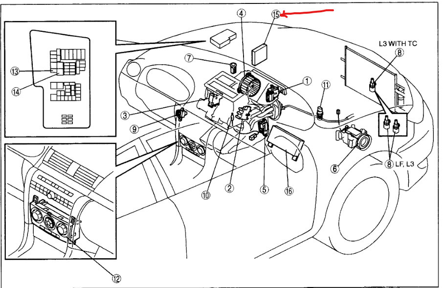

Am thinking of replacing the PCM but a check I need to perform last before that is testing the harness of the PCM to the instrument Cluster.
I need assistance for the instrument cluster terminal diagram, wiring and label to perform next check.
Thank you in Advance.

Yep, this is a controller/module problem. But, because all of these modules share data with the PCM it would be the logical first choice.
U0073: Control Module Communication Bus "A" Off
U0101: Lost Communication with Transmission Control Module (TCM)
U0121: Lost Communication with Anti-lock Brake System (ABS) Control Module
U0155: Lost Communication with Instrument Panel Cluster (IPC) Control Module

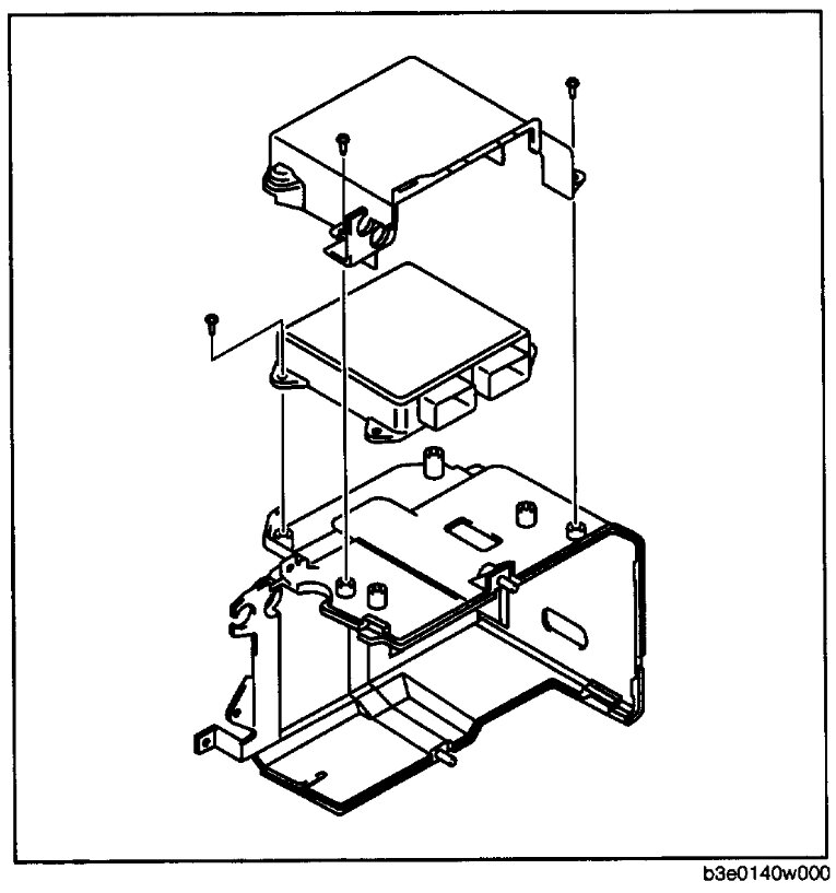

Also, the fact that when you reset the system and it starts working again says PCM as well. You can get a preprogrammed unit by searching Google or Ebay. Check out the images (below). Please let us know what happens.

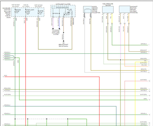

I need to verify the wiring harness and pins that connect the ignition Coil and PCM along with the Instrument Cluster.
I don’t want to rush to replace PCM.
I once had a P0606 issues and replacing the PCM couldn’t solve the problem.
I need assistance as to have the pins labelling to perform the test.
Thank you

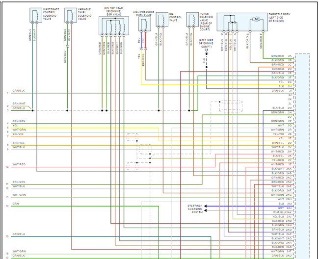

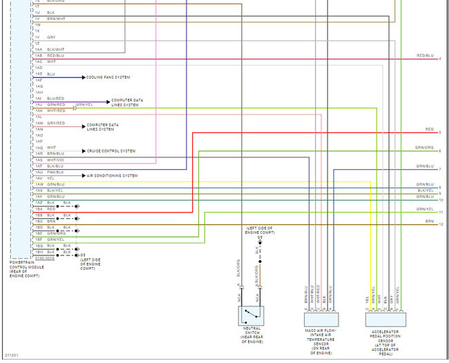

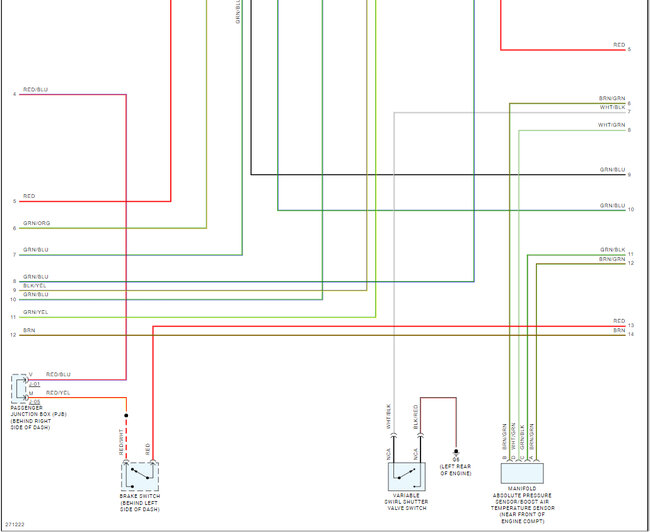

Sure, no problem, here is a guide to help you check the wiring and the engine/PCM wiring diagrams so you can see how the system works and high power and ground to check.

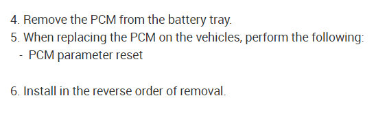

I tried my best to check the igniters wire (GRN) to the PCM socket directly and there is no continuity to any of the PIN. I don’t know if I need to check continuity through the fuse or it should be directly but I did it straight from PCM harness pins to Coil connection

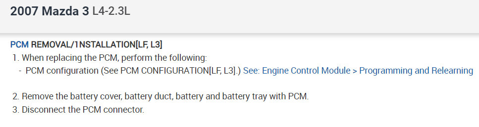

I replaced the PCM, and it couldn’t crank the car until it was programmed.
The new Scan shows all modules are okay except There’s a new code C1277 that came up under the ABS.
It keeps cranking and still no spark on the coil. Is it possible to have no spark when the timing is not accurate?
Wednesday, April 17th, 2024 AT 2:28 AM

When you crank the engine over is the security light flashing? Also, the PCM must be programmed, did you get a pre-programed unit? Sounds like the PCM was the problem because the no communication codes have disappeared.

Hello sir, the timing is actually confirmed to be very good, we changed the camshaft sensor, and the car starts to ignite but still won’t start. It also displays EGR circuit failure P0403. I removed the EGR and cleaned it and it still won’t start, I later injected fuel directly through the throttle and crank the car then the car starts, Fuel pressure is okay but the four injectors are likely not sending fuel into the chambers. I check the ground wire and PCM wires and there is continuity to both, though multimeter did not detect any voltage coming from the signal of the PCM, does it mean that the PCM is replaced earlier is bad or it requires a better programming, assist me on what to do next. Thanks a lot

I called in a CAN scanner and all there is some codes about ABS and few for instrument clusters, then we decided to try a new PCM. The car will start but won't stay idling, tried to check the issue and it was found that only Injectors nozzle 1&2 are working. The rest have no voltage on the signal wire. The car will start now if the key is turned on to ignition twice and making the third turn to a start position. But it won't idle because it lacks enough fuel distribution.

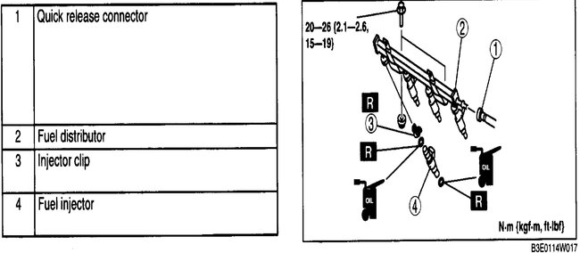

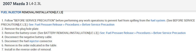

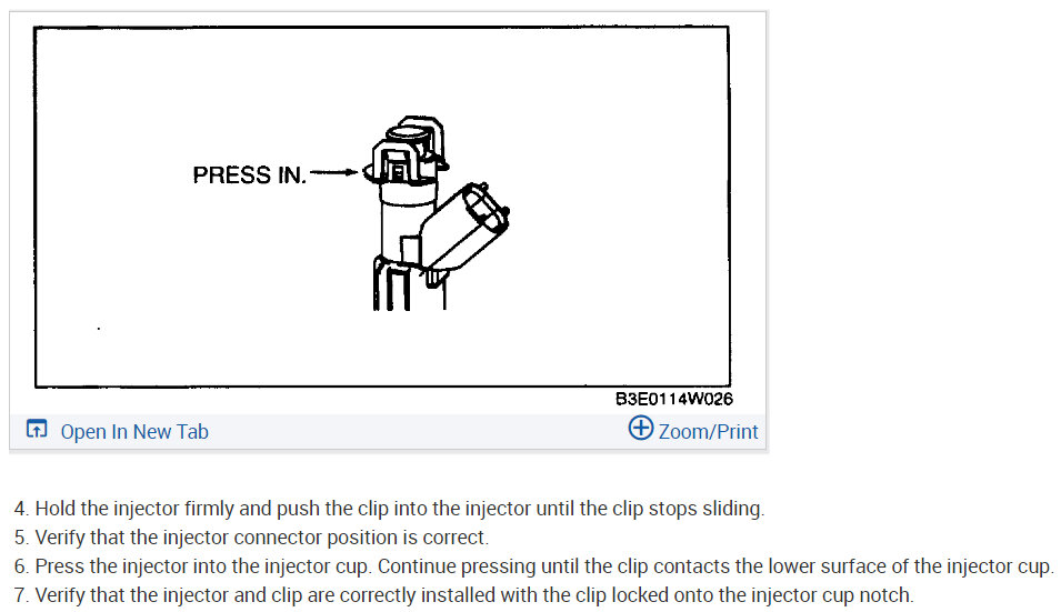

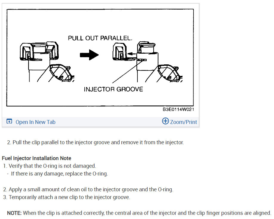

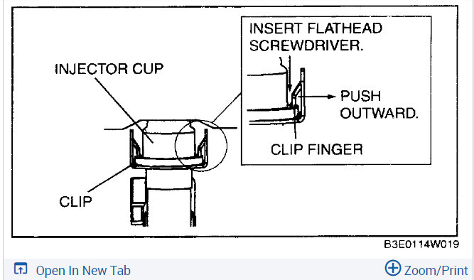

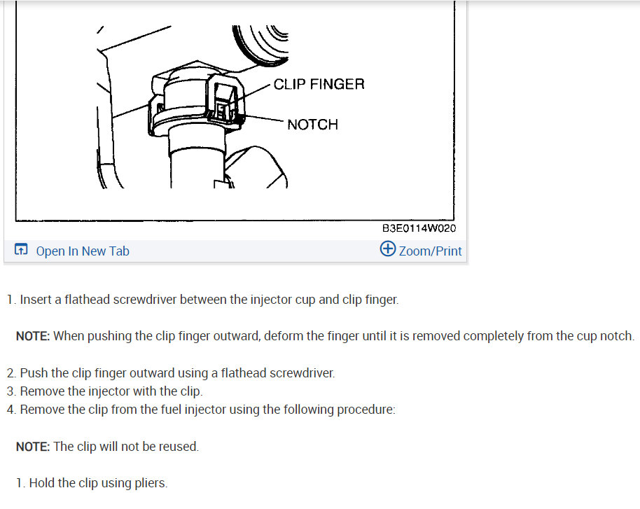

Okay, for the injectors that are not working let;s use a voltmeter to check the OHMS readings. Here is a guide that will help with the testing. If you got 0 ohms, the injectors is bad.
https://www.2carpros.com/articles/how-to-test-a-fuel-injector
A shorted injector can take out the PCM. Check out the images (below). Please let us know what happens.
Friday, May 3rd, 2024 AT 12:12 PM

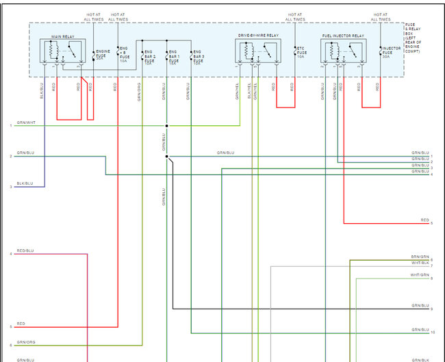

I performed the checked as you instructed. It all checked out fine. I also went ahead to perform as the workshop manual instructed and reads 12.5 ohm. What I couldn’t perfected is how to identify “MAIN RELAY terminal A”
Though I opened the fuse box under the hood by the driver side and I got continuity from some terminals including most fuses giving a beep sounds for continuity, Also checked main relay as designated on the fuse box cover label which I can’t verify if that’s the correct relay with terminal A to the Terminal B of the fuel Injector, though, one the terminals of that relay has continuity. All this test was performed without battery attached to the vehicle. Thank you.

The battery needs to be connected to the car to check for voltage. Also, was the fuel injector good?
Saturday, May 4th, 2024 AT 8:35 PM
HUDUMASAUD
  • 45 POSTS
That voltage test has been carried out since the beginning of the no crank. Though I still did it again and I got 5v on 1 and 4 but no volt in 2 and 3.
