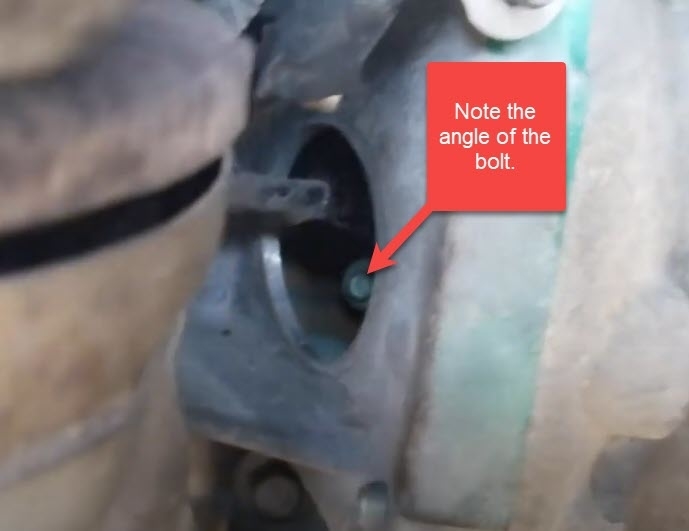

Camshaft Position Sensor Location and Replacement ?

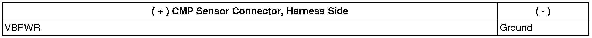

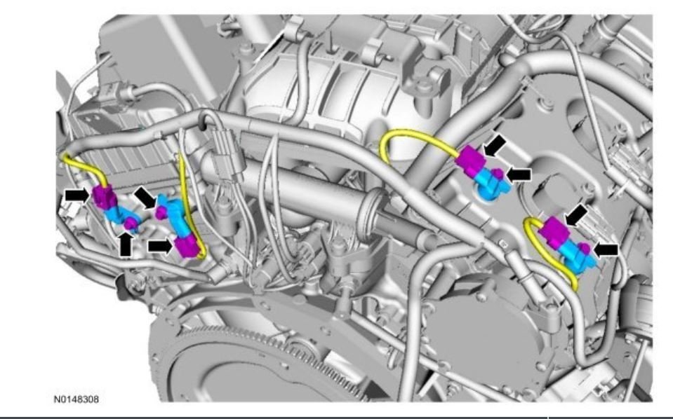

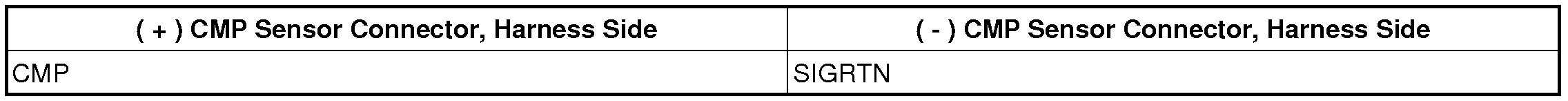

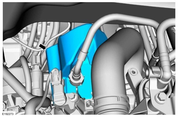

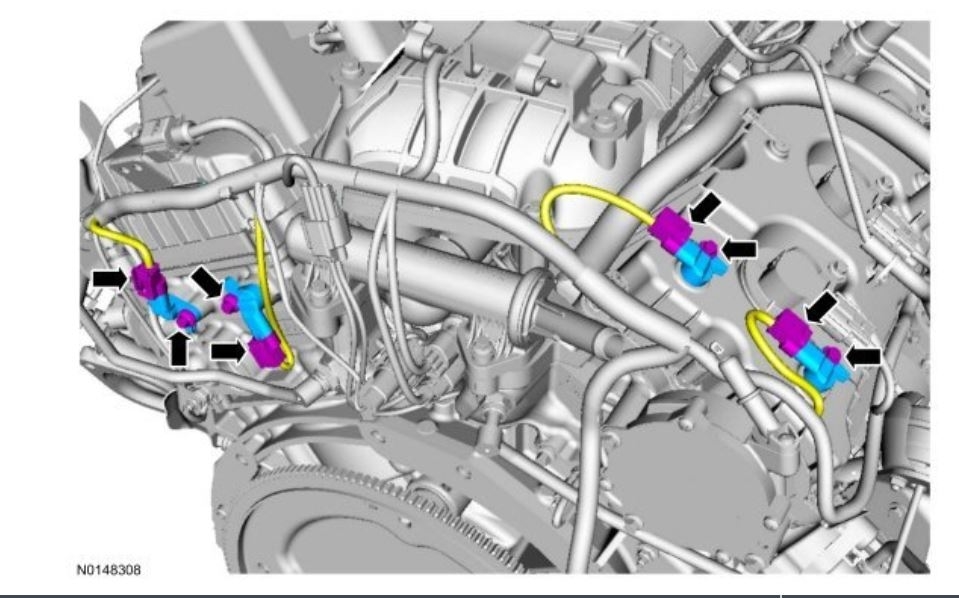

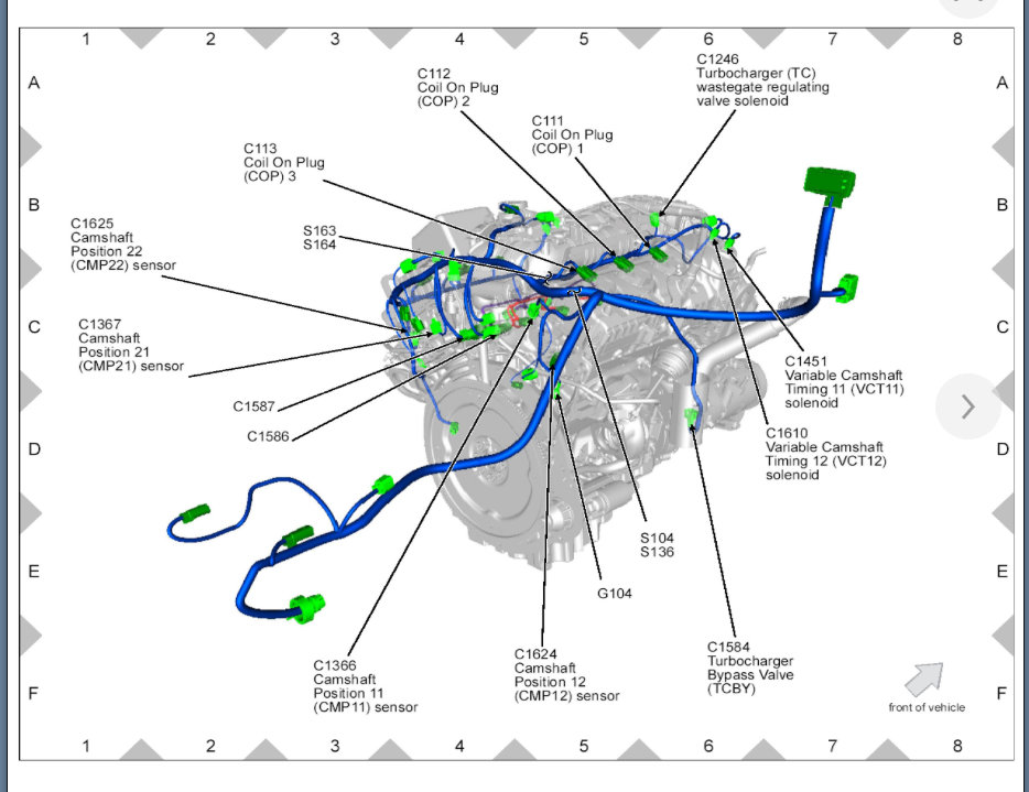

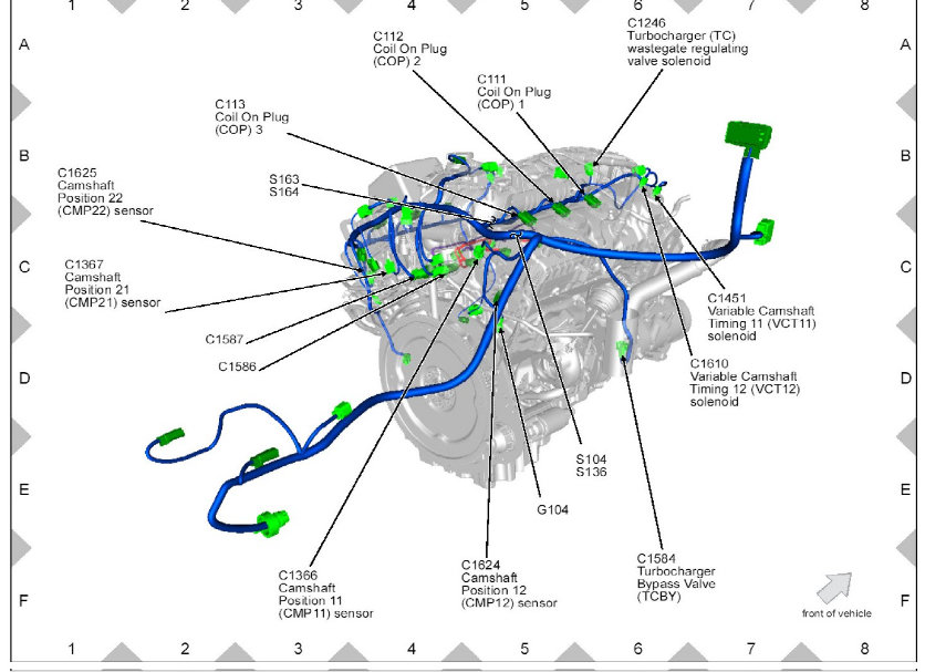

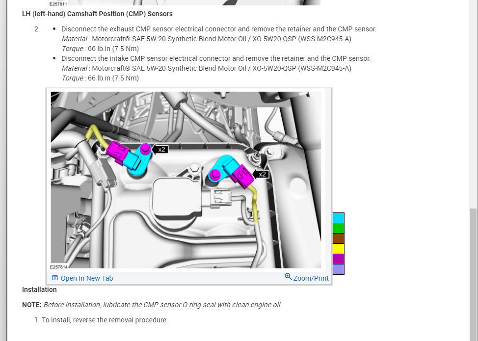

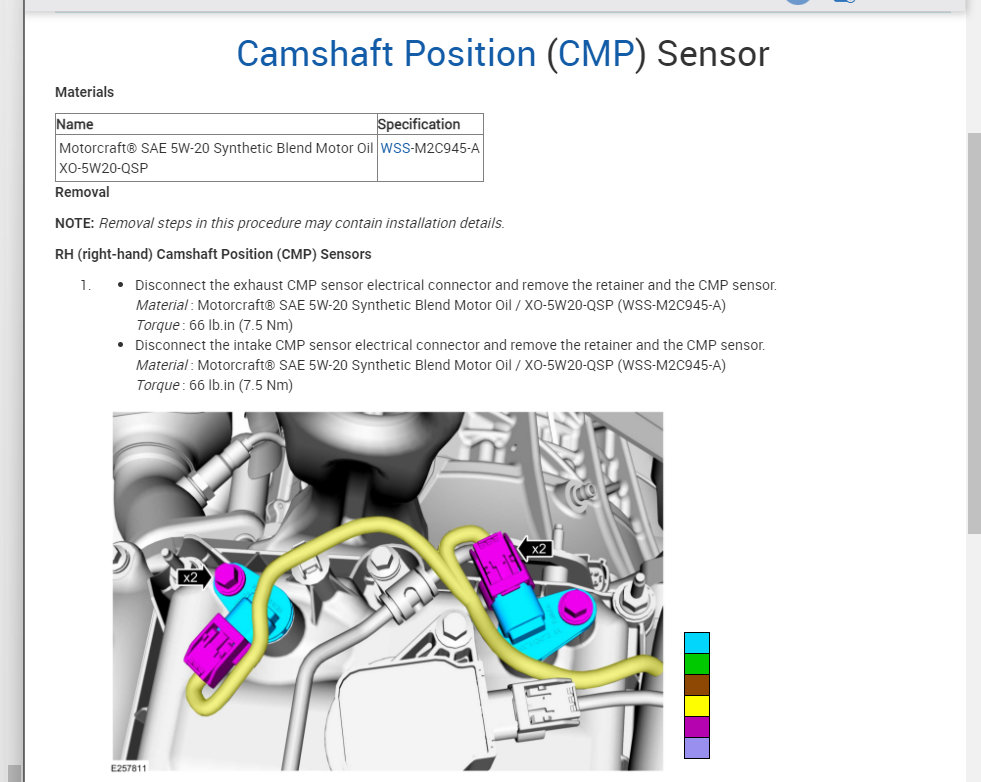

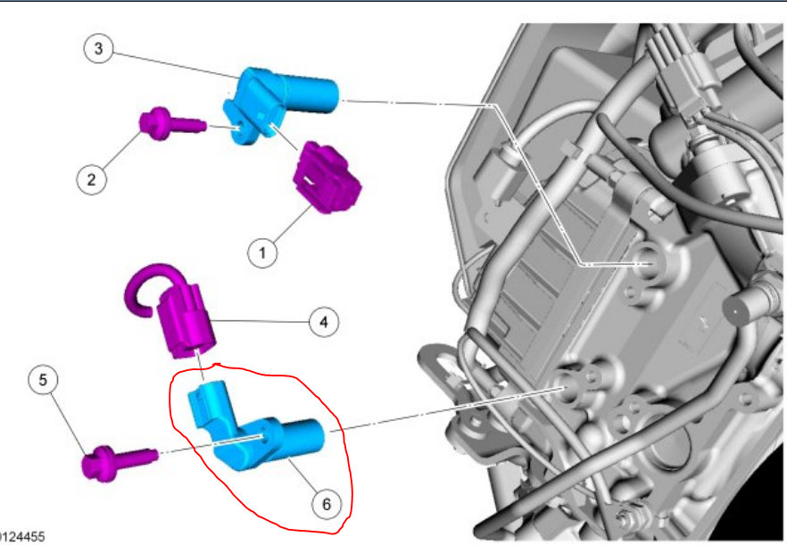

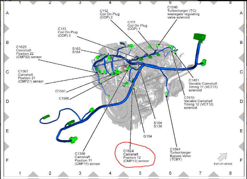

Thanks. so the shaft of the sensor doesn't go into a hole? I can see the bolt hole and prob line it up but was unsure about a hole for the shaft.
Well, I believe that I got pretty lucky overall. I'm assuming it was a mouse but it chewed on the pigtail of my wiring harness for my vacuum pump. It's going to be around $430.00 to get it fixed. Is what it is I guess.
Thanks for all the help.

Okay, thanks. just to be clear the shaft of the sensor doesn't have to fit into a hole?
Aug 21, 2020 at 2:50 PM
(Merged)
That is likely the problem. Let me know if it takes care of the issues. Darn mice! You have no idea how many times they have caused problems.

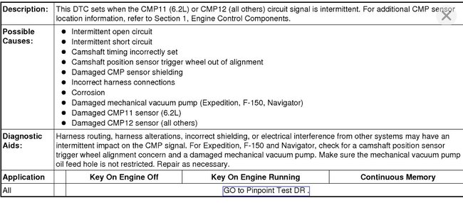

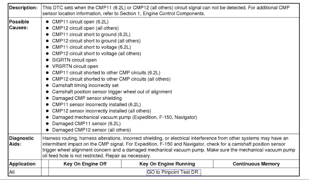

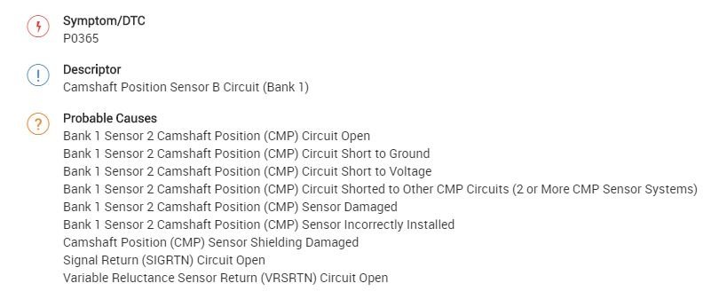

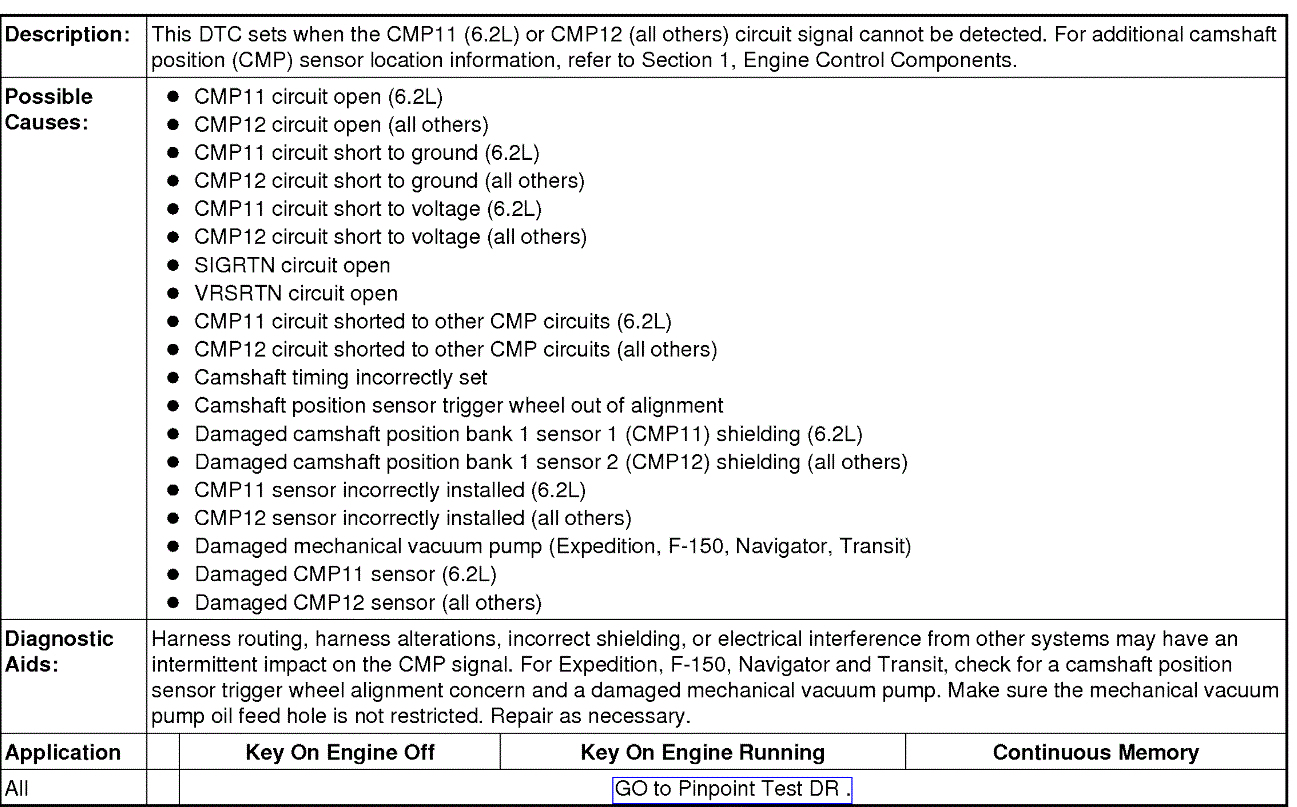

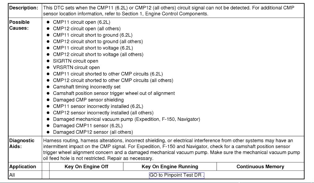

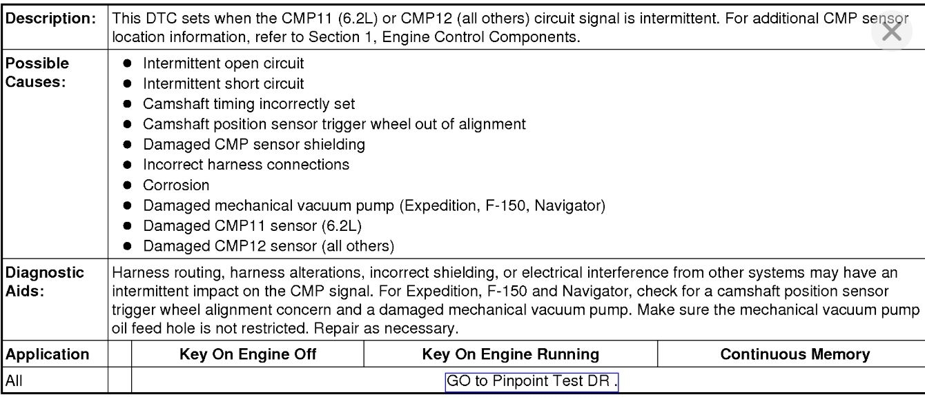

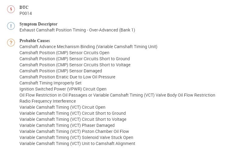

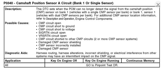

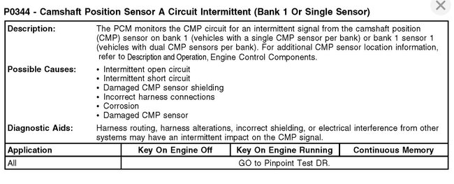

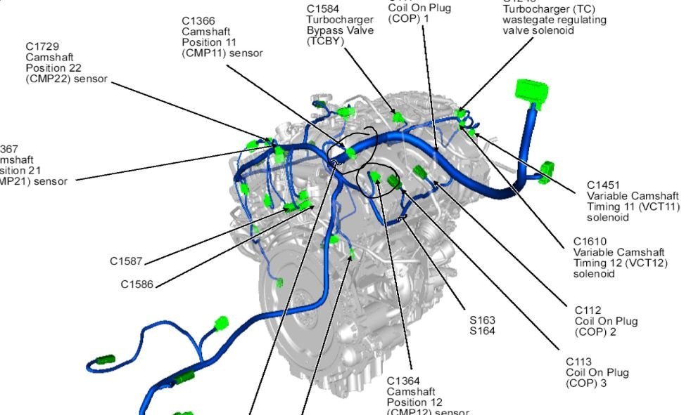

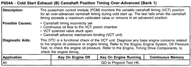

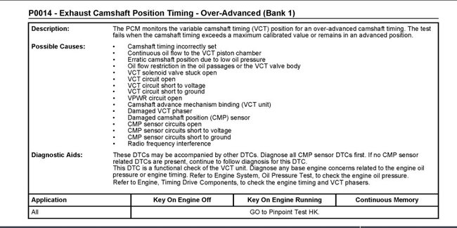

Truck stalled then wouldn't start ran odm on it came up with code P0014.
(Merged)
Good morning,
This is a complicated code as there are so many possibilities.
It could be anything from a bad timing chain to a bad guide or phaser, a clogged oil control valve from sludge in the oil to a electrical issue.
https://www.2carpros.com/articles/how-camshaft-variable-valve-timing-works

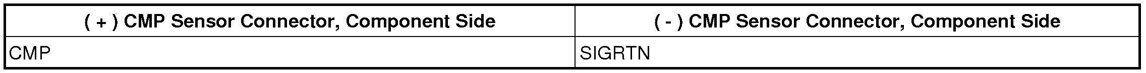

The diagnostic tree is below and you will need an advanced scan tool to monitor the system.
HK: Variable Camshaft Timing (VCT)
HK: Introduction See: Computers and Control Systems > Diagnostic Trouble Code Tests and Associated Procedures > HK: Variable Camshaft Timing (VCT) - Introduction
HK1 CHECK FOR DIAGNOSTIC TROUBLE CODES (DTCS)

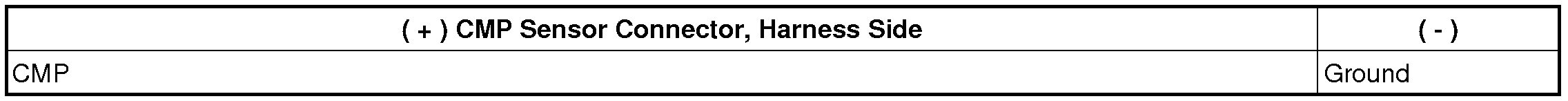

HK4 CHECK THE VCT SOLENOID RESISTANCE
Note:Diagnose the suspect VCT solenoid indicated by the DTC.
Ignition OFF.
Disconnect the VCT solenoid related to the current DTC.
Measure the resistance between:
Is the resistance between 5 - 14 ohms?
GO to HK5.
INSTALL a new VCT solenoid. REFER to Computers and Control Systems Electronic Engine Controls.
Clear the PCM DTCs. REPEAT the self-test.

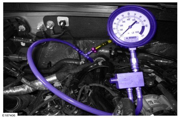

HK13 CHECK THE BASE ENGINE OIL PRESSURE
Check the base engine oil pressure. Refer to Engine, Engine System, Oil Pressure Test.
Are any concerns present?
REPAIR as necessary.
INSTALL a new VCT phaser as necessary.

HK9 CHECK THE VCT CIRCUIT FOR A SHORT TO VOLTAGE
Ignition OFF.
Ignition ON, engine OFF.
Measure the voltage between:
Is any voltage present?
REPAIR the short circuit. Clear the PCM DTCs. REPEAT the self-test.
GO to HK14.
HK10 CONTINUOUS DTCS P000A, P000B, P0011, P0012, P0014, P0015, P0016, P0017, P0018, P0019, P0021, P0022, P0024, P0025, P052A, P052B, P052C, P052D, P054A, P054B, P054C AND P054D: CHECK THE OPERATION OF THE VCT SYSTEM
Note:Some vehicles require higher RPMs and loads to actuate the VCT system than others. The VCTADVERR PID, VCT_INT_DIF PID or VCT_EXH_DIF PID should be close to zero whether actuating or not. During rapid VCT movements, the VCTADVERR PID, VCT_INT_DIF PID or VCT_EXH_DIF PID may momentarily deviate from zero.
Note:For a symptom based concern, monitor all applicable PIDs during this step.
Clear the PCM DTCs.
For Escape 2.5L, Expedition, F-150, F-Series Super Duty, Fusion 2.5L, Navigator:
For DTCs P0011, P0012, P0016, P052A and P052B,
Access the PCM and monitor the VCTADV (ANGL) and VCTADVERR (ANGL) PIDs.
For DTCs P0018, P0021, P0022, P052C and P052D,
Access the PCM and monitor the VCTADV2 (ANGL) and VCTADVERR2 (ANGL) PIDs.
For all others:
For DTCs P000A, P0011, P0012, P0016, P052A and P052B,
Access the PCM and monitor the VCT_INT_ACT1 (ANGL) and VCT_INT_DIF1 (ANGL) PIDs.
For DTCs P000B, P0014, P0015, P0017, P054A and P054B,
Access the PCM and monitor the VCT_EXH_ACT1 (ANGL) and VCT_EXH_DIF1 (ANGL) PIDs.
Access the PCM and monitor the VCT_INT_ACT2 (ANGL) and VCT_INT_DIF2 (ANGL) PIDs.
For DTCs P0019, P0024, P0025, P054C and P054D,
Access the PCM and monitor the VCT_EXH_ACT2 (ANGL) and VCT_EXH_DIF2 (ANGL) PIDs.
Drive the vehicle while exercising the throttle to generate VCT movement.
Does the VCTADV PID, VCT_INT_ACT PID or VCT_EXH_ACT PID indicate VCT movement while the VCTADVERR PID or VCT_INT_DIF PID or VCT_EXH_DIF PID maintain close to zero?
Unable to duplicate or identify the concern at this time. The concern
may have been caused by an oil flow restriction which was removed by
opening the VCT solenoid.
If the engine runs rough at idle and KOER or continuous memory DTCs are present, GO to HK12.
For all others, GO to HK11.
HK11 CHECK THE FUNCTIONALITY OF THE VCT SYSTEM
Ignition OFF.
Ignition ON, engine running.
Connect a 5 amp fused jumper wire between the following:
Does the engine reduce speed, run rough or stall with the jumper connected?
The concern is not present at this time.
The concern may have been caused by an oil flow restriction which was removed by opening the VCT solenoid.
GO to HK12.
HK12 CHECK THE FUNCTIONALITY OF THE VCT SOLENOID
Ignition OFF.
Listen for an audible click in the VCT solenoid.
Repeat as necessary to verify the VCT solenoid click.
Does the VCT solenoid click?
GO to HK13.
HK14 CHECK FOR CORRECT PCM OPERATION
Disconnect all the PCM connectors.
Visually inspect for:
pushed out pins
corrosion
Connect all the PCM connectors and make sure they seat correctly.
Carry out the PCM self-test.
Verify the concern is still present.
Is the concern still present?
INSTALL a new PCM. REFER to Section 2, Flash Electrically Erasable Programmable Read Only Memory (EEPROM) See: Computers and Control Systems > Diagnostic Trouble Code Tests and Associated Procedures > Flash Electrically Erasable Programmable Read Only Memory (EEPROM), Programming the VID Block for a Replacement PCM.
The system is operating correctly at this time. The concern may have been caused by a loose or corroded connector.

Need the position for the sensor listed above for bank 1, passenger side.

Codes P0340 and P0344.
(Merged)
340 possibilities. I listed the possibilities below. It looks more electrical than a sensor.
If you have a scan tool, you can monitor the cam sensor readings while the engine is running to see if there is a signal being sent to the PCM.
Symptom/DTC P0340
Descriptor
Camshaft Position Sensor A Circuit (Bank 1 Or Single Sensor)
Probable Causes
Camshaft Position (CMP) Circuit Open
Camshaft Position (CMP) Circuit Short to Ground
Camshaft Position (CMP) Circuit Short to Voltage
Camshaft Position (CMP) Circuit Shorted to Other CMP Circuits (2 or More CMP Sensor Systems)
Camshaft Position (CMP) Sensor Damaged
Camshaft Position (CMP) Sensor Incorrectly Installed
Camshaft Position (CMP) Sensor Shielding Damaged
Signal Return (SIGRTN) Circuit Open
Variable Reluctance Sensor Return (VRSRTN) Circuit Open
344
Symptom/DTC P0344
Descriptor
Camshaft Position Sensor A Circuit Intermittent (Bank 1 Or Single Sensor)
Probable Causes
Corrosion
Harness Connections Incorrect
Intermittent Open Circuit
Intermittent Short Circuit
Flow chart for the codes.

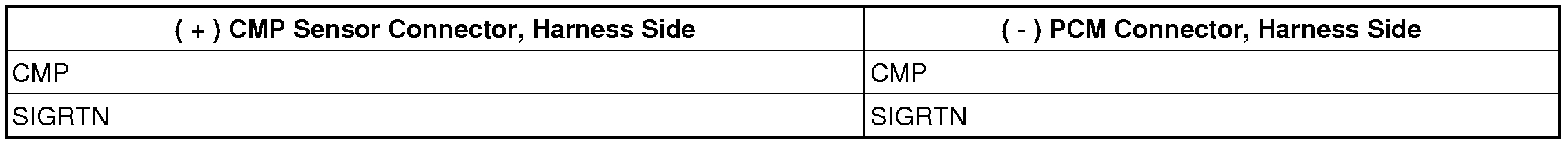

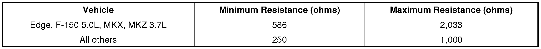

DR4 CHECK THE CMP SENSOR RESISTANCE
Note:Diagnose the suspect CMP sensor indicated by the DTC.
Note:Only measure the circuits that apply to the vehicle being diagnosed.
Symptom/DTC P0340
Descriptor
Probable Causes
344
Symptom/DTC P0344
Descriptor
Probable Causes
Corrosion

Trying to find camshaft position sensor locations?
Aug 21, 2020 at 5:36 PM
(Merged)
Looking for the location of the two sensors listed above. I can't determine where they are and which side is which, nor can I find any diagram showing me where they are.
(Merged)
The repair manual gives instructions to remove the transfer case, but I have done this from the top side. I pulled up a view with the valve cover off because there are no clear illustrations that show this, backside of the driver side head. One 8mm bolt holds each sensor in, so a shallow 1/4 drive 8mm socket and ratchet should get it done.

Had a P054a code . Can't find the location of the exhaust (B) camshaft position sensor bank1. Please send pictures or very good description of location. Thank you in advance.
(Merged)

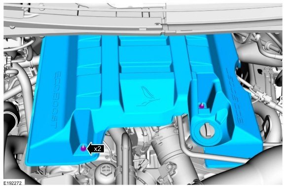

Hello, I'm Danny.
That sensor will be located on the right side (passenger) cylinder on the back of the cylinder head at the bottom. Here is a tutorial showing how to replace:
https://www.om2carpros.c/articles/camshaft-angle-sensor-replacement
I've attached pictures below, However this is the left side. Similar picture but yours will be on the opposite site.Circled in red.Hope this helps and thanks for using 2CarPros.

Trying to locate camshaft sensor bank 2 sensor B on a 2018 Ford F 150. Please help!
Dec 28, 2021 at 8:20 PM
Can you be more specific on which engine? You have 5 options but more than likely you have a 5.0L so I attached the info on these sensors.
Plus, here is a guide that will help with this that has some good info:
https://www.2carpros.com/articles/camshaft-angle-sensor-replacement
Please see the info below and let me know what other questions you have. Thanks
