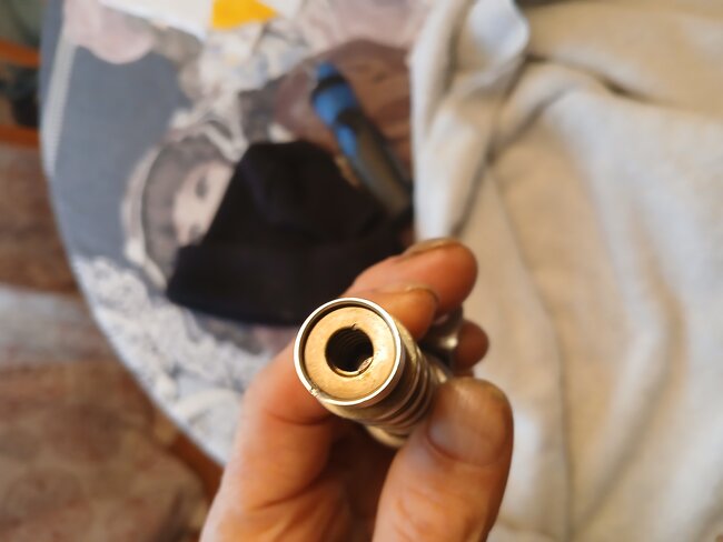

I don't know how to find where the steel ball came from I will check my lifters and make sure they're all okay and then if they are is it safe for me to finish. You can put the Cam's back in and set the timing put the timing cover on fit it with all and just see what happens I mean what would you suggest I do

I'm going to send you a picture of the oil control valve can you tell me if it looks right there should be a cap on the end of this valve with a 1/8 still check valve behind it I don't know if that's right or not I'm asking you
Sunday, January 25th, 2026 AT 11:34 AM
BMCREYNOLDS389
  • 30 POSTS
Is there supposed to be a steel ball in the end of that ocv valve a check valve
Sunday, January 25th, 2026 AT 11:35 AM
STEVE W.
  • 15,613 POSTS
Should be an open hole with a spring up inside the bore, which it looks like it has. I doubt it is any of the gallery plugs, they are normally in there real good and then the bore gets peened so they cannot get out. I would fill it, prime it and continue on.
