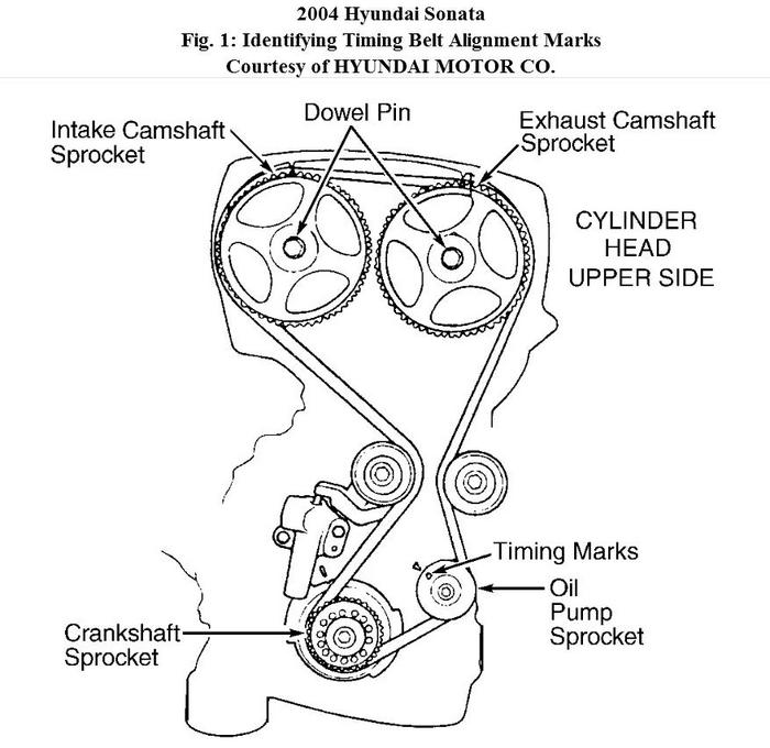

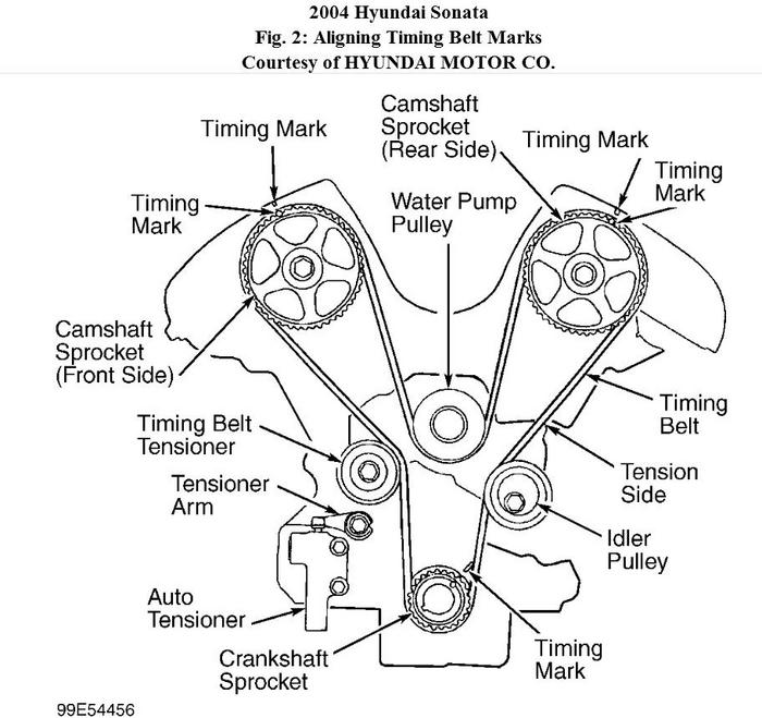

I replaced belt, I need information on timing marks.
Tuesday, October 27th, 2020 AT 4:08 PM (Merged)
KHLOW2008
  • 41,814 POSTS
I do not know which engine you have so here are 2 diagrams.
For 2.4, there is an additional balancer belt which has to be timed correctly.
