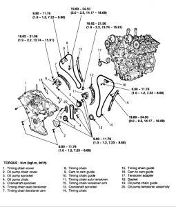

Does a 2006 Hyundai Sonata V6 have a timing chain or a timing belt?

You have a timing chain-see below:

Thanks for the quick response. I will show the diagram to the dealer who wants to replace the timing belt at 60,000 miles.
