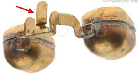

I have a new carburetor that is a remake of the carter bbd on my vehicle. I have timing set to 9 BTDC. I am trying to tune the idle on the carburetor, but the highest vacuum I get is with the mixture screws all the way in (lightly seated). When the mixture screws are all the way in it reads 20 and has the smoothest idle. This should not be happening. Why is the engine idle not peaking at a point well before the idle mixture screws are turned all the way in? What is causing this to happen?

You are making the mixture too lean. That is similar to having a vacuum leak. With a vacuum leak, idle speed will go up, but without a corresponding increase in power. In fact, if you go out and drive it, you are likely to find it will fall flat on its face when you try to accelerate off of idle.
I never heard of using vacuum readings to set the mixture. Normally we would run one screw in until the engine began to run rough, run it out until it started to run rough again, then put in it the middle of those two settings. Those mixture screws are only for at idle and very low speeds. For mid-range and highway speed, the jets and rods control the mixture. You can also tweak the mixture by adjusting the floats a little higher or lower. If those are too high now, it could explain why you cannot get it to go lean enough to misfire now at idle. It sounds like by running the screws all the way in, you are just coming up on the correct mixture, but you should be able to go beyond that to where you get lean misfires.

Remove the six screws on top, then lift the cover off. The accelerator pump piston will come with it. As I recall, I think you will need to unscrew the inlet valve for clearance. The float is held in place with a 1"-long metal rod. Pull up on the silver horseshoe-shaped metal strip. Once the inlet valve is out of the way, the float just lifts up. My nifty red arrow is pointing to the tab to adjust to change the mixture.
Making this adjustment is impossible by eye because a very tiny change makes a big difference in the mixture. If you get it too high, the float will hit the cover before it pushes the inlet valve closed. That will result in gas overflowing into the intake manifold.
The rebuild kits used to come with a hard paper gauge for checking the float height, but I never had much luck with them. If you clamp something to the bowl to hold the metal strip in place, which holds the float's pivot rod in place, you can run the engine with the cover removed. You cannot adjust the mixture this way with an exhaust gas analyzer because some extra gas will enter through the accelerator pump's port. All you can do this way is observe the height the float is sitting at, and you can adjust the tang on the float to change its height. This will get a little messy because the gas will spray from the inlet valve. When I did this, I would hold the float's tang against the valve to keep the valve closed, then wait for the gas in the bowl to be used up. Wait for the engine to stall, or have a helper stop it. Release the float, then make the adjustment. Only a few drops of gas will run in once the fuel pump is no longer running.

Since this is a new carburetor, I would be very surprised if the float is set wrong.
There was a procedure that involved introducing an artificial lean and rich condition, but that was something I never got involved with, and few mechanics ever did. The lean condition was created by removing a small vacuum hose, and the rich condition was to inject propane into that hose. You can find this procedure in older Chrysler service manuals from the late 1960's and early 1970's.
I think what I would pursue is what I mentioned earlier about setting the mixture screws midway between the two points where the engine runs rough. In this case you cannot reach one of those points, so I would start with each screw out one turn, then see how the engine performs. The mixture screws only pertain to idle and the transition to off-idle, not highway speed.
