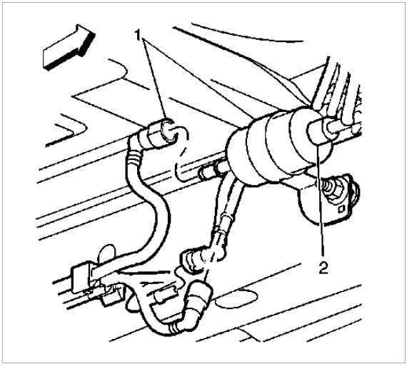

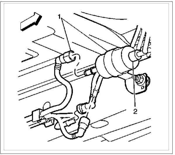

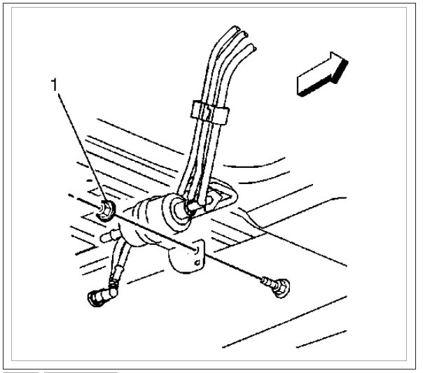

Engine Performance problem 6 cyl All Wheel Drive Automatic 111205 miles
Can you please tell me where the fuel filter is located I've looked along the frame and can't find
Jul 18, 2009 at 12:55 PM
  • 54,161 POSTS
The fuel filter is located on the frame rail on the drivers side under the drivers seat. You will need to raise the car up safely before you begin.
Here is a guide that will give you an idea of what you are in for when doing the job.
https://www.2carpros.com/articles/how-to-change-a-fuel-filter
Here are some diagrams (below) of what it will be like on your car
