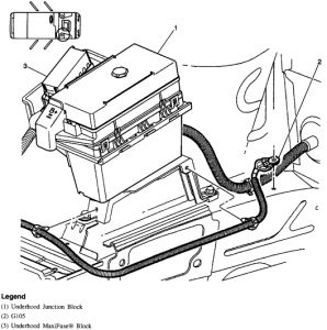

  • 75,992 POSTS
Hi chrispitman,Welcome to 2carpros
Underhood Junction Block -Locations
RH Front Of The Engine Compartment
https://www.2carpros.com/forum/automotive_pictures/12900_f1_22.jpg
RH Of The Engine Compartment
https://www.2carpros.com/forum/automotive_pictures/12900_f2_22.jpg
IP Junction Block -Locations
Behind The RH Of The Instrument Panel
https://www.2carpros.com/forum/automotive_pictures/12900_f3_11.jpg
Rear Junction Block
Under The Rear Seat
https://www.2carpros.com/forum/automotive_pictures/12900_f4_6.jpg
Center right hand rear of the passenger compartment, under the rear seat cushion
