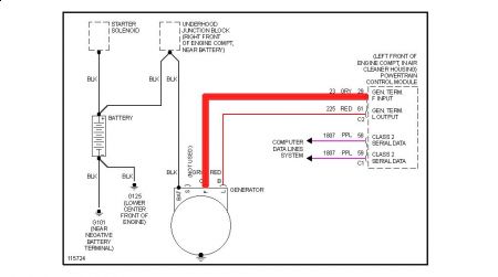

Does it damage the car's electrical system if you disconnect the battery while the car is running?

It will you're creating an open circuit-If you're checking the alternator if its working use a voltmeter

I have always wondered about that. I appreciate your assistance. The reason I was asking was for a constant flickering of interior and exterior lights while driving down the road.
Again, I appreciate your help!

https://www.2carpros.com/forum/automotive_pictures/12900_charging_1.jpg
