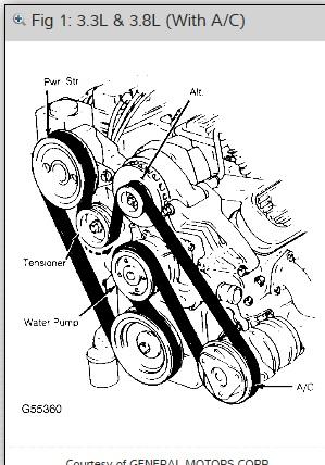

How do I adjust the belt tension pully on a 1990 buick lesabre, 3.8l engine?

Sorry for the late reply.
With serpentine belt, you have to check if tensioner is out of range, there are usually marks for the tensioner range. If the tensioner is the problem have to replace.
