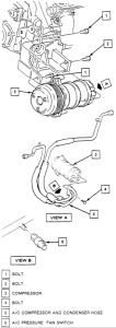

Re 3.8 L Engine. Getting noise from A/C compressor area and am assuming that either the clutch is bad or the compressor is bad. Since I am getting cool air from the vents, my best guess is the clutch or a bearing problem. In any event, I have to remove the compressor/clutch assembly. My question is, since I don't have a book, what is the recommended procedure for removing the compressor?

Compressor Replacement
Hi rsukovich, Welcome to 2carpros and TY for the donation this what keeps the site going
Compressor And Mounting
http://www.2carpros.com/forum/automotive_pictures/12900_comp_4.jpg
REMOVE OR DISCONNECT
Recover refrigerant from A/C system, Refer to Refrigerant Recovery and Recycling. See: Service and Repair
Serpentine drive belt.
Front upper mounting bolt.
A/C compressor splash shield.
Electrical connections from compressor.
Bolt attaching A/C compressor and condenser hose to rear of A/C compressor.
Remaining compressor bolts and compressor. INSTALL OR CONNECT
Rear and lower front mounting bolts after positioning compressor (hand tight).
Lower vehicle.
Front upper mounting bolt and torque all bolts to specification.
Tighten Rear bolts to 26 Nm (20 lb. ft.) .
Tighten Front bolts to 50 Nm (37 lb. ft.) .
Raise vehicle.
A/C compressor and condenser hose to rear of compressor and attaching bolt.
Tighten Bolt to 23 Nm (17 lb. ft.) .
Electrical connections to compressor.
Evacuate, charge, and leak test A/C system.

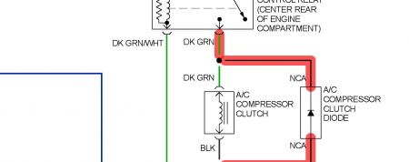

I got the compressor back on and I got a connector left over it's red and looks like 2 contact and very short as if the only place it could go is in the back of the compressor somewhere. Or it might just be one of those hanging conncector that would have gone to an accessorie somewhere. I guess my question is how many electrical connections are there to the compressor other than the one that is connected for the clutch?

Bob,
At the AC magnetic clutch wiring connector do you see a dark green and black wires if so disconnect the connector and check for power on one of the contacts on the red wire-this wire could be the clutch diode-Let me know or do a continuity test on it with the dark green wire on the clutch -should have continuity if so its the diode-its somewhere around that area-

OK. I'll do that. The wire that I speak of that is terminated with a red connector is only about 3" and if it plugs in anywhere, it has to be at the back of the compressor somewhere where I don't see any place for it to go.

Is this the same compressor? If so inspect the wire if something is connected to it that broken off-if so could be the diode

That leftover wire goes to a diode both manual and auto system has the same wire color attached to a diode

Both Manual or Auto should have that diode and its wired parallel to the clutch could be attached to the compressor housing with that length-Remanuactured who knows they didn't put one on to connect to. Or it just hangs there as pigtail wrapped with elect tape-I'm using Mit1 and Alldata auto references and still coming up with the same information.

Your are absolutely right! And so was I, to some extent. First of all, I'm missing a switch which goes on the back of the compressor and the reman doesn't supply it with the part and I should have taken the old one off of the one I turned it. Now how the hell am I supposed to know that? I thought when they reman something they would do the whole thing. You were correct in your analysis and I was correct that they just plug up areas and black paint over everything, but instead of using a plastic caplug, they use a metal plug and hold it in with a snap ring. The switch doesn't cost a lot (about $17.00), but it's the principal of the thing and it's something that the guy at the auto store should tell people. Anyhow, thanks for your help and I think installing the switch should solve the problem I'm passing all of this on to you with the thought in mind that it might help you in other case like this. Have a good day. Bob
