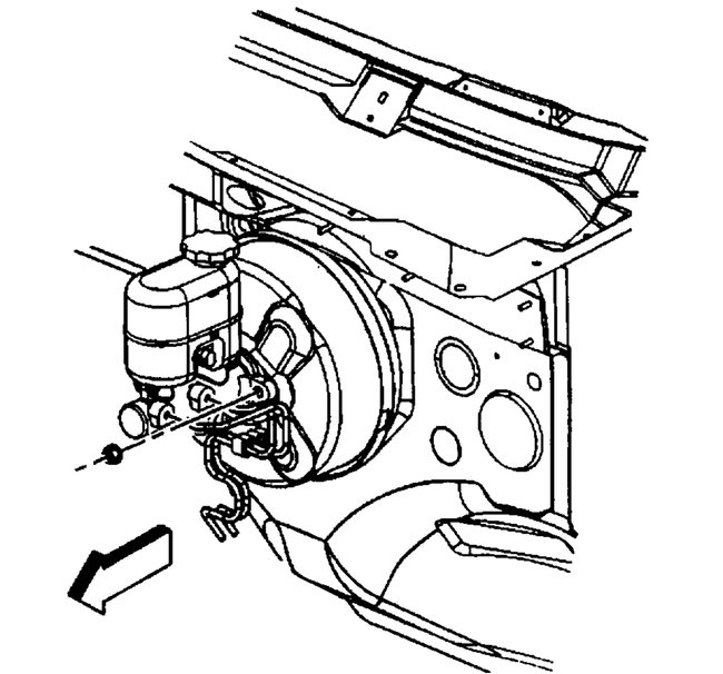

The picture bellow shows the vacuum brake booster with the brake master cylinder, the brake fluid reservoir is on top of the master cylinder.

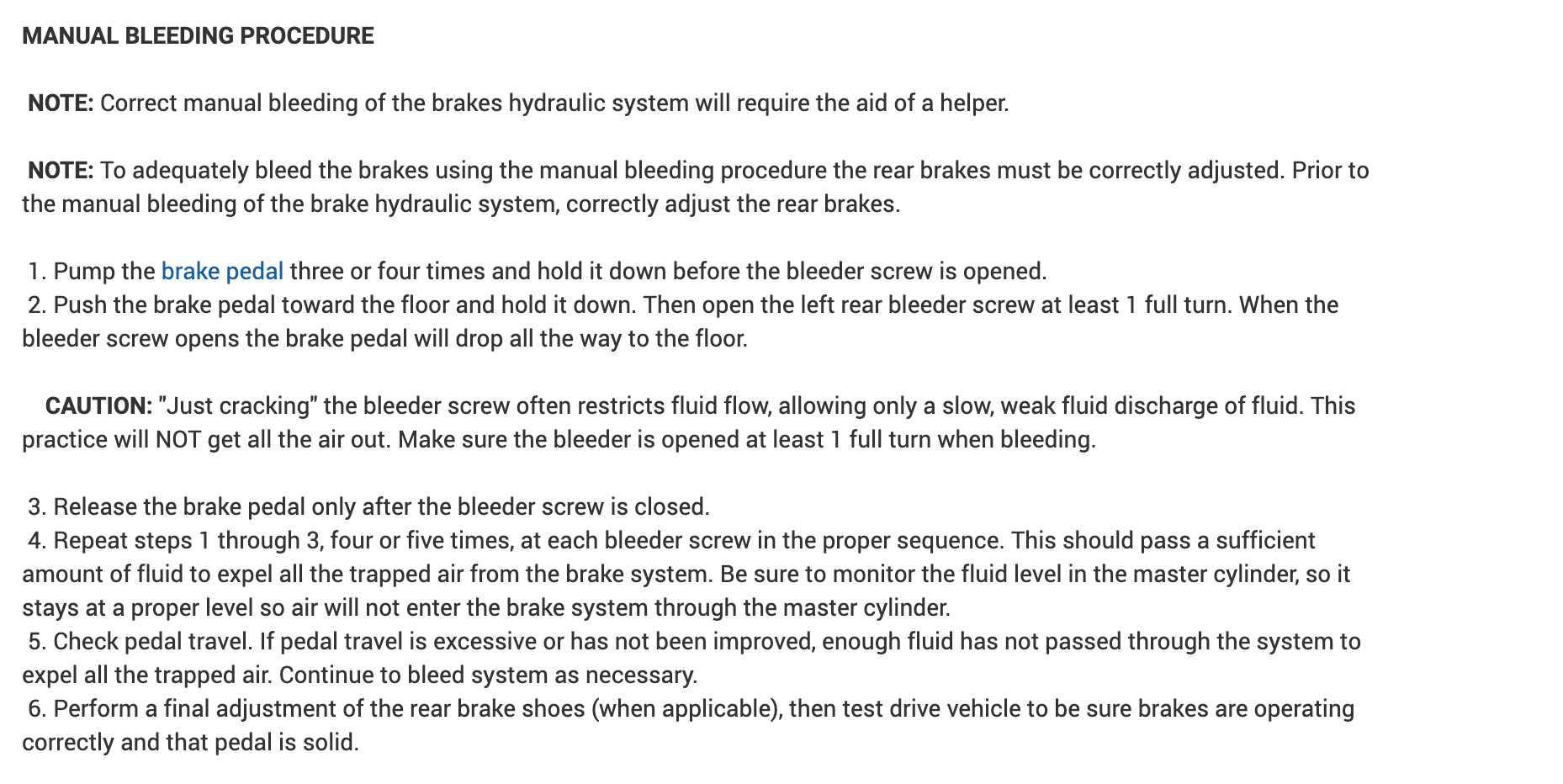

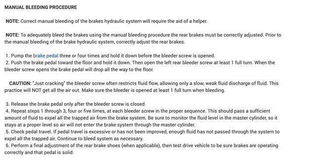

The best way would be with a pressure brake bleeder.
If you do not have one of these available then thoroughly manually bleeding will work just as well.
I have attached below a description of the manual brake bleeding process.
There is also a guide for brake pedal goes to the floor in the link below:
https://www.2carpros.com/articles/brake-pedal-goes-to-the-floor
Bleed the entire system until you have fresh clean fluid with no air at every corner.
If the problem persists make sure you have gone through the guide in the link.
