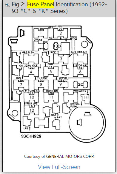

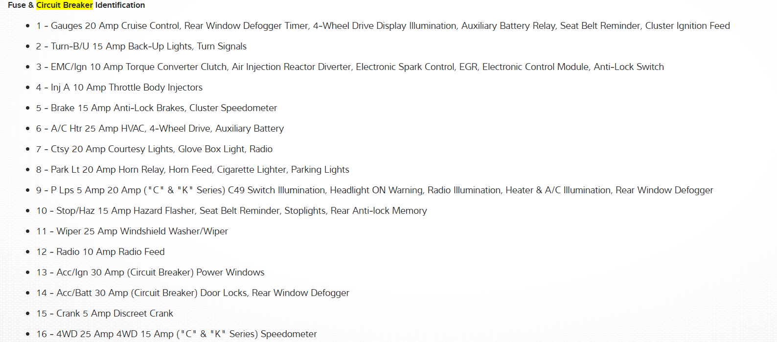

Brake lights do not work can you help me fix it?
Thursday, January 19th, 2017 AT 11:43 AM
3 Replies
HMAC300
MECHANIC
48,601 POSTS

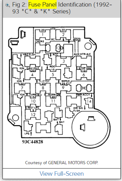

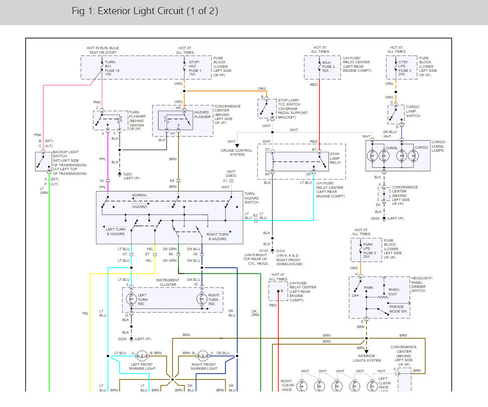

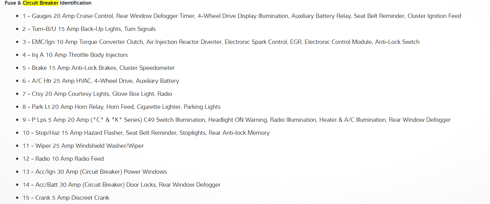

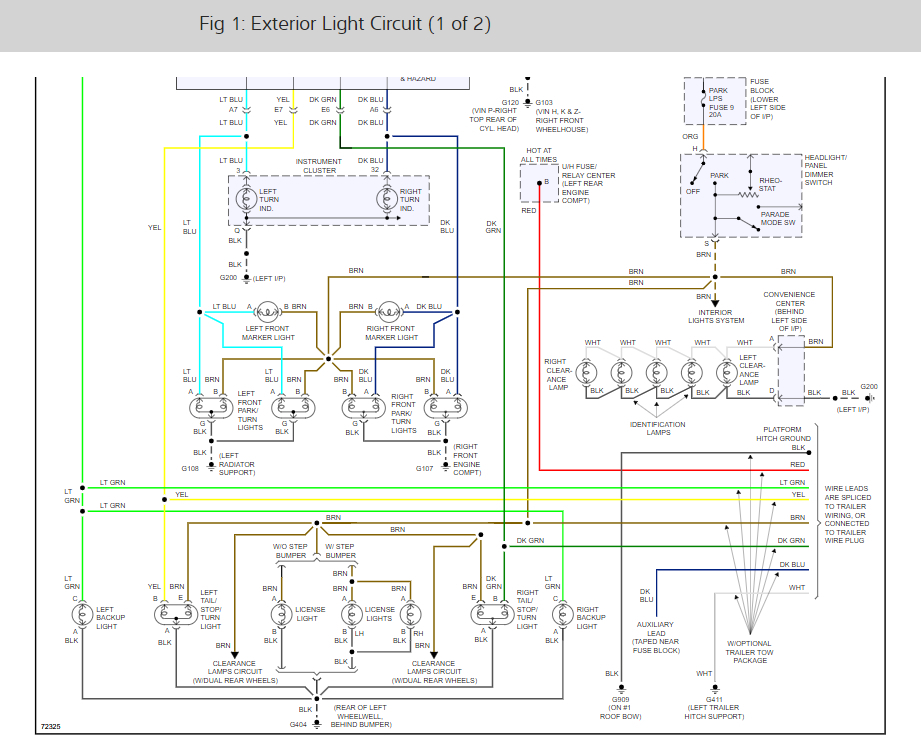

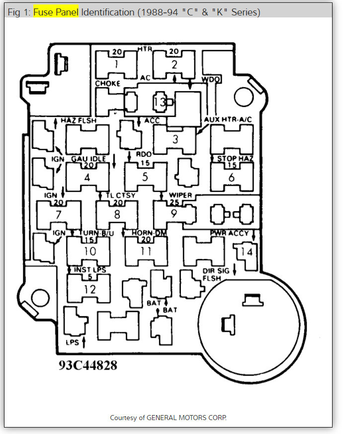

The brake light switch could be out which is common check out this guide to help you find it. lets check the fuses as well
https://www.2carpros.com/articles/brake-lights-not-working

The guide was great it was the brake light switch I got a new one and boom, they work again !
