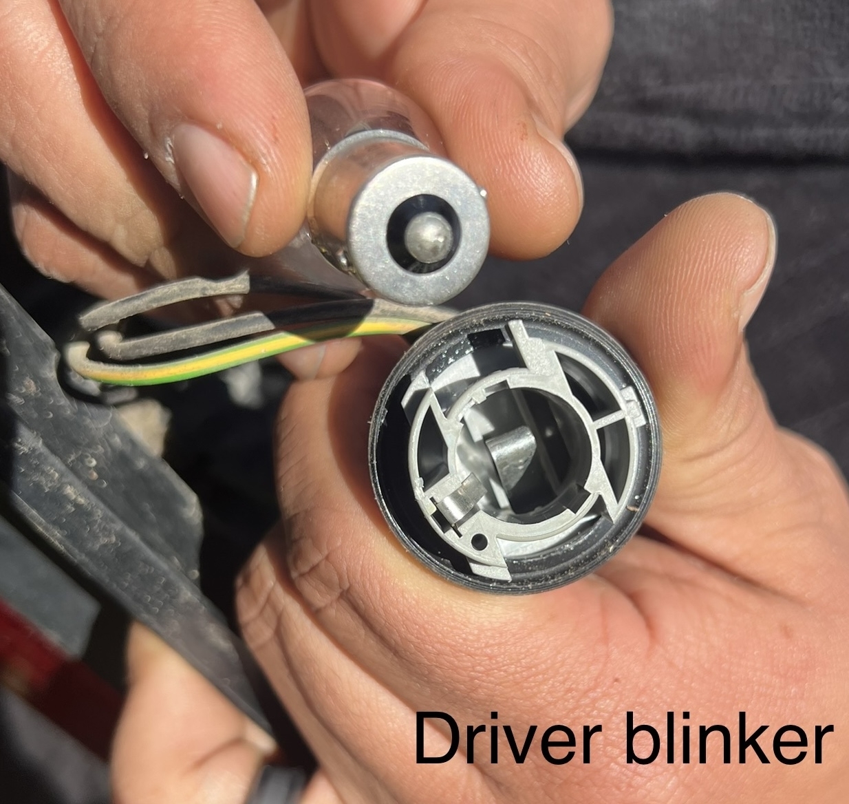

With key/car on, the brake lights would stay on. I replaced the brake switch at the pedal as well as the "stopper" on the pedal arm. Fixed this issue. However, when I turn on the running/parking lights the brake lights are also on. Whether the switch is to the running/parking lights or the headlights, whether I press the brake pedal or not, the brake lights are on. I have noticed before that when I do press the brake pedal, lights off, my running/parking lights come on as well.

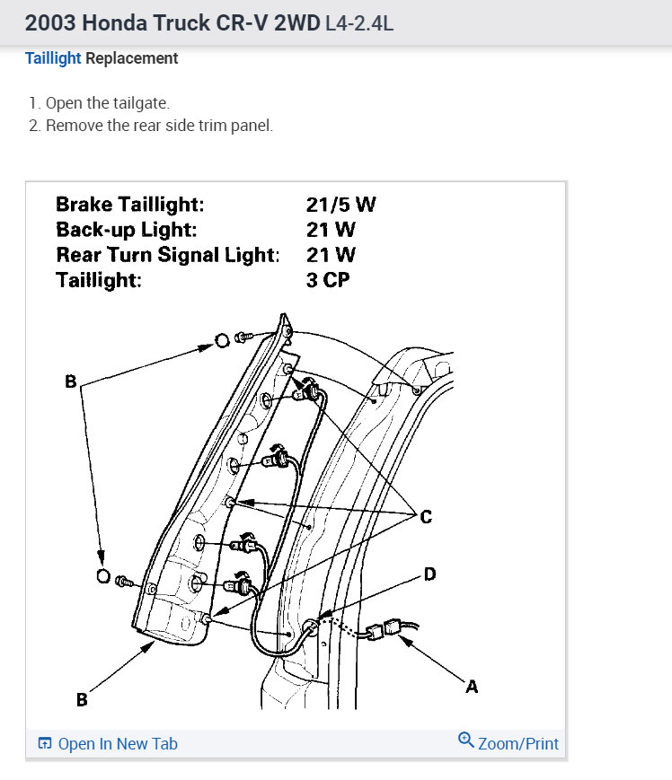

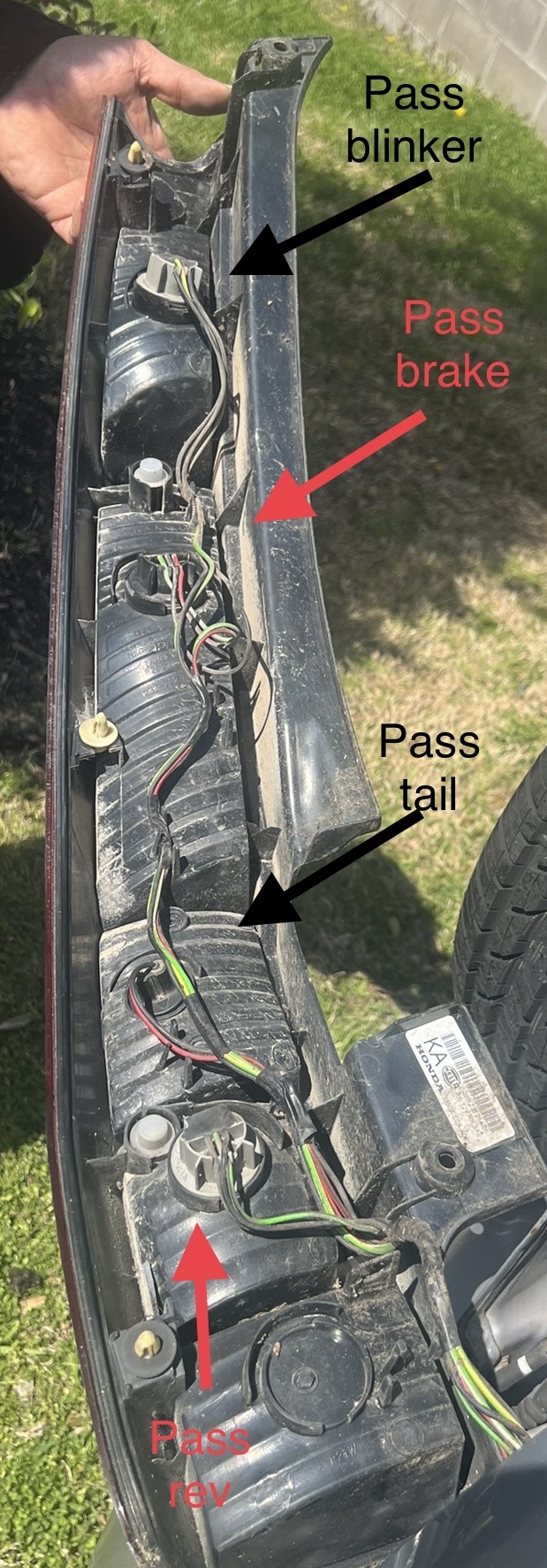

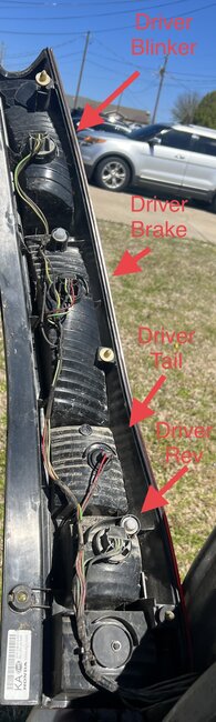

It sounds like one of your rear taillight bulbs or bulb sockets have shorted together back feeding the brake light circuit. I would remove the rear lens to inspect all bulbs and sockets to look for such a connection, here is what I am talking about and how to remove the rear lens in the images below.

Looked at all sockets and connections while I was replacing bulbs. I also thought maybe someone jumped taillight brake light but nothing was found.

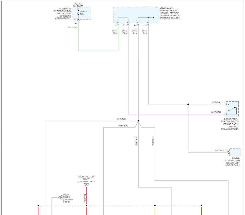

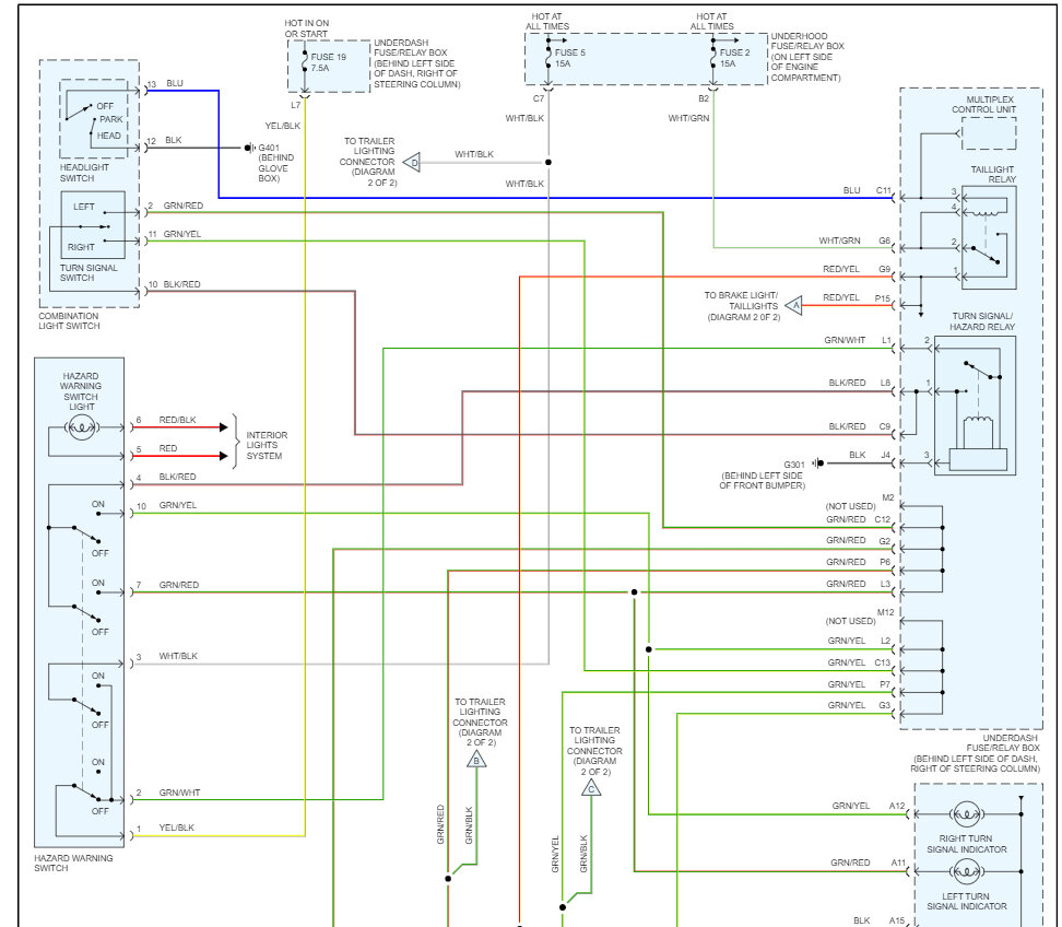

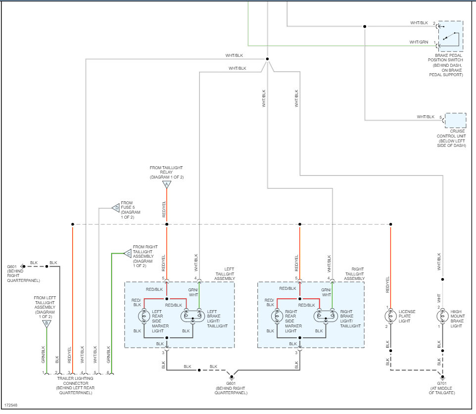

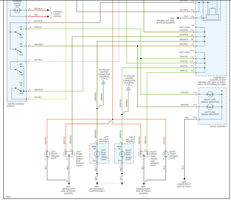

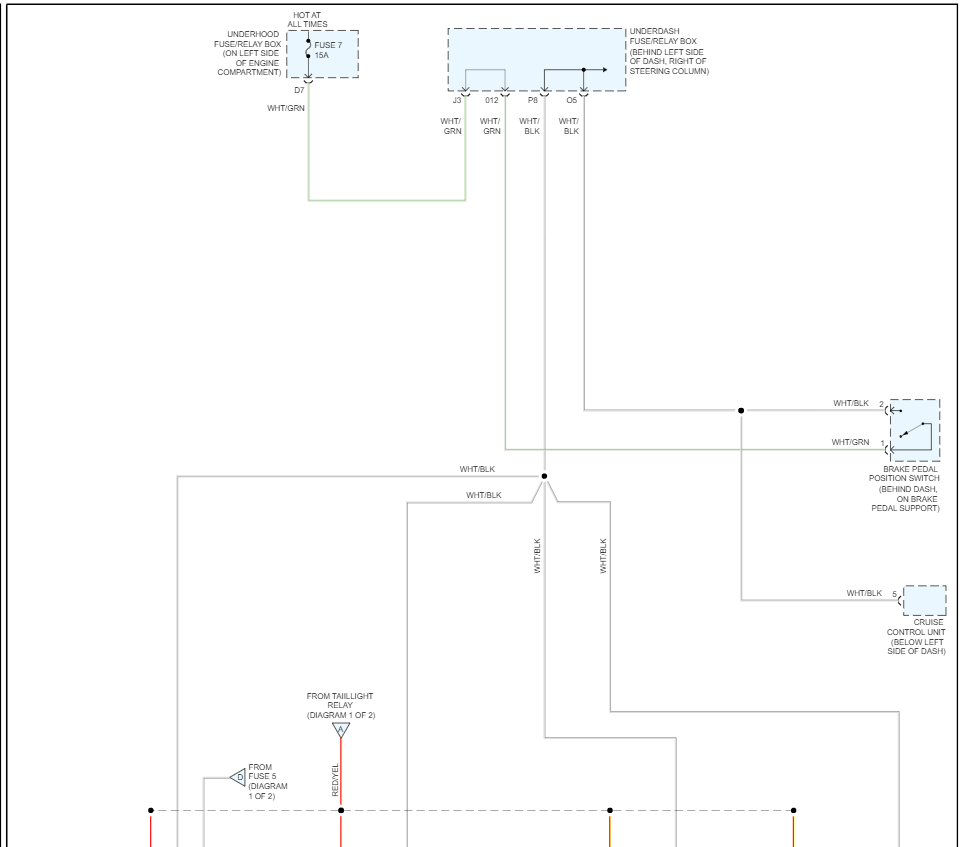

Is there a trailer wiring connector? If so, that is the next place, I would look to see if a connection is shorted together. Here are the taillight and brake light wiring diagrams so you can see how the system works.

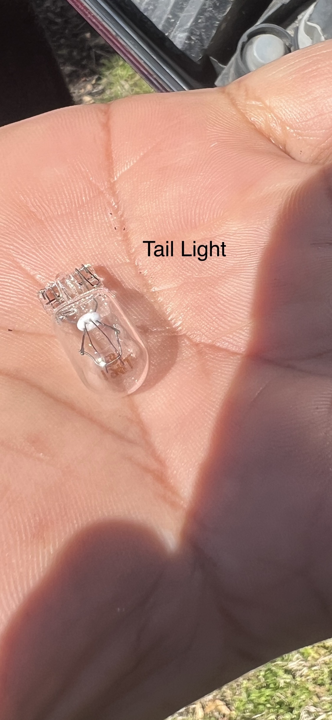

Can you confirm the brake light bulbs are the correct ones? They should have two connections at the bottom of the bulb, not one.
Wednesday, March 15th, 2023 AT 11:43 AM
REYREY2001
  • 13 POSTS

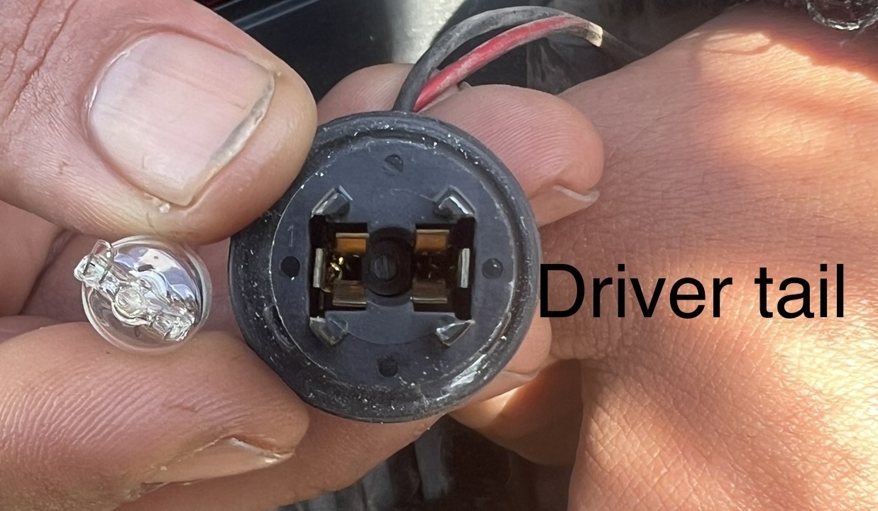

I do not recall the part number but I do know the rear blinkers and brake lights take the same bulb which is the standard traditional round bottom kind with a prong on each side. The rear taillights have a blade type connection.
Wednesday, March 15th, 2023 AT 1:45 PM
REYREY2001
  • 13 POSTS
Rear blinkers and brake lights twist into the socket. The rear taillights push in.

As you can see from the wiring diagrams the two-lighting system do not cross except at the bulb and socket. Can you remove both brake light bulb and inspect and upload a picture of the bottom of the bulb please? You may have a wiring loom that has shorted together as well so please inspect the wiring for damage.

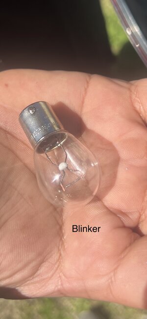

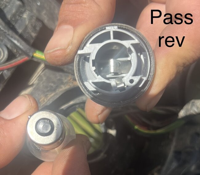

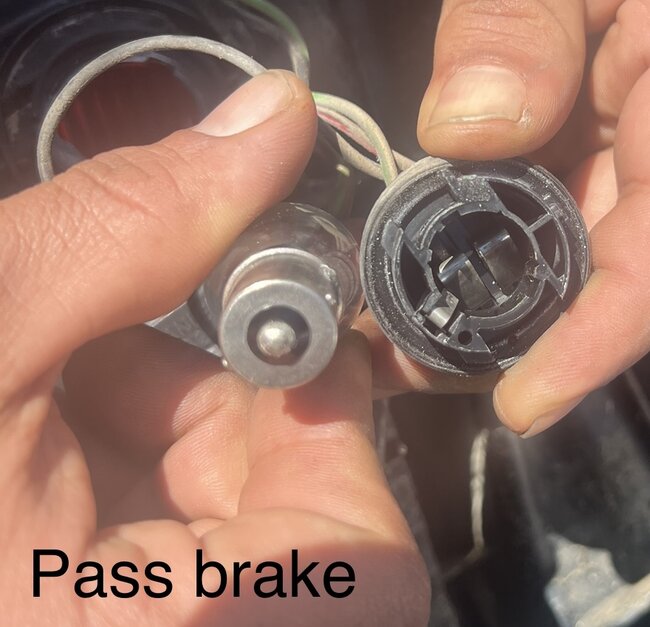

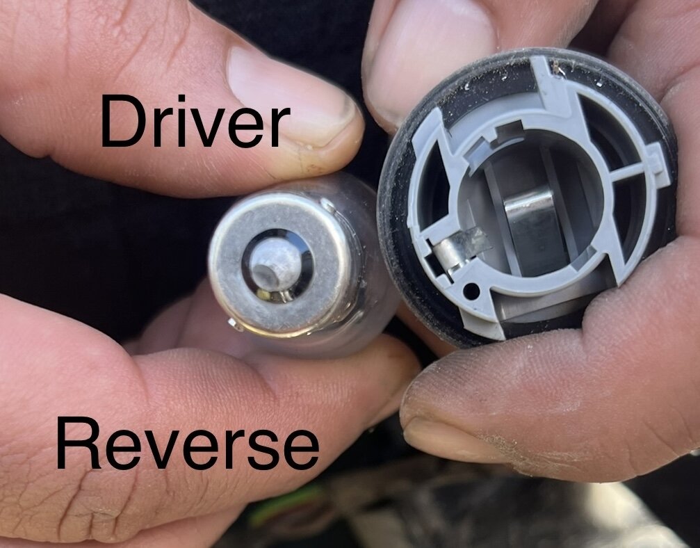

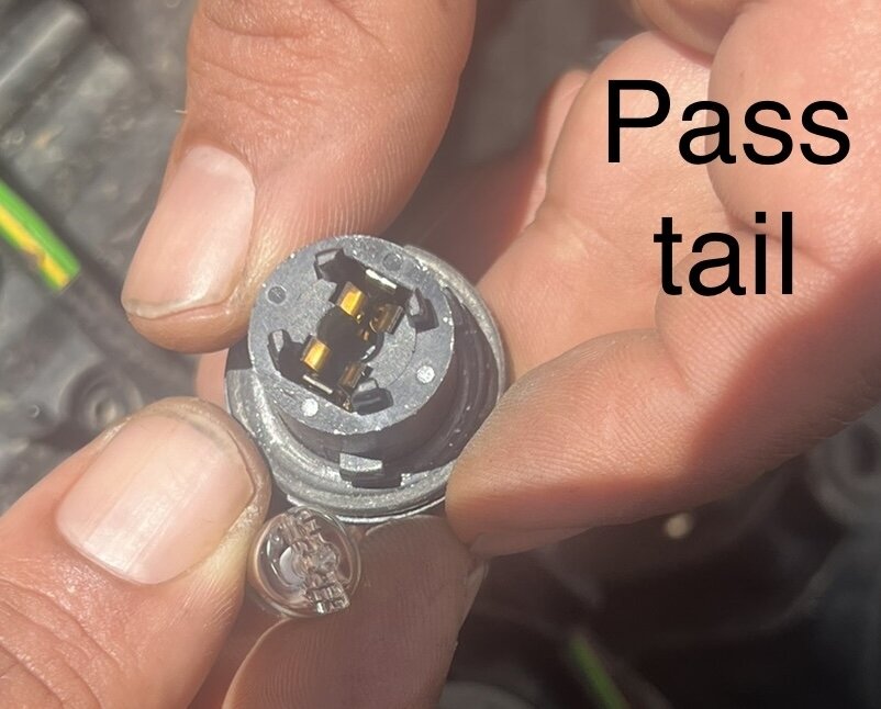

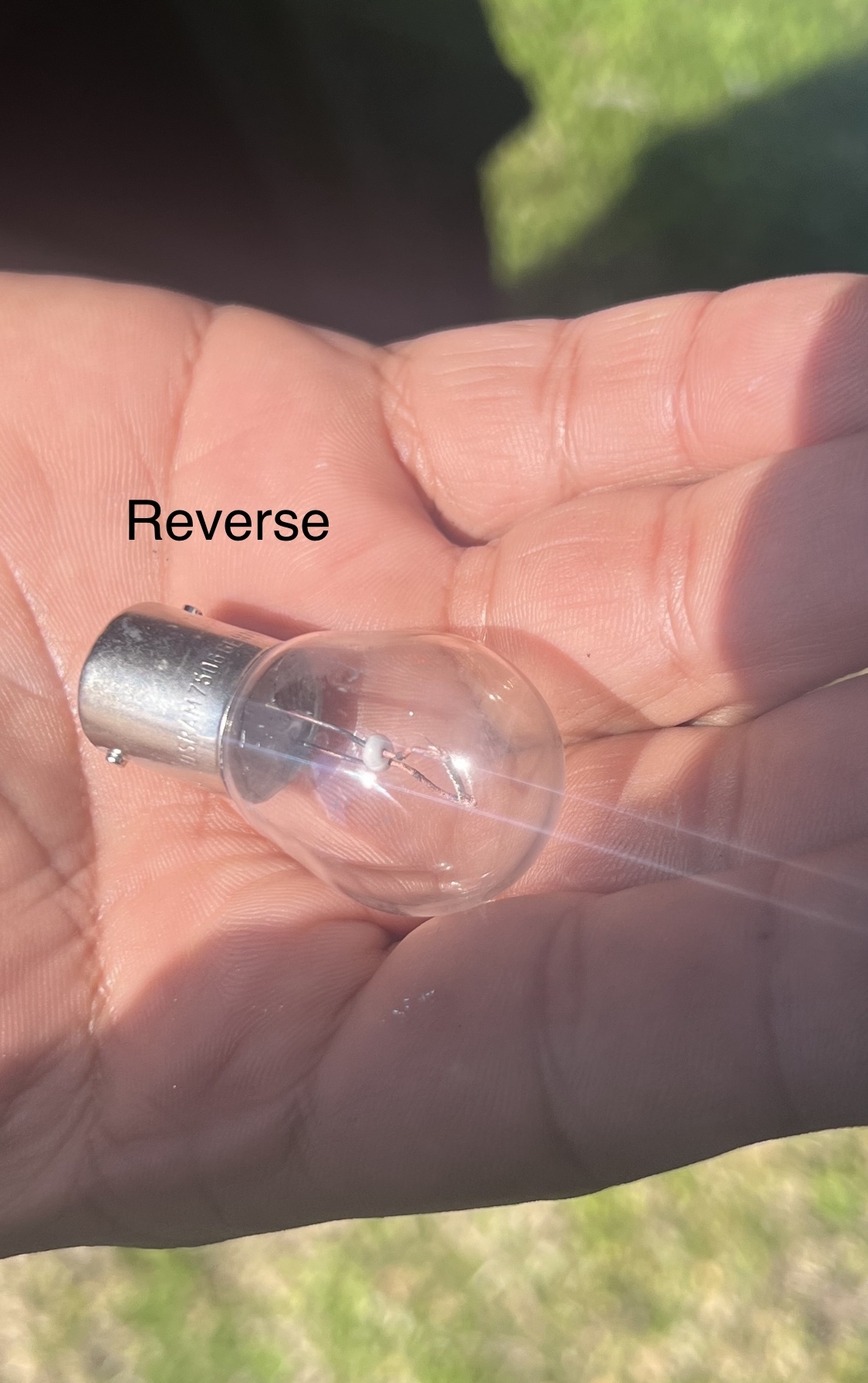

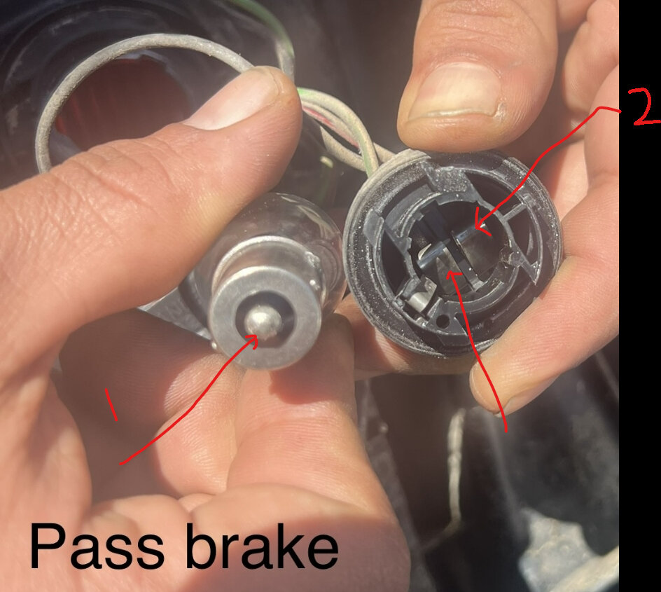

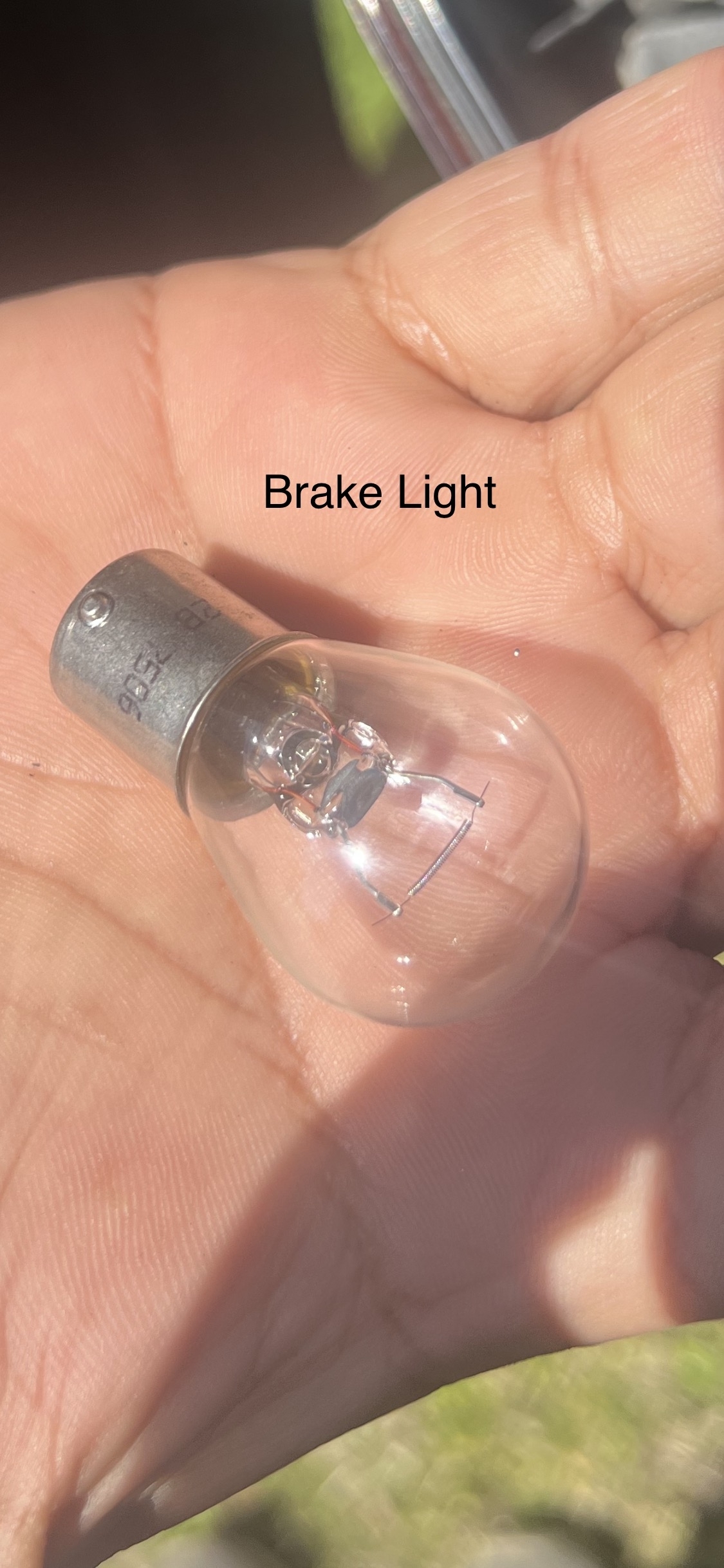

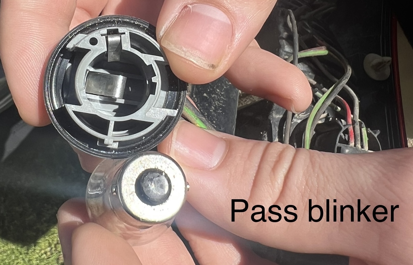

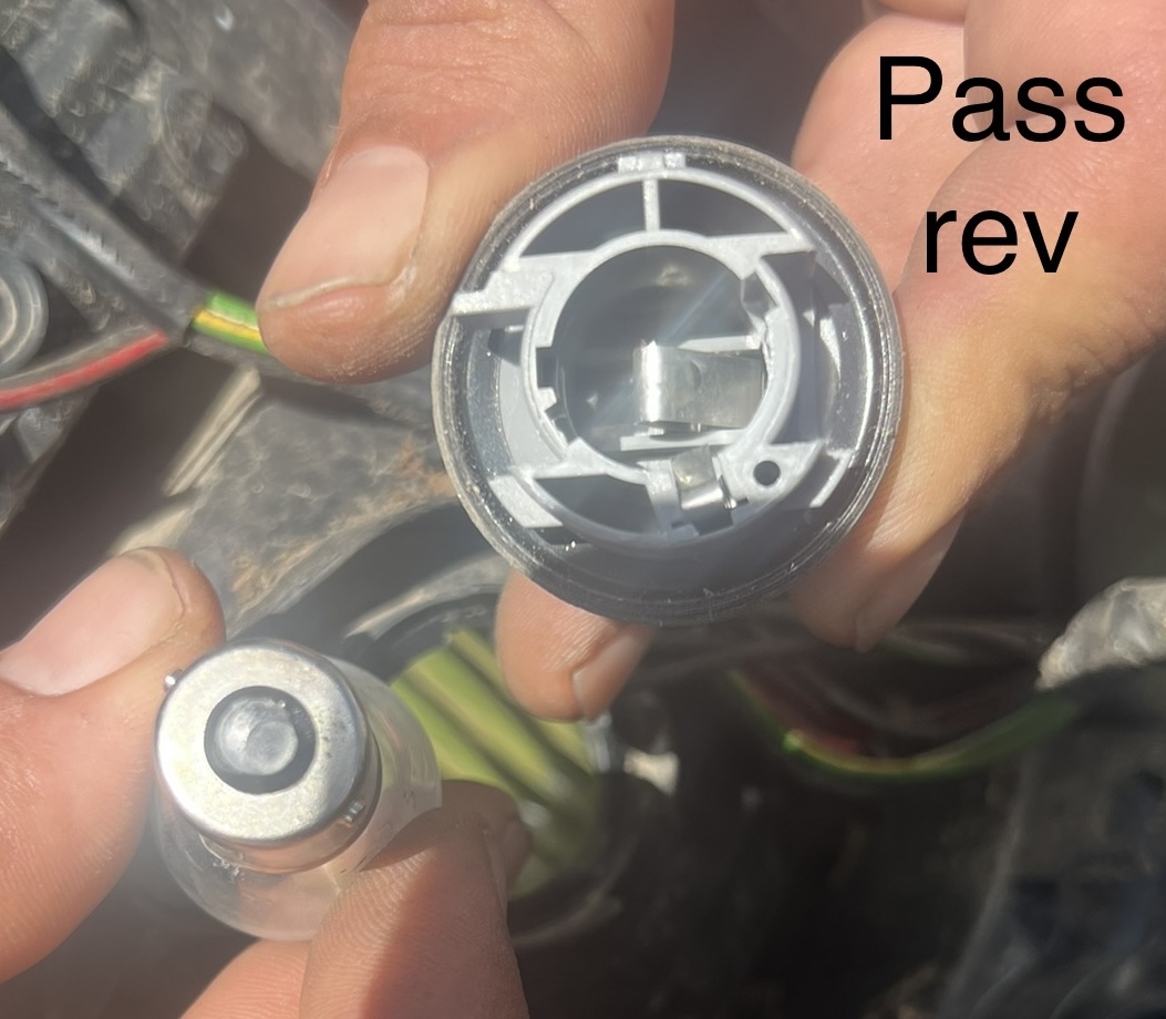

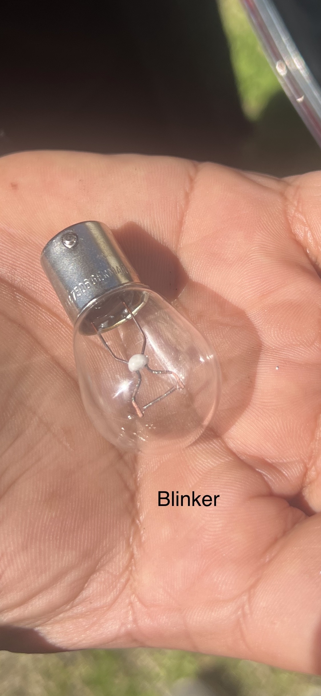

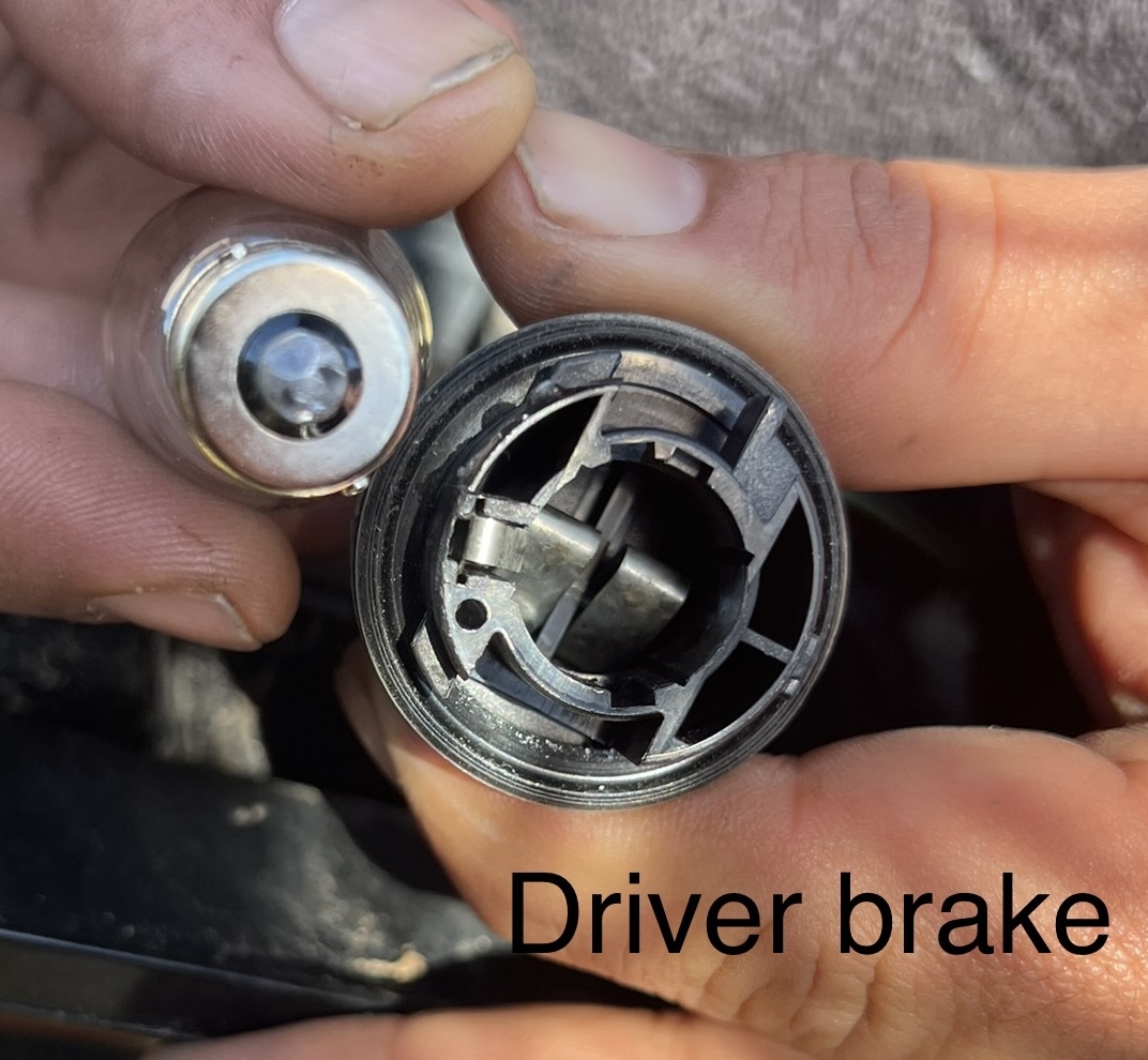

No problem, if you can upload the picture of the brake light/running light bulb (dual filament) that would be great.
Sunday, March 19th, 2023 AT 11:06 AM
REYREY2001
  • 13 POSTS
Driver's side.
Sunday, March 19th, 2023 AT 11:40 AM
REYREY2001
  • 13 POSTS
Passenger side.
Sunday, March 19th, 2023 AT 11:41 AM
REYREY2001
  • 13 POSTS
Bulbs
Sunday, March 19th, 2023 AT 11:42 AM
REYREY2001
  • 13 POSTS
Another way to rephrase my situation would be to say that my brake lights and my tail/running lights are tied together; switch (by steering wheel) and brake switch (at the brake pedal).
Sunday, March 19th, 2023 AT 11:48 AM
KEN L
  • MASTER CERTIFIED MECHANIC
  • 55,535 POSTS
Yep, you have found the problem, this socket has two terminals and you have a signal terminal bulb in it. Install the correct bulb and it should fix it.
+1
Monday, March 20th, 2023 AT 11:19 AM
REYREY2001
  • 13 POSTS
Wow! That was it! I asked the guy at the auto part store and I heard him mumble that I probably didn't have the Great Britain model and I said that I did. He then said they were 2 different style bulbs. You don't know how much I appreciate all your help! Thank you!
