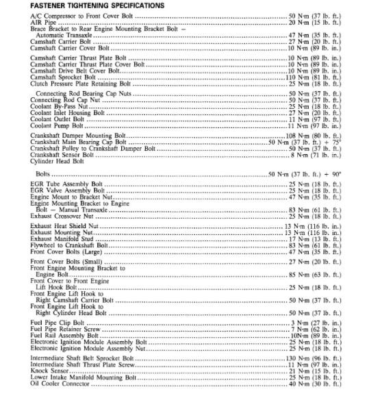

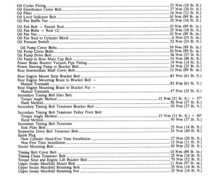

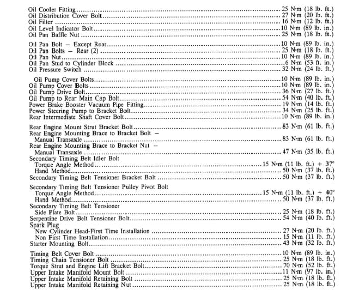

I need all the diagrams for the torque sequence and torque for the engine. I couldn’t find them anywhere on the Internet.

Good evening,
I attached the torque specs for you of the 3.4 engine you have.
Let me know if you have any other questions. Check out the diagrams (Below). Please let us know if you need anything else to get the problem fixed.
