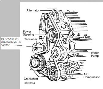

I want to update you on the situation, I have a 3.1 liter not a 3.4 liter, please let me know what to do as to take out alternator on a 3.1 liter chevy lumina and also how to loosen belt and where the tensioner is
Thursday, November 12th, 2009 AT 4:43 PM
JDL
  • 16,098 POSTS

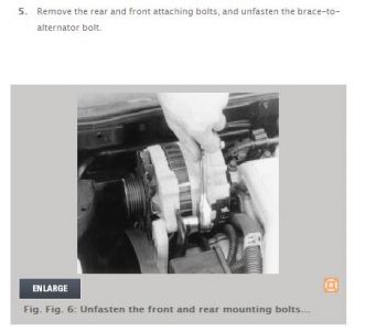

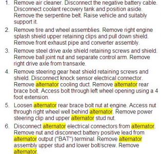

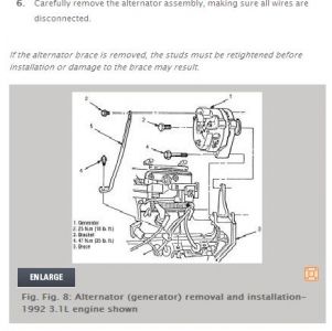

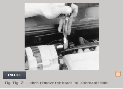

https://www.2carpros.com/forum/automotive_pictures/170934_lumina_alternator_1.jpg
Our database showed the above for the 3.1. The cavity that the line is pointing to, I believe 3/8s, you'll have to double check the size. Use a rachet drive or breakover in the cavity, pull counter clockwise, to take tension off the belt, then slip the belt off the alternator pulley. Take the negative battery cable loose, first.
https://www.2carpros.com/forum/automotive_pictures/170934_lumina_alternator_1_1.jpg
https://www.2carpros.com/forum/automotive_pictures/170934_lumina_alternator_2_1.jpg
https://www.2carpros.com/forum/automotive_pictures/170934_lumina_alternator_3_1.jpg
https://www.2carpros.com/forum/automotive_pictures/170934_lumina_alternator_4_1.jpg
In order to save space, this info covers several years, use the info that applies. Also, where applicable, that bracket for the alternator, I remove the bracket with the alternator. It just depends on what is easiest for you.
