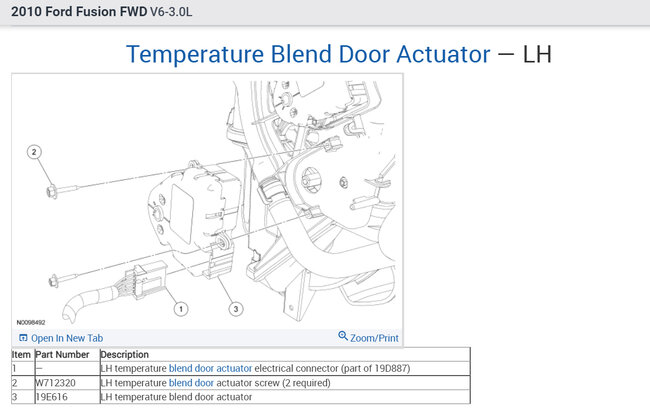

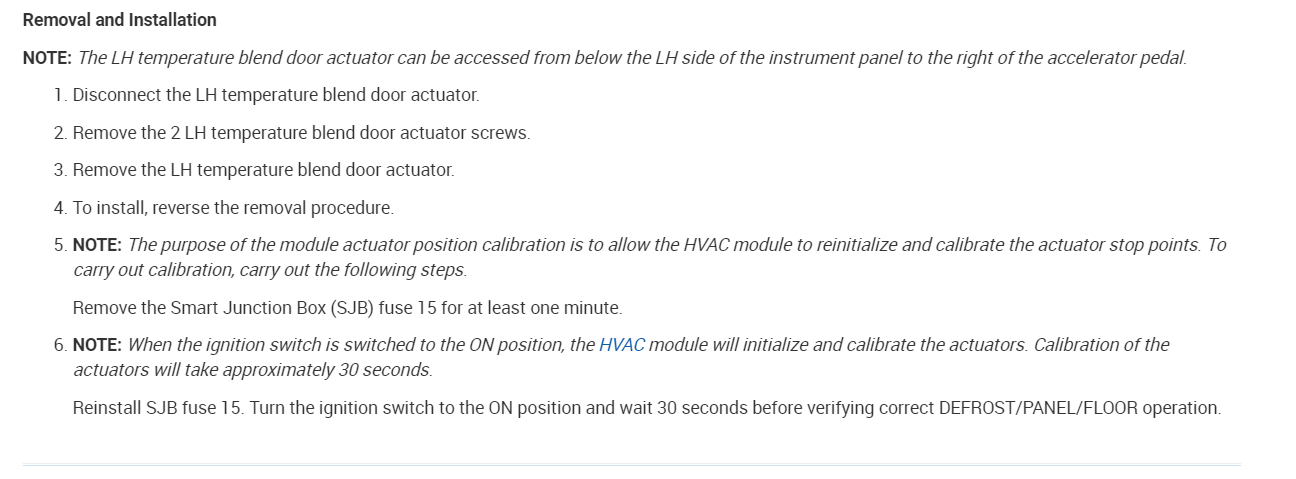

Hello, my daughter's car listed above S single zone climate control is behaving badly. In the summer the HVAC comes on and runs properly, but the air entering the cabin is not really that cool. In the winter the coolant lines to the firewall are hot but the cabin air blowing in is barely warm. And in all instances the air blowing in defaults to defrost vents.

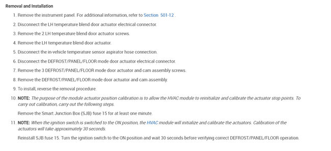

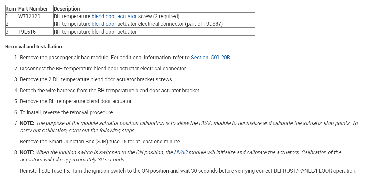

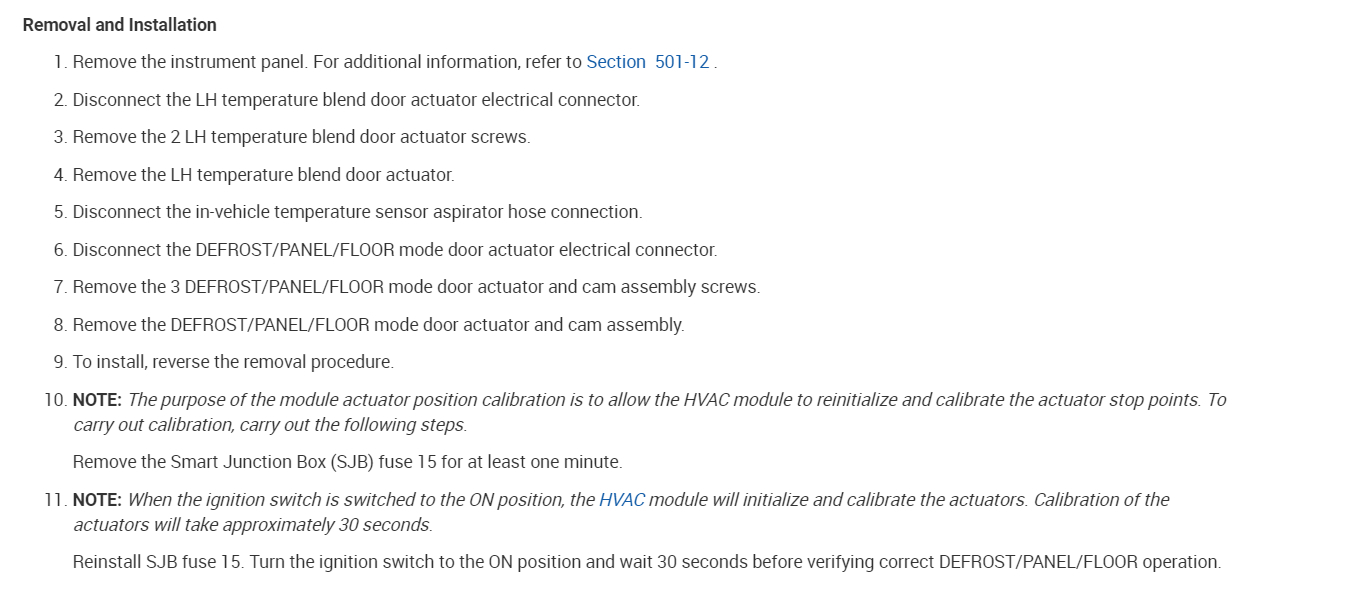

I replaced the blend door actuator and can observe both the mode and blend door actuators turning and cycling through their positions when resetting the climate control (pull fuse 15, turn to "on", then replace fuse 15).
I also picked up a climate control module at the junk yard and swapped it with the existing one, no change. I suppose that one could have been bad, so I put the original back in. It's like the actuators work but are not receiving signal when the temperature or mode options are changed on the module.

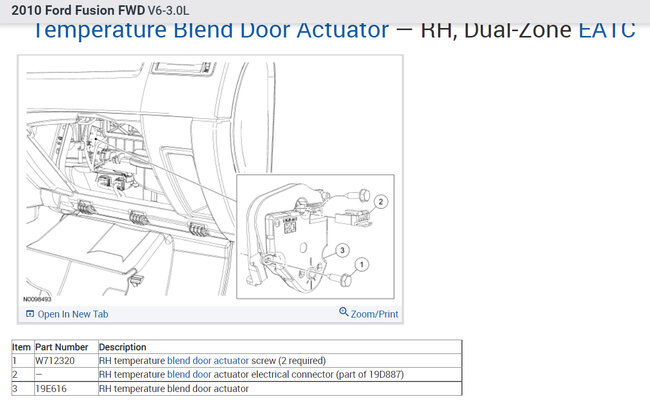

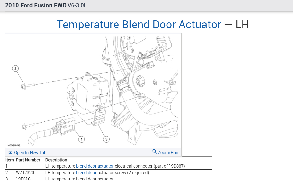

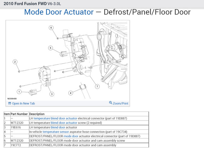

Okay, just to be sure you were replacing the correct blend door actuator I have included the actuators and what they do in the images below please confirm the actuator you have replaced. Check out the images (below). Let us know what happens and please upload pictures or videos of the problem.
Tuesday, December 27th, 2022 AT 5:17 PM
BLUESMAN62
  • 8 POSTS
Hi Ken. Yes, I replaced object 3 in the diagram, the blend door actuator. Like I said, I can see the blend and mode actuator cams rotate during the recalibration process, but then neither actuator responds to changes in temp or mode from the dashboard control module.

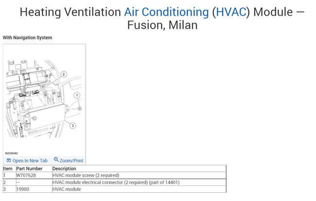

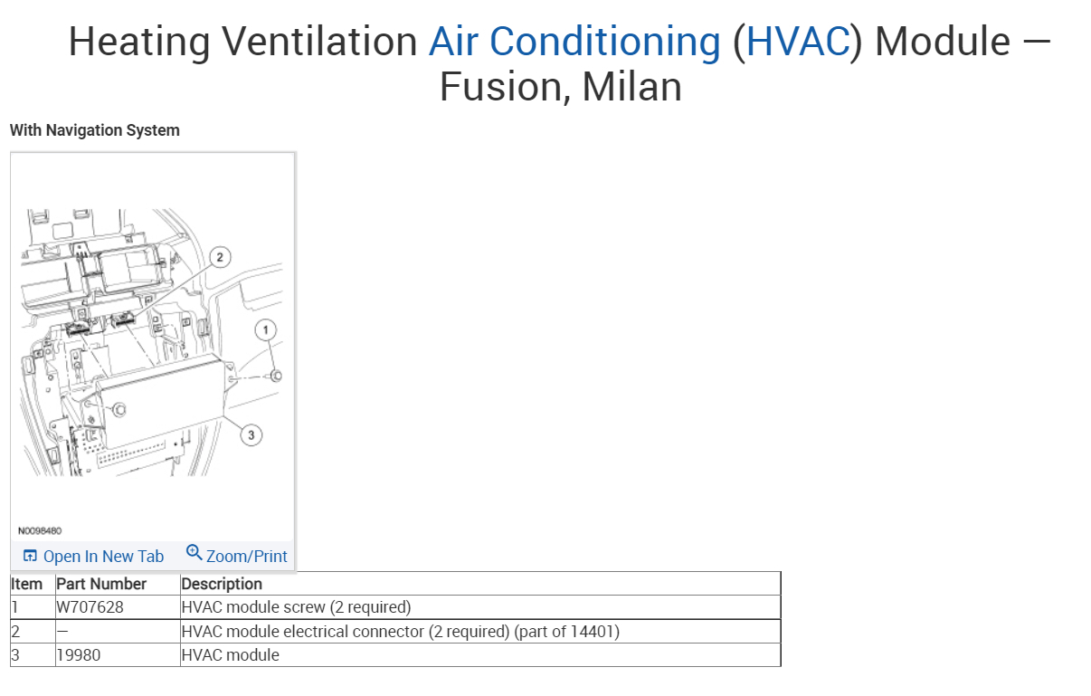

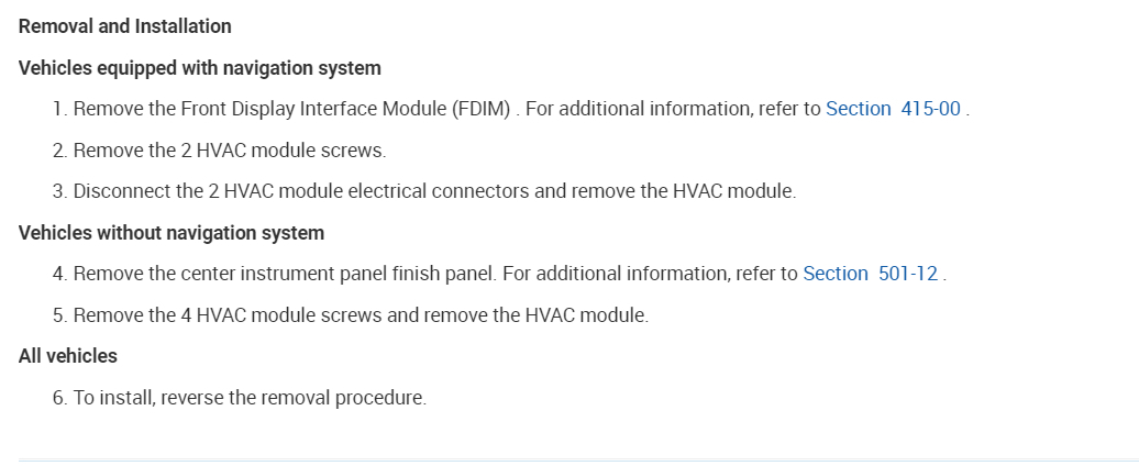

It sounds like the HVAC control head is bad, but to be sure we should do a CAN scan. You can get a CAN scanner (Controller Area Network) from Amazon from about $32.00.
https://youtu.be/u-4syLc-ifQ
and

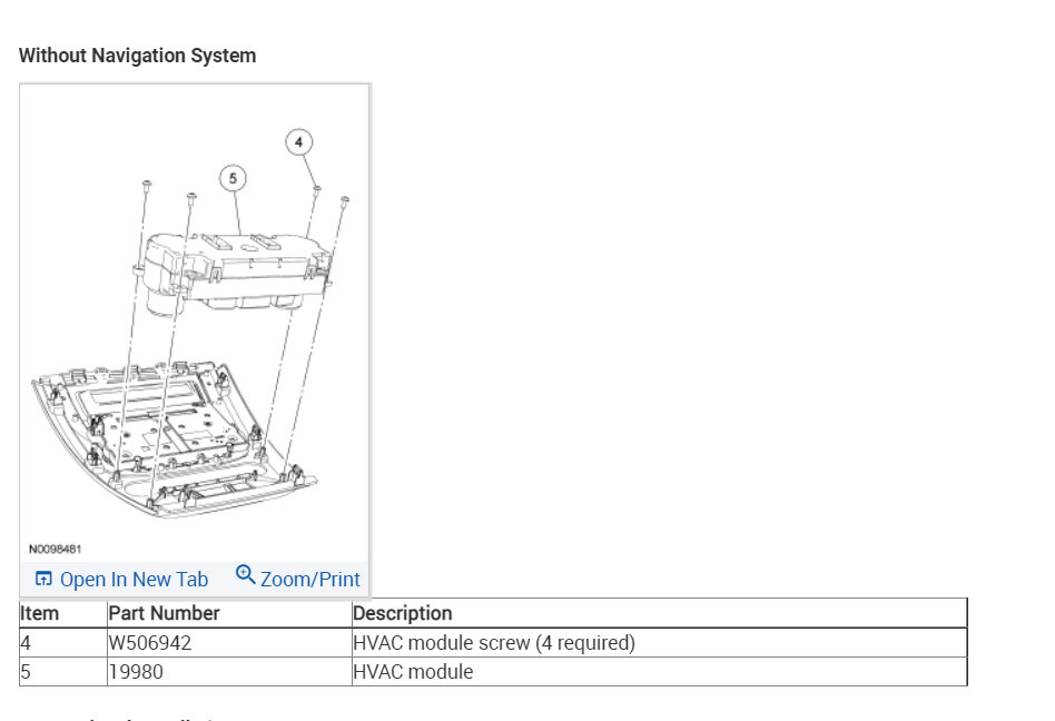

Here is how to replace the unit in the images below in case you need it. Check out the images (below). Please let us know what you find.

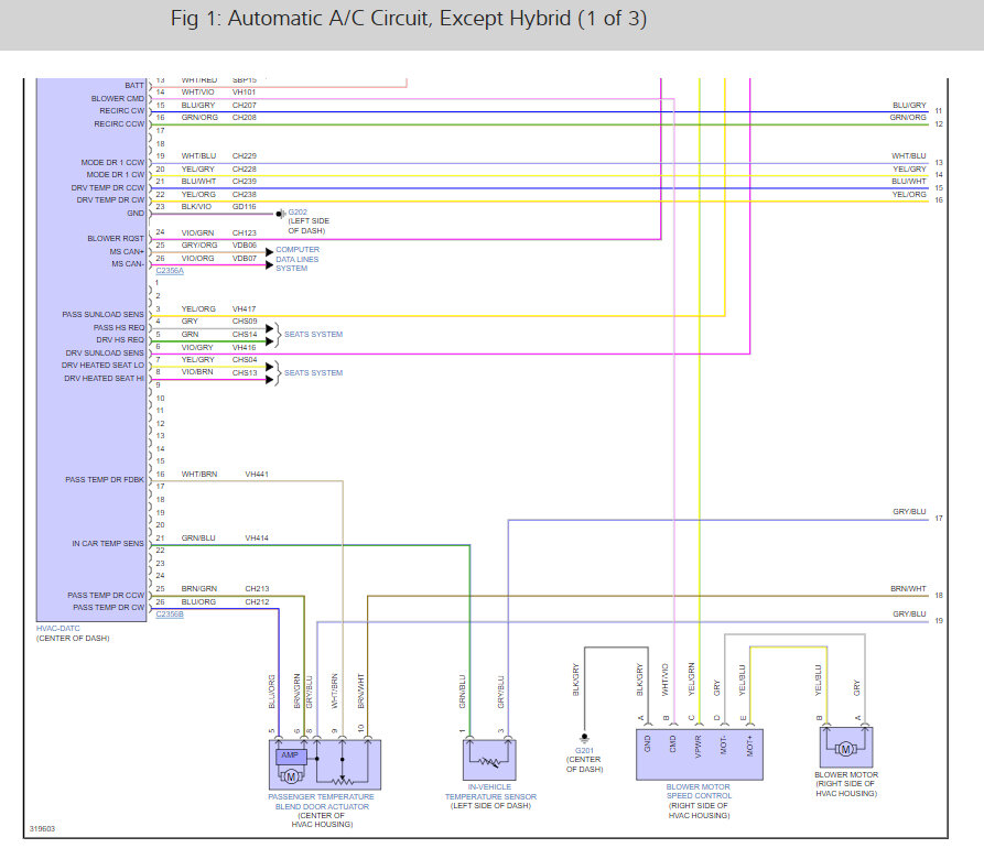

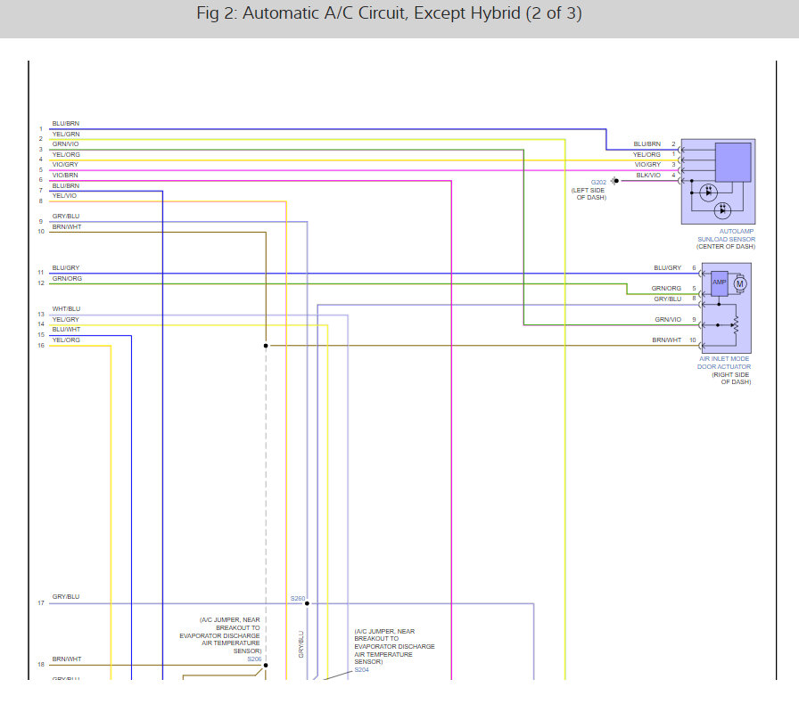

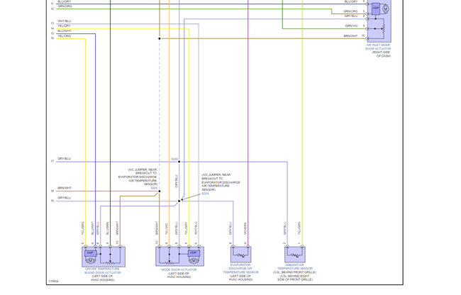

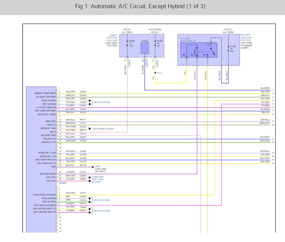

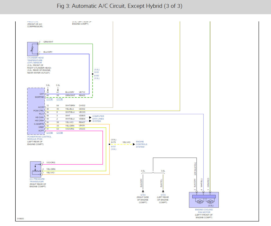

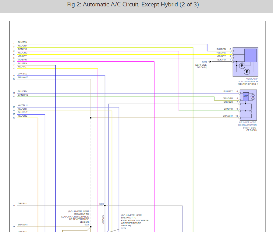

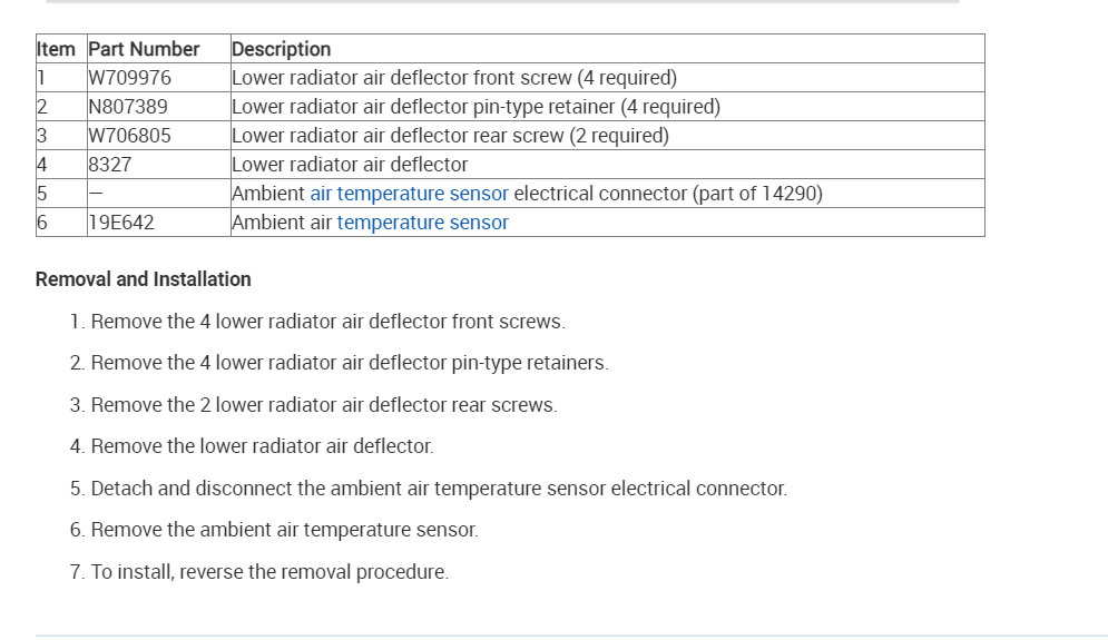

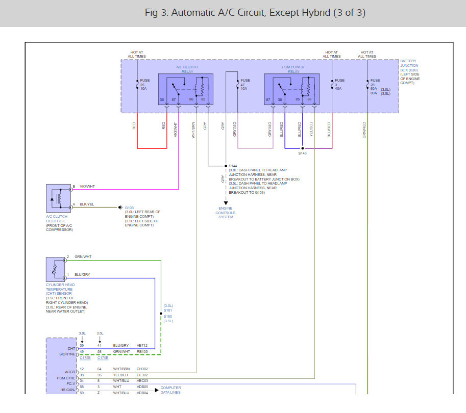

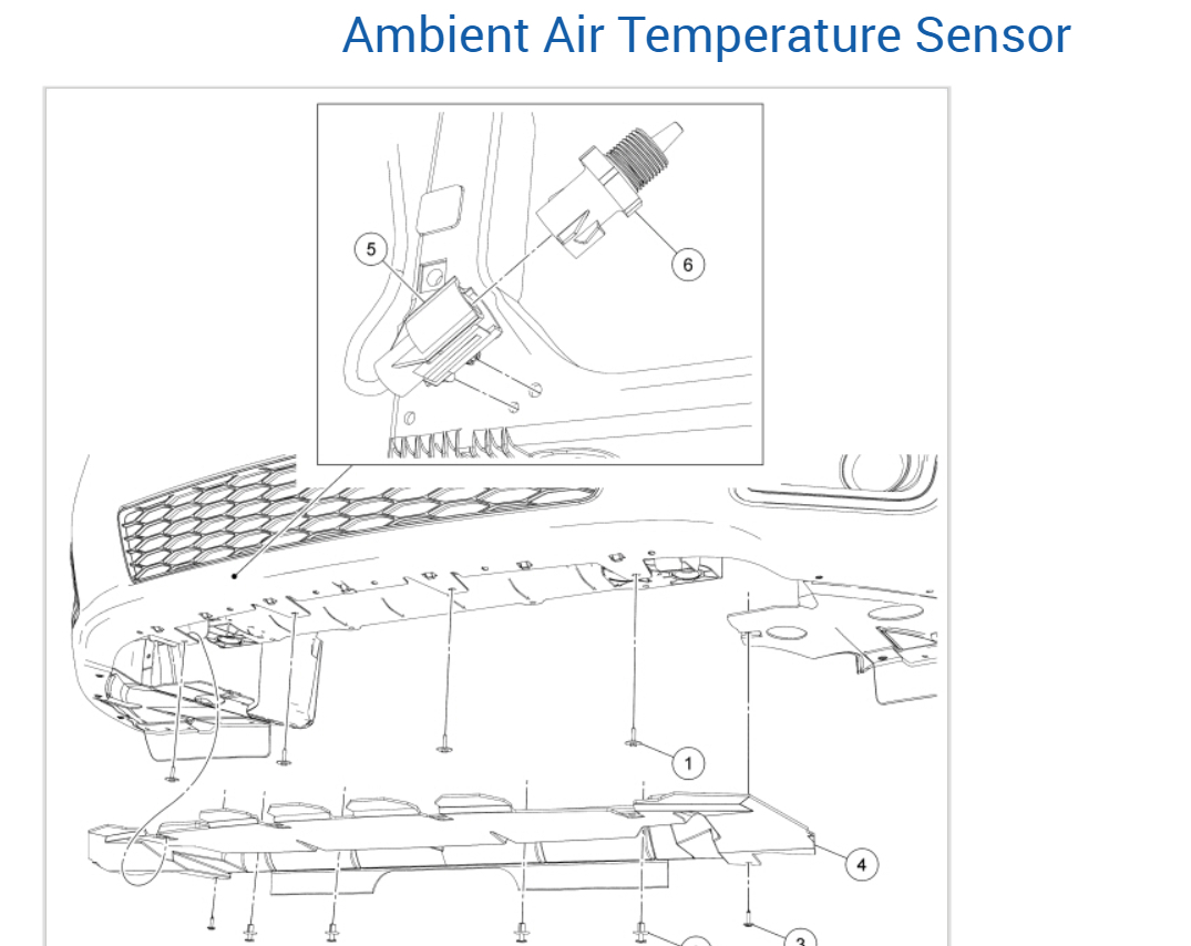

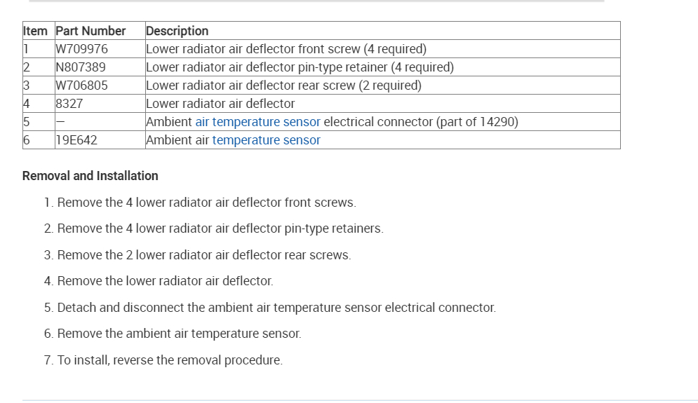

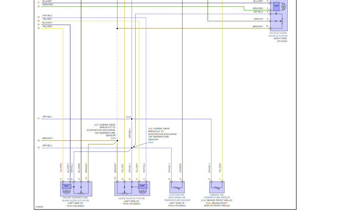

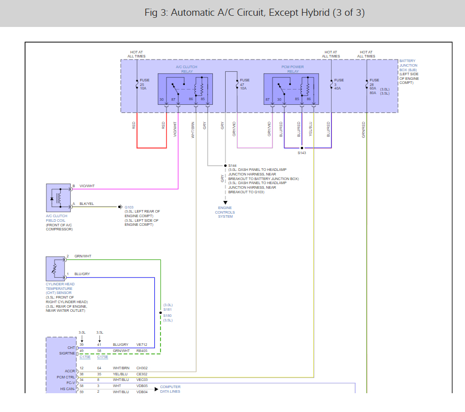

Can you unplug the ambient air temperature sensor to see if that changes anything? The BCM is not in the system, but the PCM is. Here are the HVAC wiring diagrams so you can check it out and see how the system works. Also, I have included the sensor location as well. If the sensor is shorted to full cold or full hot it might cause the system not to change. You say replaced the control head already, correct?
Monday, January 23rd, 2023 AT 11:51 AM
BLUESMAN62
  • 8 POSTS
Yes, replaced the climate control module with a Dorman reman from Rock Auto. I pulled the ambient air sensor per your suggestion, no change. Mode door defaulting on defrost, blend door defaulting somewhere between hot and cold. As an FYI, on this Fusion S Ford put the ambient air sensor on a support frame at the upper left in front of the radiator. Accessed from above.
Thanks for the diagrams, but testing those circuits is beyond my skills. Any other suggestions?
