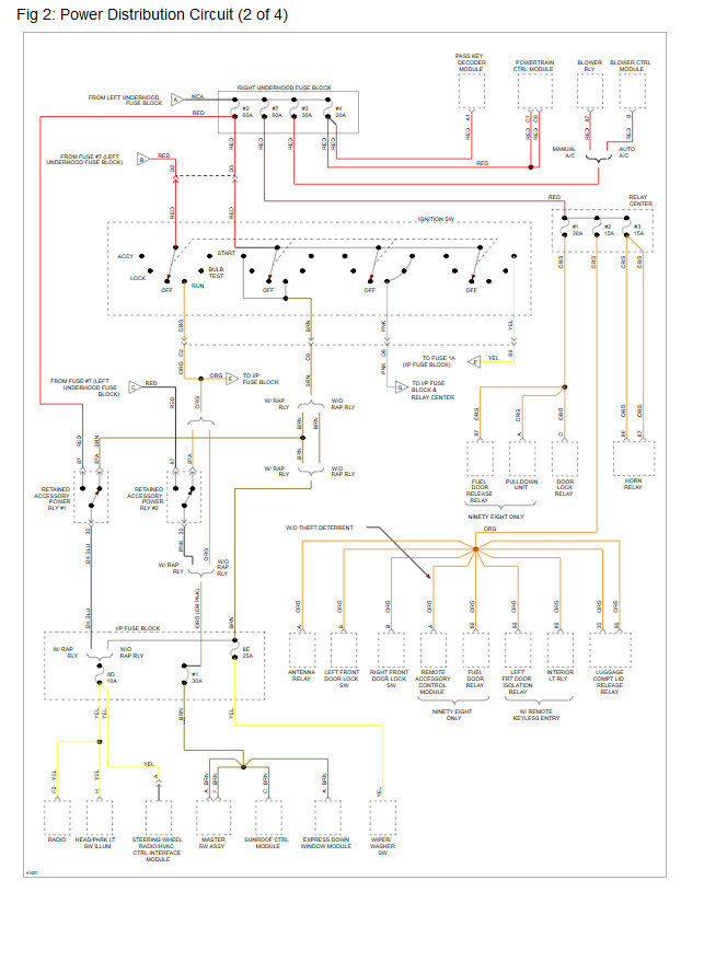

I have a parasitic drain. I have tested using a test light and pulling fuse by fuse until I found the one that turned off the light. It is the 20 amp master fuse that powers PCM/VATS circuit. Question is: with the ignition off is there supposed to be any power going to that fuse? As soon as I plug it back in I can hear the throttle body recirculate.

That fuse only goes two places. The PCM and the Passkey decoder module. The problem is that the PCM in turn powers other things and there is no way to know the inside circuitry to isolate what it powers.
You have to try unplugging these things to figure out which one it is.
Monday, January 16th, 2017 AT 4:05 PM
WRENCHTECH
  • 20,761 POSTS
Here is the wiring diagram.
Monday, January 16th, 2017 AT 4:09 PM
