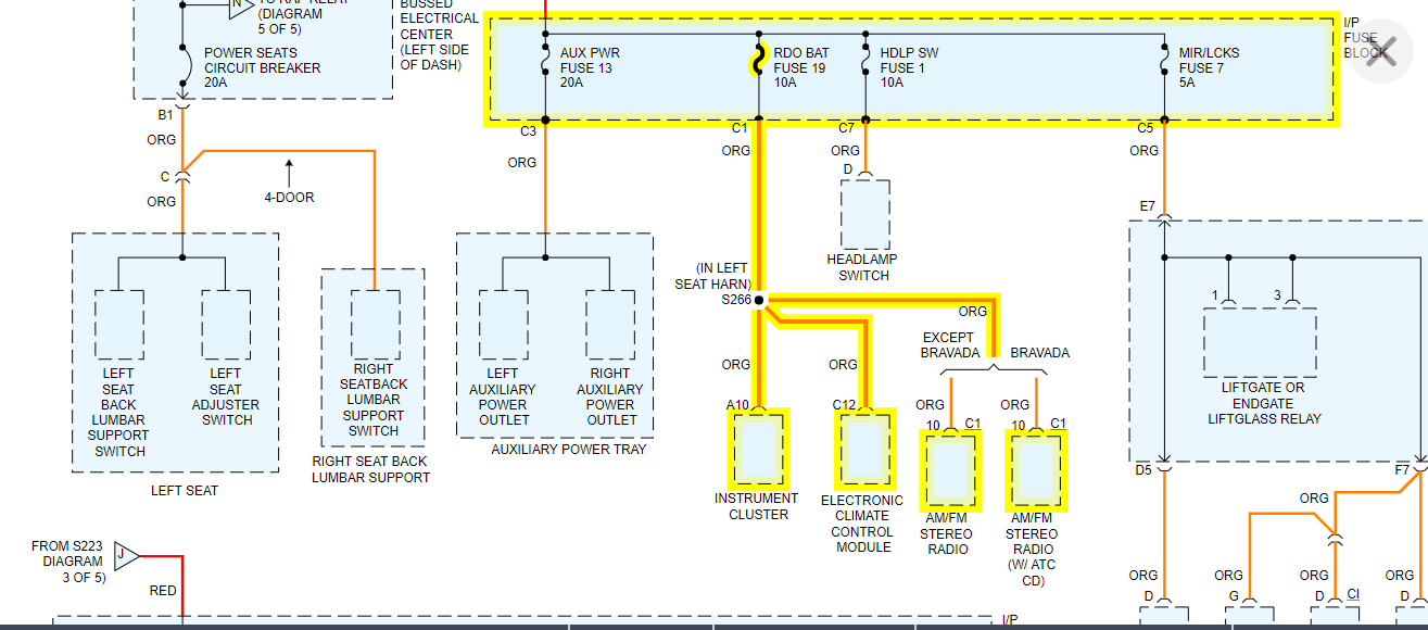

I attached the diagram of what is on the circuit.
Still waiting on an answer on the draw after the fuse is removed.

With the fuse removed there is no current flow in that leg. With the fuse in and the radio removed there is the 470 mil flow. This would indicate there is something in the instrument cluster drawing this phantom current. Stupid question, where is the control for the instrument cluster or do I have to remove the entire cluster? Right now the dashboard is open due to having removed the radio. I am thinking about just putting a switch in to control the power to the instrument cluster and putting the radio constant 12v on another ckt. What do you think?
Oh, what is "in left seat harn" at junction "s266"? I had not thought of this being the problem.

First, you check the draw at the battery with the negative cable removed. Insert the amp in line with the cable and battery. You do not check at the fuse.
You need to disconnect the components one at a time until the draw drops to 50-75 milliamps. If you disconnect it all and there is still a draw, then you have a wiring issue.

Roy, I have done all of that and narrowed it down to fuse 19 which feeds the RDO/Batt ckt. I have disconnected the radio and there was an aftermarket CD player on that ckt and I have disconnected that. This confuses me for the past 20 years everything has worked fine and then one mysterious night I had a dead battery. I replaced the battery and that did not solve the problem, then I replaced the alternator for this was causing the digital odometer and trip indicator along with the radio freq indicator and clock to have what I call a twinkling of the display. I had the same thing in a Caravan and replacing the alternator solved the twinking problem but the battery still drained overnight. I started investigating by removing the battery cable and check the ignition off state and saw the 470 mill current draw and by checking each fuse ckt I came down to fuse 19. Removing the radio and an associated CD player did not solve the problem. Now looking at the wiring diagram you sent, the only thing left is the hook up to the instrument cluster and "front seat harn". What is this front seat harn and can it be disconnected? I guess I will look under the seat and see if there is a connector. I know there must be a connector to a sensor that senses when the seat belt is engaged. And I will look for that.

The cluster and the HVAC controls are the other 2 on that circuit.
Where did you see this seat harness?

My bad, I was interpreting the diagram incorrectly. This might be a location definition for junction 266 showing all items are in the "left seat harness" where ever that might be. My climate control is the old fashoned knob adjust not electronic control. I have eliminated the radio so this leaves the instrument cluster. I would assume this has an electronic control for all and I guess this would be IN the instrument panel. I will look into how this is connected at least there is no flexible cable going up to the speedometer to disconnect.

Do not dismiss the control head for the AC. Disconnect that as well.

It is the label S266 in your diagram in the vertical line between the fuse and the instrument cluster. Oh, I will definately go and check the AC Control Head. Thanks,
